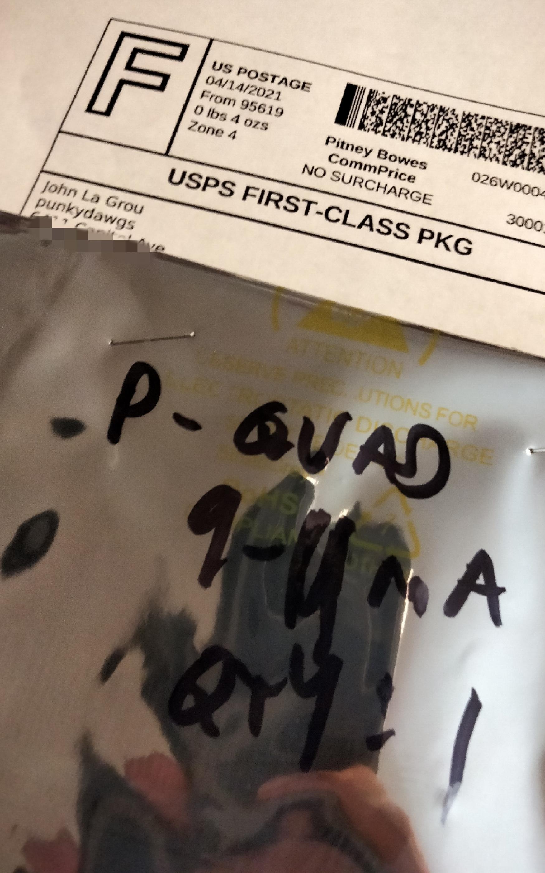

Benefits of living in first world.
Mine was shipped on 9 April. I am still waiting. And will probably wait for 2 more months. Our local postal service is horrible, such that Amazon now refuses shipments here using local postal service, only allowing for tracked courier services.

For an Aleph J you do not need any K170 junction FETs. No Octet needed. Only J74s: either NOS Toshiba devices or new production, Linear Systems devices (available in the diyAudioStore).
As MZM said, two pairs; within pairs, matched. Ideally, all four J74s matched, as Mr. Peppennino showed in his post, received from Ebay seller punkydawgs.

LSJ74 / LSK170 ± 0.1mA Matched Octet (Grade B) . Right? 😕
No, 74 matched quartet. Ciao :
