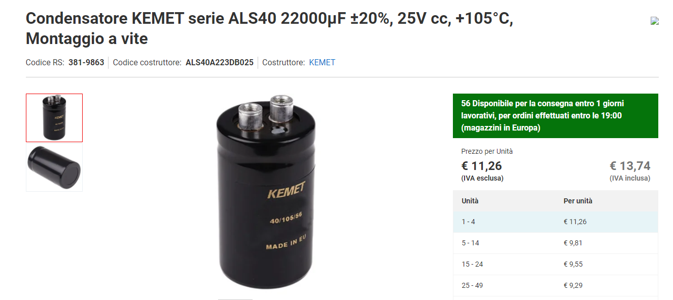

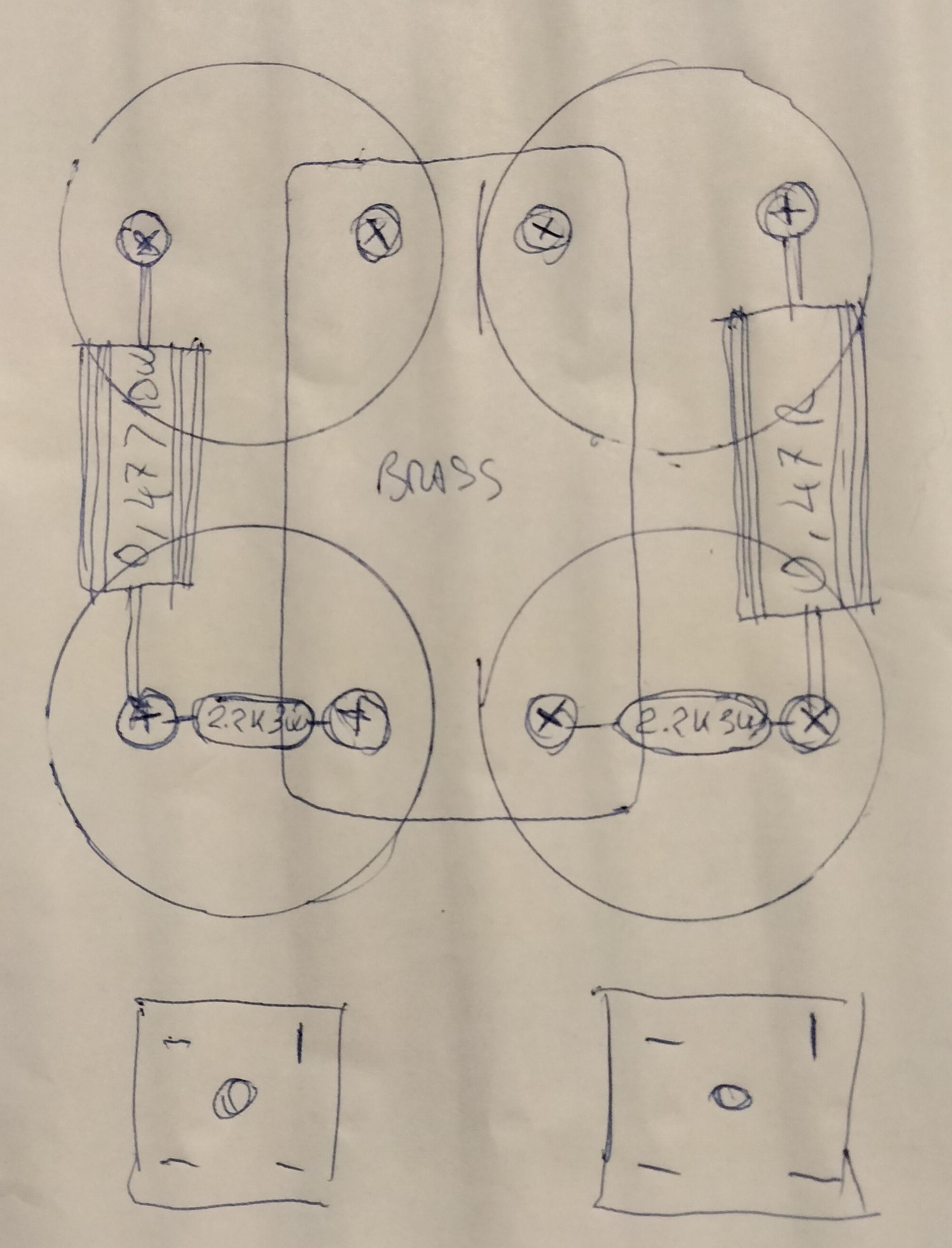

If I build monoblocks with two 200VA transformers, is it a possible (and good) solution to build a PSU like that for each channel?
With those resistors (or smaller R value):
And those caps:
Thanks for help :cheers:

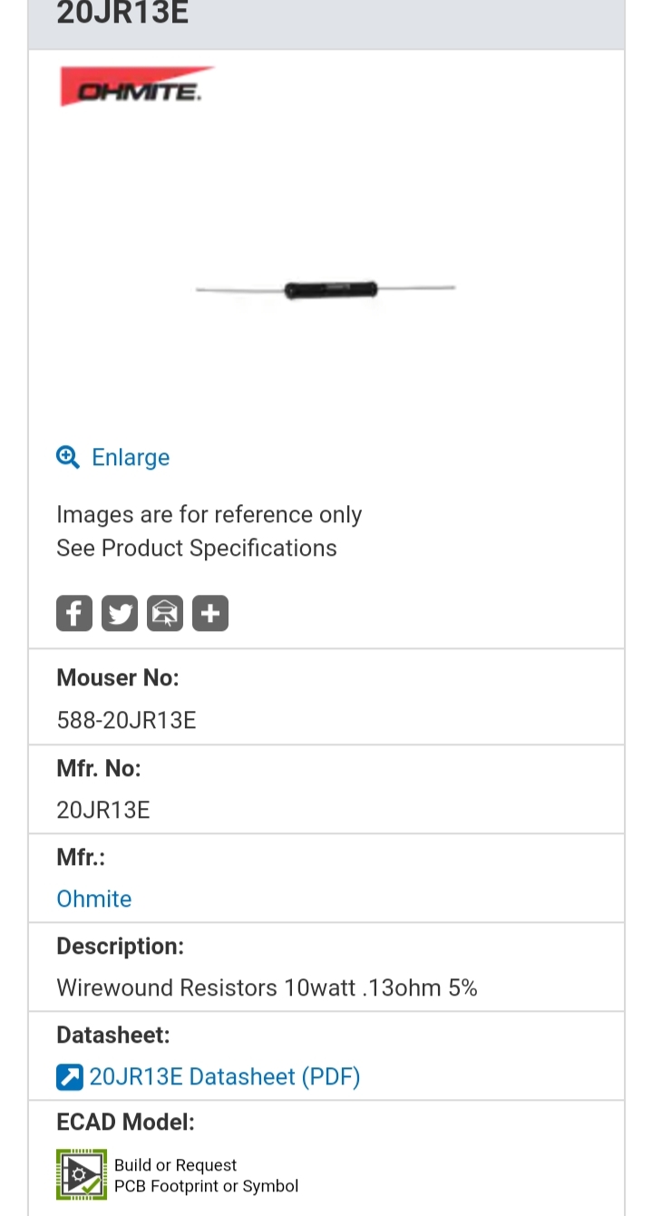

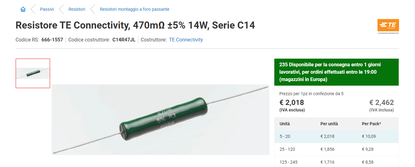

I have a modular external power supply I use with my Aleph-J, M2, and M4 amps. The power supply is arranged in CRC fashion, using 3 x 0R22 3w mills wire wound resistors on each rail. This works fine and they only get mildly warm. Just mount them in free air so they can cool a little. I would aim for no more than 0R1 total resistance between caps and go for about 10w total power rating - mine are 9w.

I calculated around 23Vdc on rails. Am I wrong?
What is the problem with wirewound resistors?
The alternative is thick film with heatsink...
25V caps should be Ok, but still I would use 35V caps to be on the safe side 🙂
Not sure if it matters here, but most wirewound resistors are inductive.
I see that Panasonic 3W resistors are NRND. What about Vishay/Dale 3W CPF resistors?
