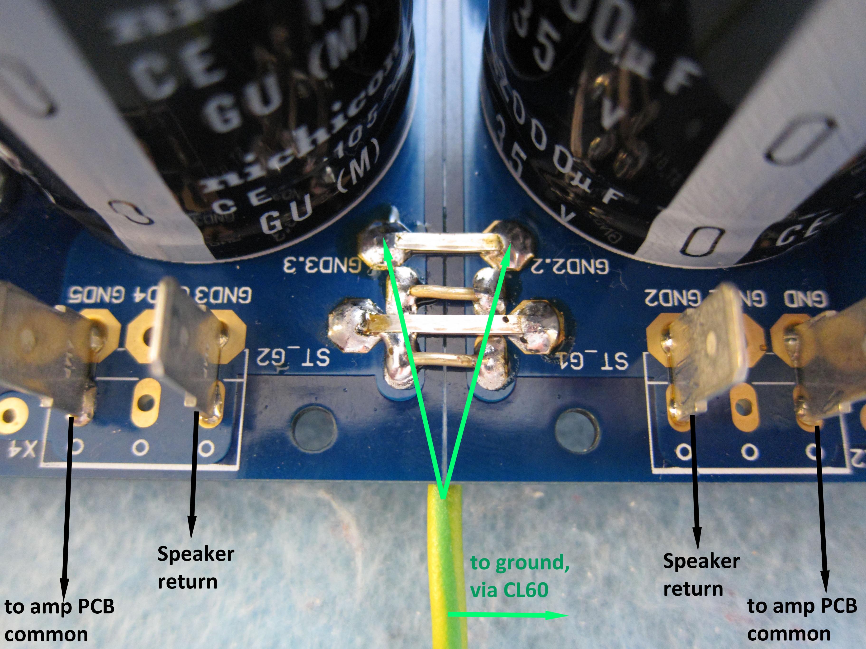

The green ground wire (that goes to the chassis via CL60) should be soldered where the green arrows point.

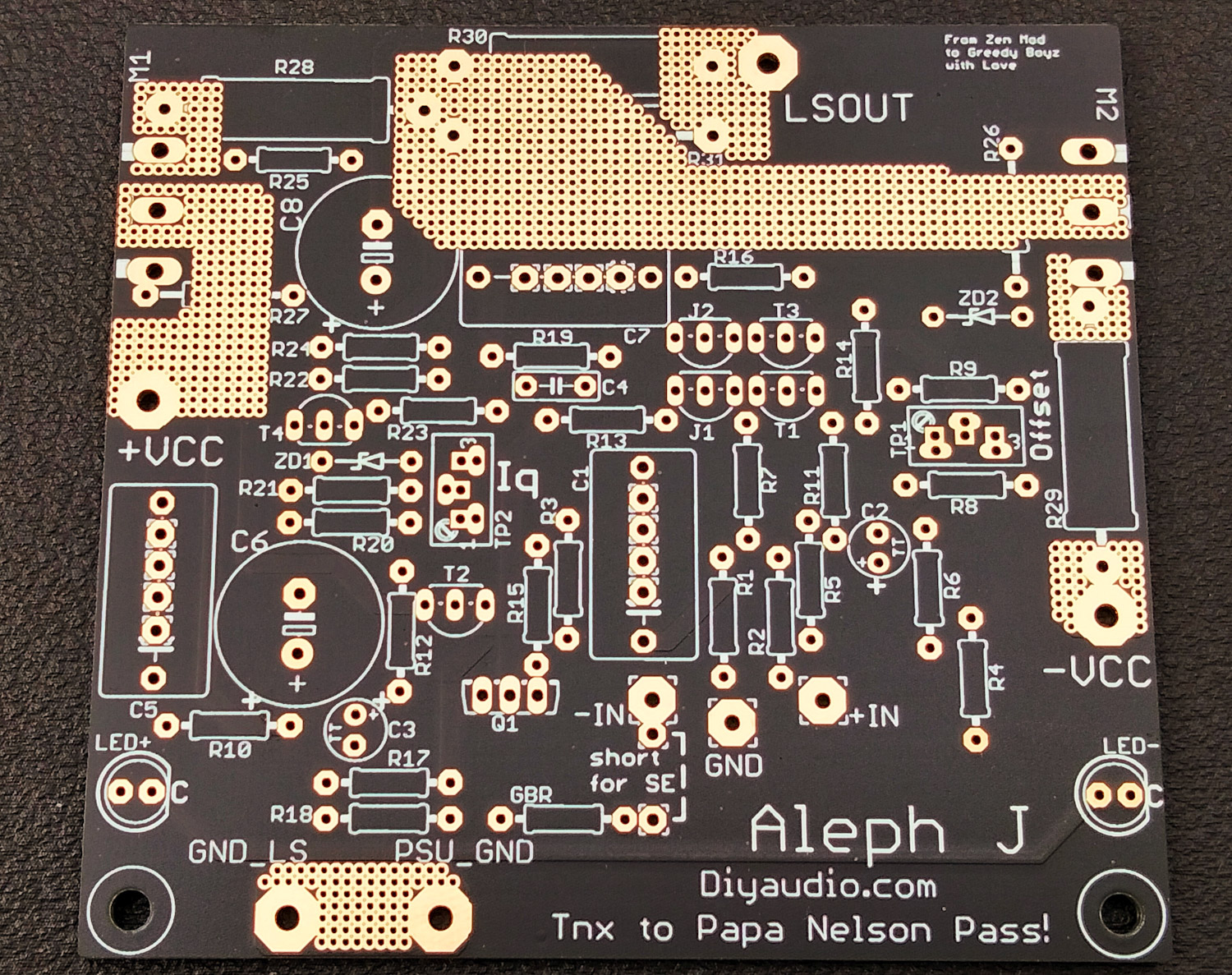

If it wasn't for the R2 (and the LED's which are not necessary at all, for the normal amplifier operation), the amp PCB's could do without ever needing to see the common reference point...
There's no localized decoupling on the AMP PCB's. With the short and thick wiring (good to couple that HF noise the white paper is talking about...but I question the amount of that (eventual HF) noise...), I see no reason why the speaker return should go to the AMP PCB's first.
I think, for what we have at the moment (no local decoupling, Zener D1 referenced of the Vee instead of common ground potential - Nelson at his best???), feeding the speaker return straight to PS common is a better option.

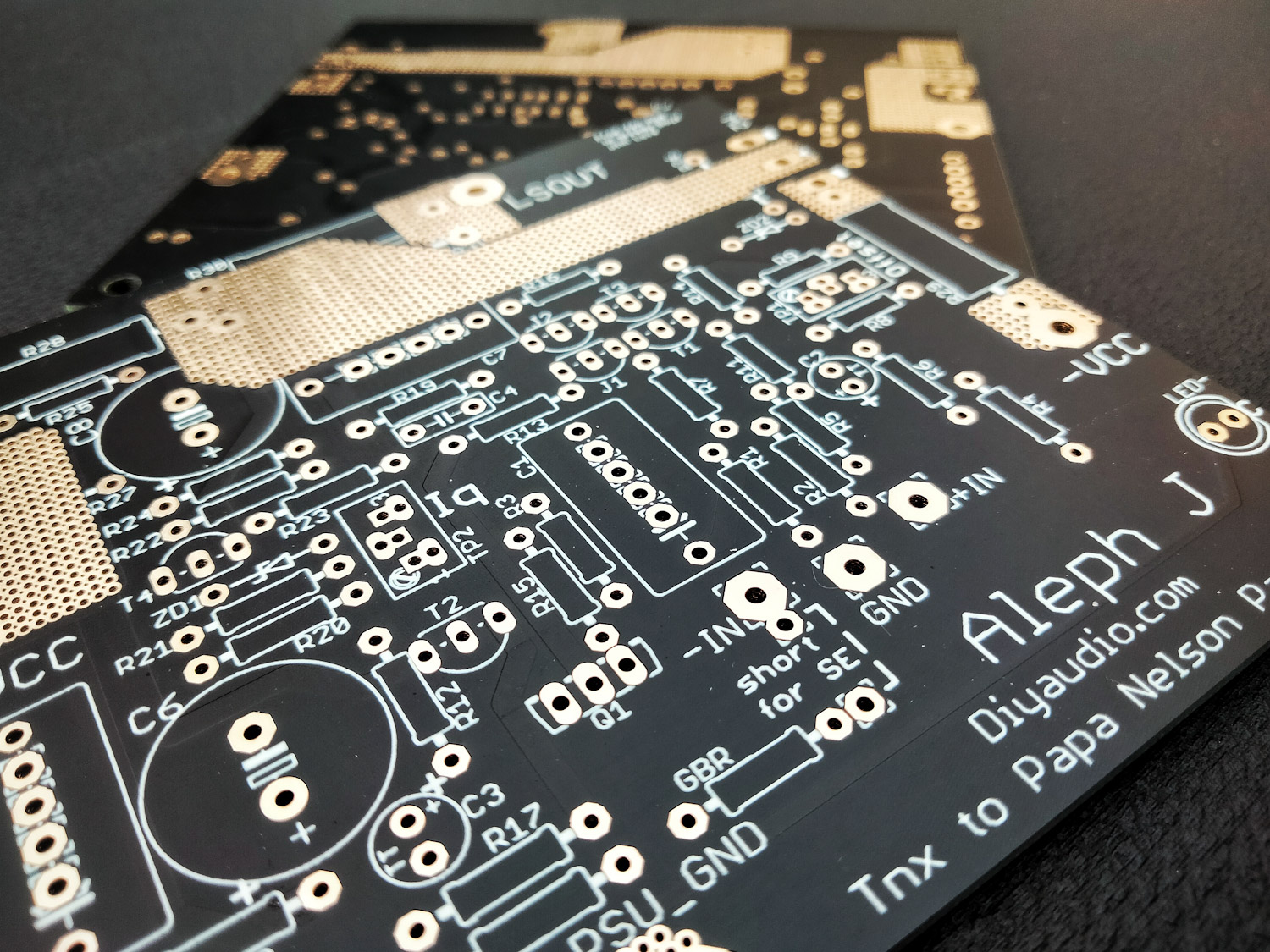

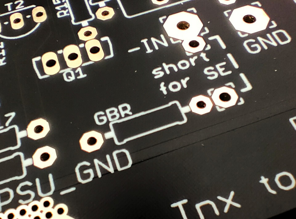

GBR? Greedy Boys Resistor? 😀
name of the game with this pcb was simplicity, maximal, in everything (preparing, assembly, setting), without loosing performance
among other things, there is Ground Braking Resistor, for Greedy Boyz having difficulties with proper wiring
I don't need it in my builds, but better to have it, just in case
all details when 6L6 choose to publish it, it's outa my hands

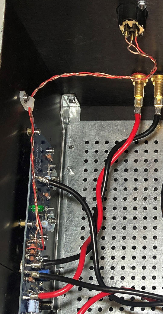

The XLR shield goes to its designation on the AMP PCB. I used a slight twist of + and - input signal wires and included the shield bare litz (multi-strand) wire in that twist as well. The ground-lift resistor must be removed (if previously used with RCA's, i.e. with amp wired to accept the single-ended input, which was how I used the amp initially).
It is important that the shield (bare) wire does not touch the chassis; the chassis and the amplifier ground are separated by the CL60, which in this case provides a 10 ohms difference between these two potentials.
The speaker negative (return) should not go to the amp PCB -> it should go to the power supply PCB. The power supply PCB does not really have a ground segregation provision(s); the best you could do is to look at the second photo I attached. I used the X4 ground connection on the PS PCB for an additional decoupling capacitor....; however, the X4 (visible on the photo, only just <- left-hand side) is an even better point to return the signal ground from the AMP PCB.
NOTE: The first photo is an old photo - it shows the speaker return going back to the AMP PCB...
Aleph J needs two power supplies; using the separate power supplies will bring an additional level of benefits to its separation of sound (the perceived left-right, and top-bottom extension).
Edit: The latest photo attached.

With the things I picked up along the way, I am gearing up to build a fresh Aleph J; this time with a "discrete" power supply & correct returns for the XLR inputs, R2 resistors, speakers, and connection to chassis. I will not use the LED's on the amp PCBs, so that R2 resistor return will indeed be only for R2. No short circuit protection, C1 bypassed.

Some follow up:
1. You use a bare wire for the ground from the XLR to the Amp board? Any reason it can't be insulated? Esp since you caution not to let it touch the chassis (BTW, I measured a 13ohm diff. between the amp ground and the chassis ground).
I currently use RCAs, with the Neg input and Ground shorted (connected to each other) at the amp board, so it seems electrically this will be equivalent? I've done most of all the basics to eliminate hum (twisted leads, mains under the floor for instance), but still have it slightly. I notice the slight hum is related to the input leads- unconnected it gets louder when I touch them- some sort of capacitance thing.
2. In your middle photo- you're connecting a line from those ties between the 2 PSU boards to the CL60? That's better than connecting one of the grounds on one of the PSU boards to the CL60? So just solder the green line to the middle of a tie or something?
3. On your right photo, curious about the capacitor you have on the XLR on your right photo?
