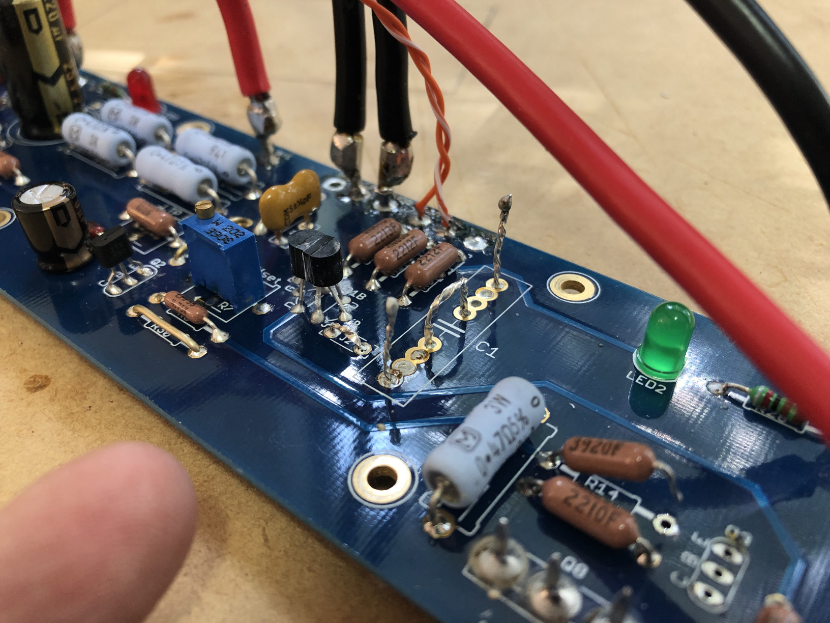

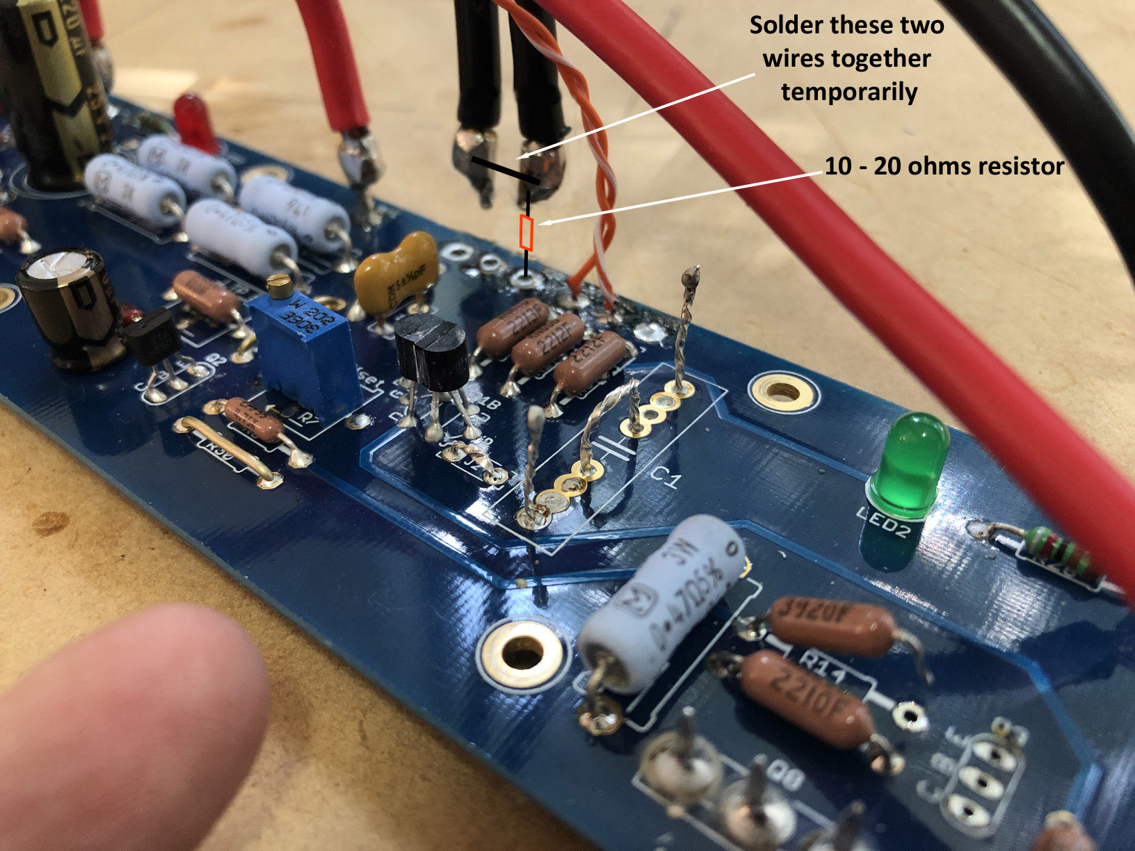

I currently use RCAs, with the Neg input and Ground shorted (connected to each other) at the amp board, so it seems electrically this will be equivalent? I've done most of all the basics to eliminate hum (twisted leads, mains under the floor for instance), but still have it slightly. I notice the slight hum is related to the input leads- unconnected it gets louder when I touch them- some sort of capacitance thing.
RCA input => use ground-lift (10-15 ohm) resistor. This will sort out the buzz/hum.

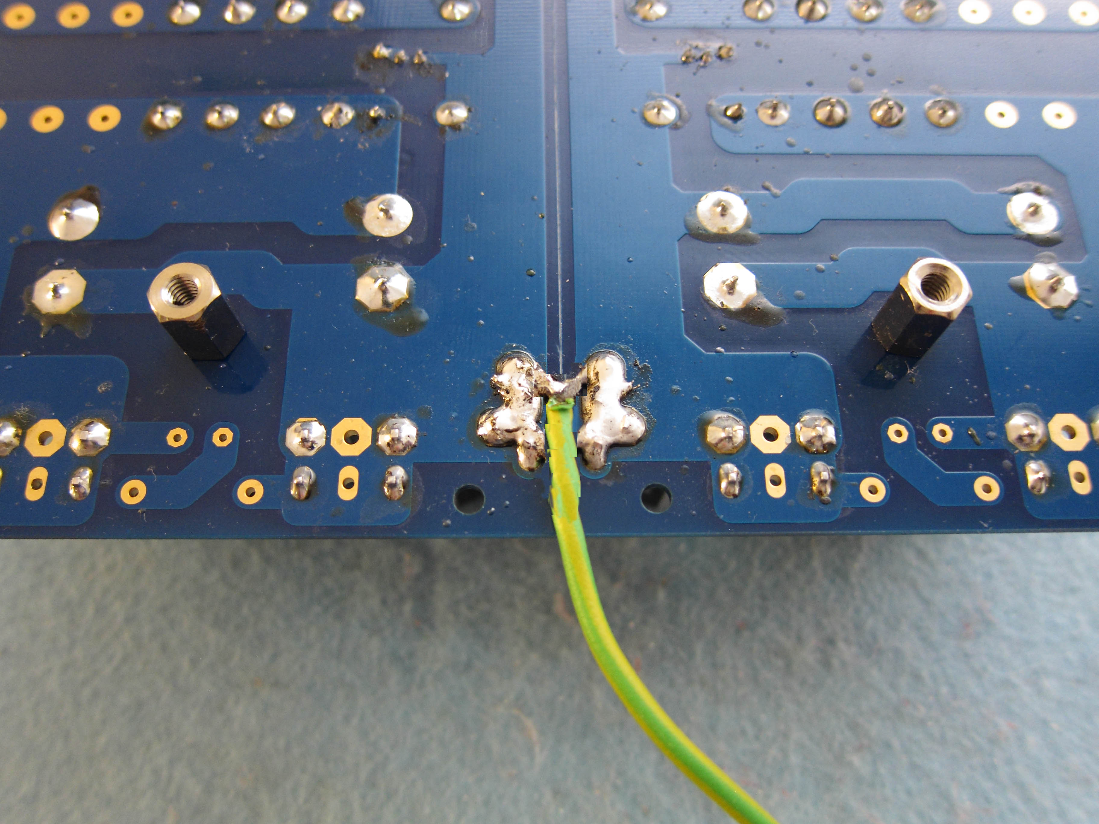

2. In your middle photo- you're connecting a line from those ties between the 2 PSU boards to the CL60? That's better than connecting one of the grounds on one of the PSU boards to the CL60? So just solder the green line to the middle of a tie or something?
See the photo attached

In case you don't know how to insert the ground-lift resistor... you can test it first - see the first photo (before) and the second photo (after).

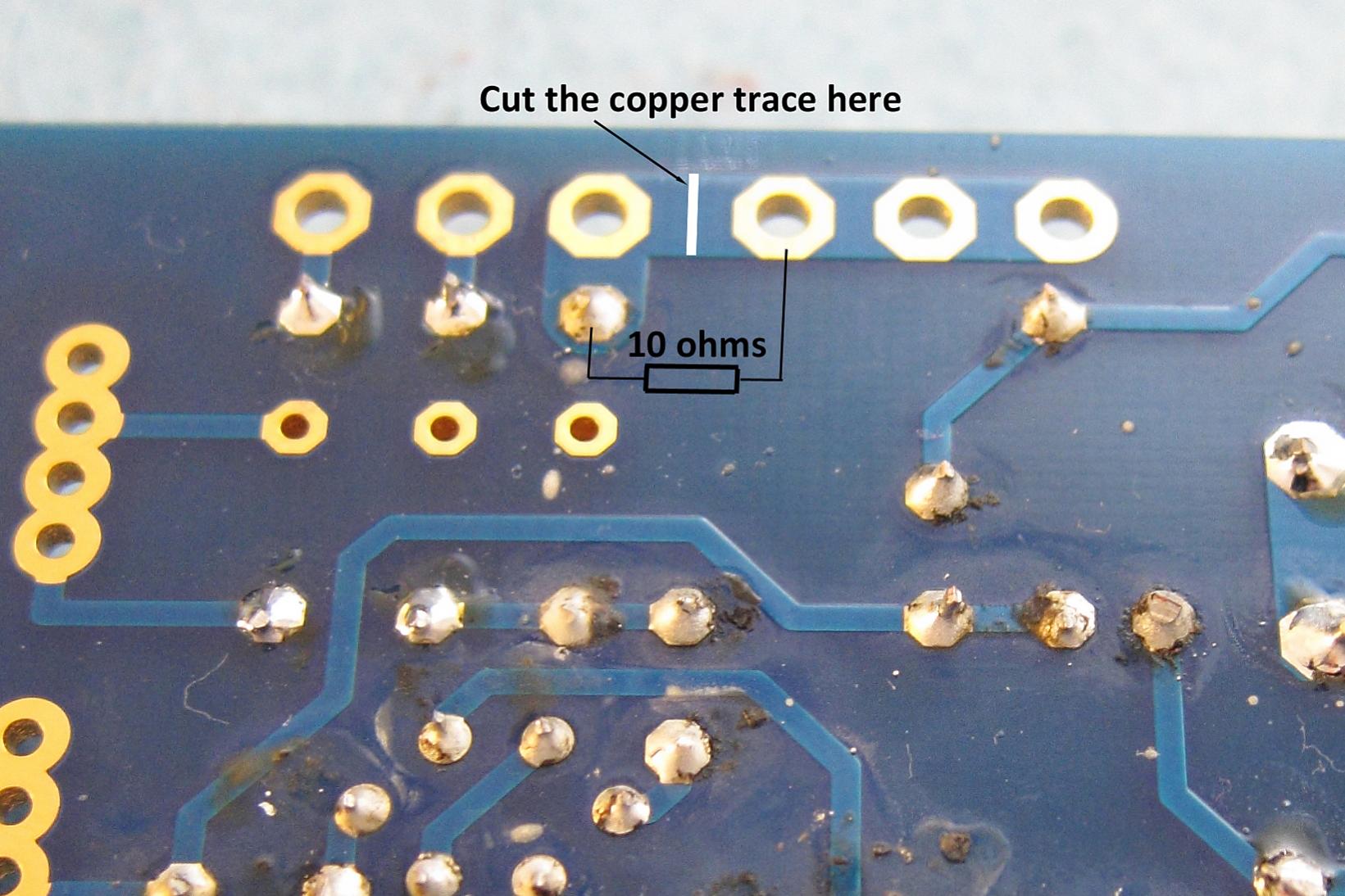

If all good and you can't hear the buzz any more, you can modify the PCB and provide a "permanent" solution - see the third photo (the copper trace).

The XLR shield goes to its designation on the AMP PCB. I used a slight twist of + and - input signal wires and included the shield bare litz (multi-strand) wire in that twist as well. The ground-lift resistor must be removed (if previously used with RCA's, i.e. with amp wired to accept the single-ended input, which was how I used the amp initially).....
Aleph J with XLR's will work reducing-the-buzz wise, but only if the input JFET transistor pair seas equal noise on their gates; this will happen only if the source is equally loading XLR + and -, i.e. only with a true XLR source... If you are planning to use XLR sockets (input), and then use RCA's (link pin 1 and pin 2 on the XLR, you will still need a ground-lift resistor.
You could just install the ground-lift resistor anyway, and then short it out with a piece of wire if you move to true XLR topology. It's a safer option.

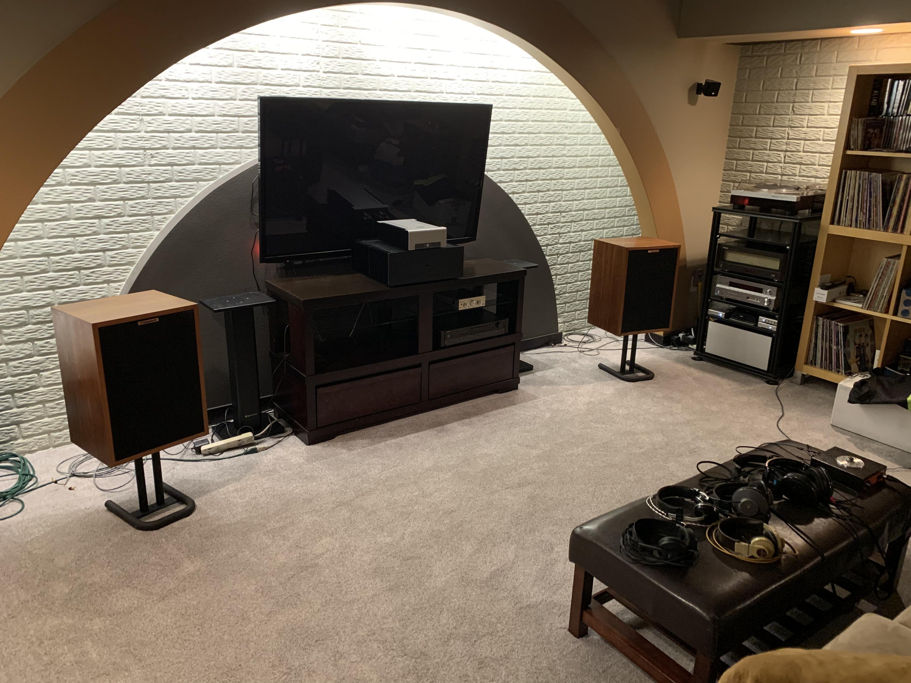

Two 5Us? I don't have a space that could locate both of them. I never actually put sizes into perspective, and now with the (much) smaller VFET case, even the 4U would be trouble, the 5U would be simply un-sellable to my wife and to my own aesthetics in our living room.
You guys either live in bigger spaces or have less constraints in general! Lucky you!
LOL! No, in my case, my wife is worth a thousand 5Us. Hope that never changes. Still, even without wife, I think two 5Us is bordering the need of a dedicated room and a much better system all around, including room treatment. I'm keeping my wife for the foreseeable future!

I do have a dedicated space to listen, but would have to reorganize some things to fit all that! I do have some equipment on evaluation loan from a friend (F4, Aegir, Korg B1B, and a truckload of headphones), so I’ll have to time it just right.

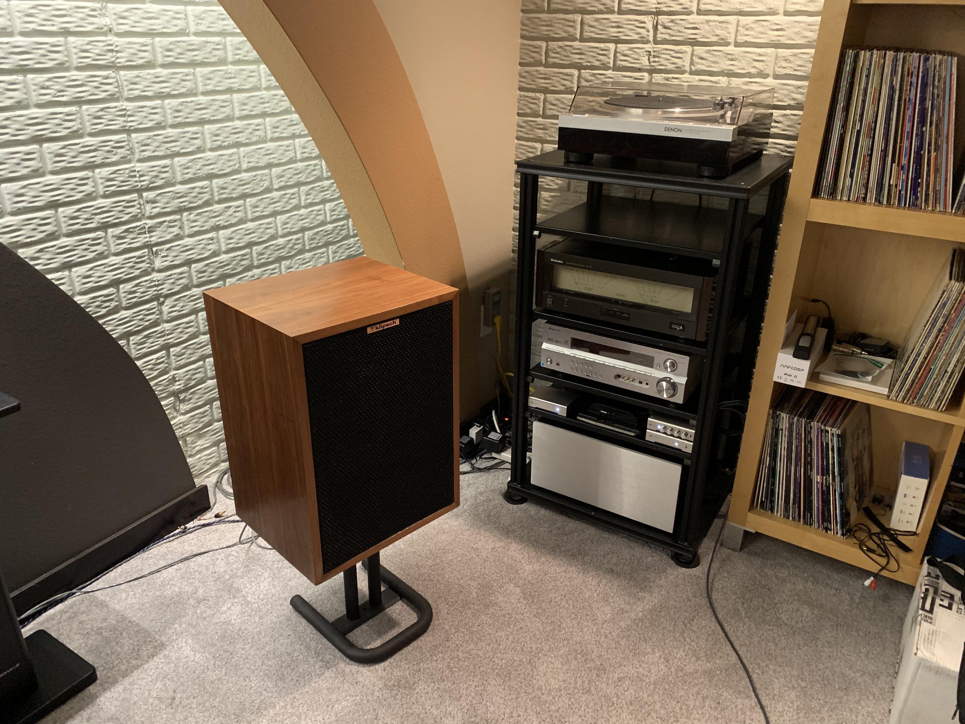

Great looking room, man.
