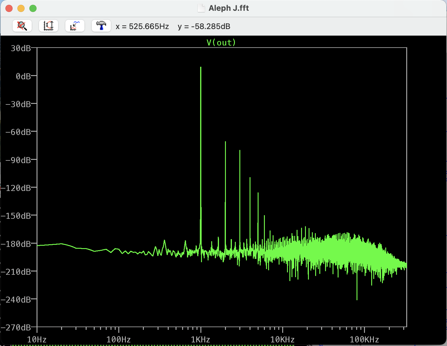

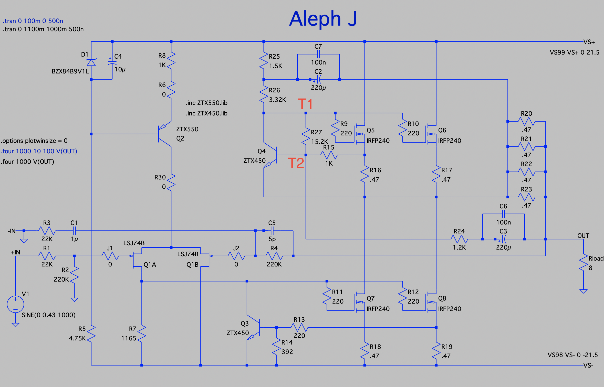

But what makes me crazy is the LTSpice simulation!
My simulation shows me THD 0.22% at 1W/8ohm!!!
Harmonic Frequency Fourier Normalized Phase Normalized
Number [Hz] Component Component [degree] Phase [deg]
1 1.000e+3 4.077e+0 1.000e+0 -0.31∞ 0.00∞
2 2.000e+3 3.738e-4 9.168e-5 -26.47∞ -26.16∞
3 3.000e+3 1.174e-4 2.879e-5 26.70∞ 27.01∞
4 4.000e+3 2.318e-5 5.685e-6 -173.79∞ -173.48∞
5 5.000e+3 1.641e-5 4.025e-6 177.72∞ 178.03∞
6 6.000e+3 1.326e-5 3.252e-6 174.73∞ 175.04∞
7 7.000e+3 1.140e-5 2.796e-6 173.93∞ 174.24∞
8 8.000e+3 9.978e-6 2.447e-6 173.09∞ 173.40∞
9 9.000e+3 8.871e-6 2.176e-6 172.21∞ 172.52∞
10 1.000e+4 7.988e-6 1.959e-6 171.34∞ 171.65∞
Total Harmonic Distortion: 0.009652%(0.221822%)
So what can I expect from the actual build then?
And the same LTSpice simulation of F5 shows THD 0.005% with my actual build measuring at THD 0.01% - so I'm inclined to believe that simulations are quite ok.
But then, my build behaves as expected! And I'm totaly confused!
Does anyone see any mistatakes in component values or something on the simutation?
I mean, I would like to have at least the simulation giving me the ecpected THD of about 0.06%...

Yeah, I was playing with the simulation today and found out that FFT becomes fine if I eliminate C1 or change it to 100uF instead of 1uF. I was also suspecting that my simulated measurements without any initial time before the circuit settles down could be wrong. And this is the case, I think. And then I tried to introduce a 1 sec initial delay into the simulation. The FFT I got is totaly different and THD is just 0.01% (attached for the reference). Well, this was good new experience for me too
Now, simulation clarified and out of the way, back to the real thing.

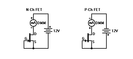

And how could I test LSJ74's out of circuit? Universal transistor checking tool could be of any help here?
Something like this: https://www.amazon.com/Pocketable-M...t=&hvlocphy=9010231&hvtargid=pla-845729973092
Not for matching transistors, just to check and see they are working.

for these - decrease LTP current (0 output DC offset is what you observe and what is your goal)
sole programming resistor is what you need to change (up in value - put trimpot if you didn't already)
check JFets in simple matching jig, small 12V PSU or 9V battery

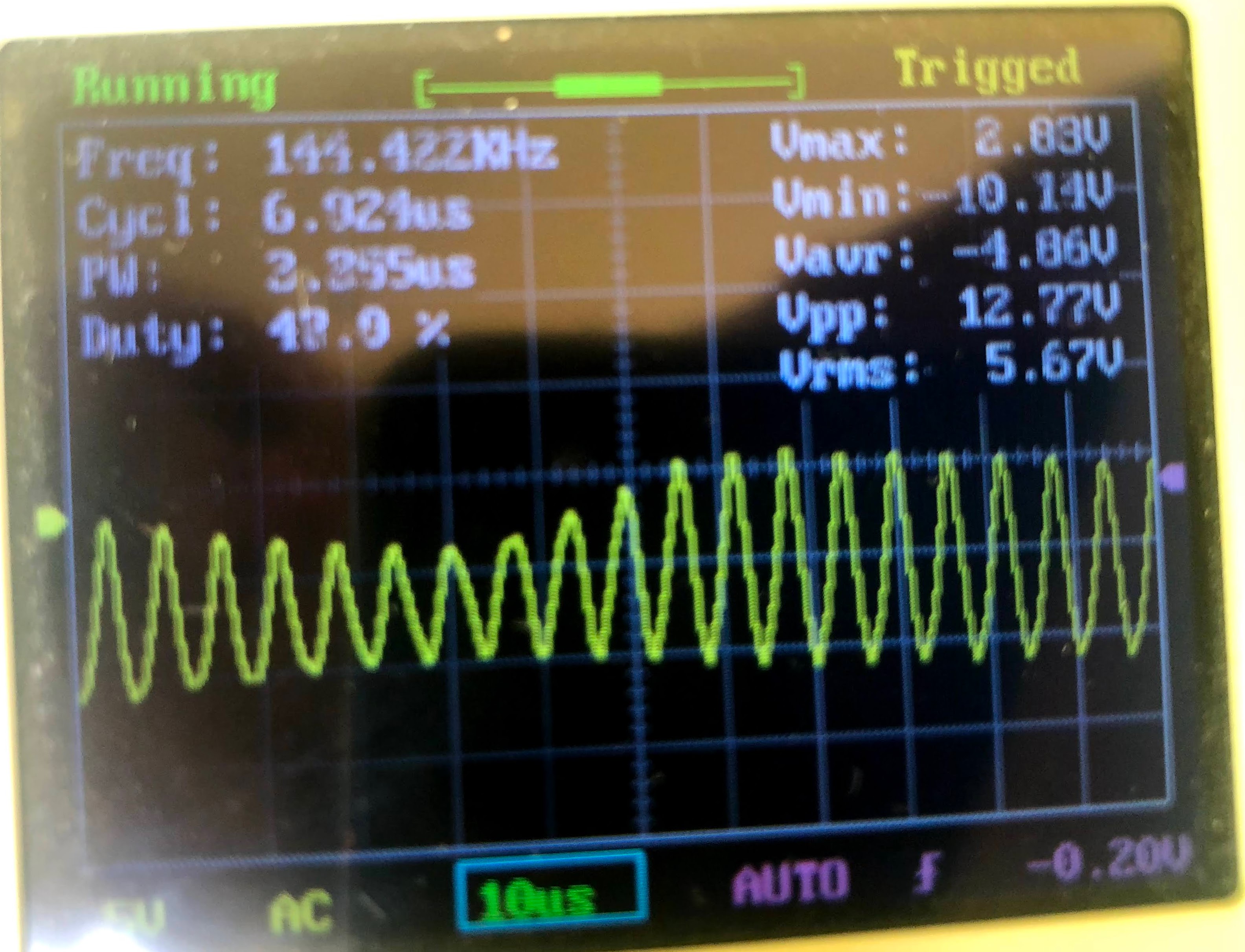

Before ripping apart my Aleph J again and desoldering JFETs I wanted to poke arround with the multimeter. And I noticed a strange (at least for me) thing arround the bias setting resistors R27 on both boards.
I noticed that if I measure DC with the reference to ground at one side of R27 (marked T1 on the attached scematics) I get 4.8V (and that also agrees with the simulation). But when I measure DC on the other side of R27 (point T2), I get negative -0.25 to -0.35 (it's changing every minute or so). And when I measure DC across R27, I get about 3.86-4.00V. These measuments do not match in my understanding. And in the simulation numbers do match (0.6V at T2 and 4.2V across R27).
Then I measured AC with the reference to ground at poin T2 and got ~6VAC. And checking that point with the oscilograph I see the picture attached: some 12Vpp at a frequancy of about 140-150 KHz!
Does it says something? Is it some sort of oscillation?

It could be that the probes are causing oscillations.
In fact, this is how I used to find the bad MOSFET, out of many (let's say 12 MOSFETs, or more), without desoldering them. I used to place the probe on the gate stopper resistors, one at a time. The faulty one (faulty MOSFET) would cause oscillations (start to oscillate), with the probe connected to its gate stopper resistor.
You may have faulty MOSFET(s). I am not sure if you have replaced them or not...

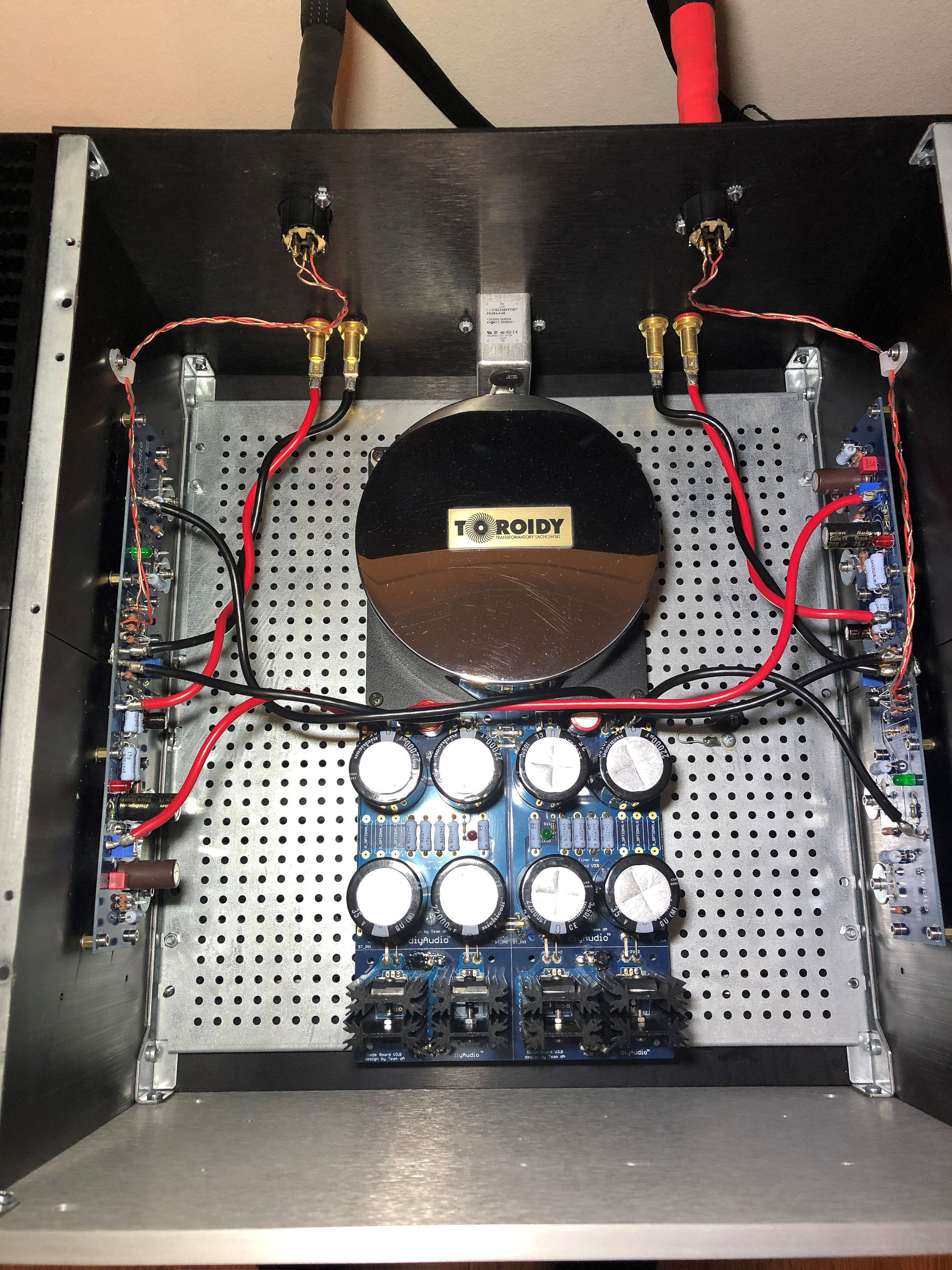

I am not sure if you posted the photos of your build. Maybe you have wiring issues...?
Have a look at the attached photo. The orientation and placement of PCB's and CL60 ensure the shortest possible wiring - all wiring!
The mains wiring is only 10cm long including the CL60; it runs underneath the transformer mounting metal plate.
DC wiring is also the shortest possible because the PS PCB lugs are now in the middle of the amp.
The 2X20V AC wiring is 25cm long (runs underneath the power supply PCB; the wires are fed from underneath the PCB and then soldered from the top)
