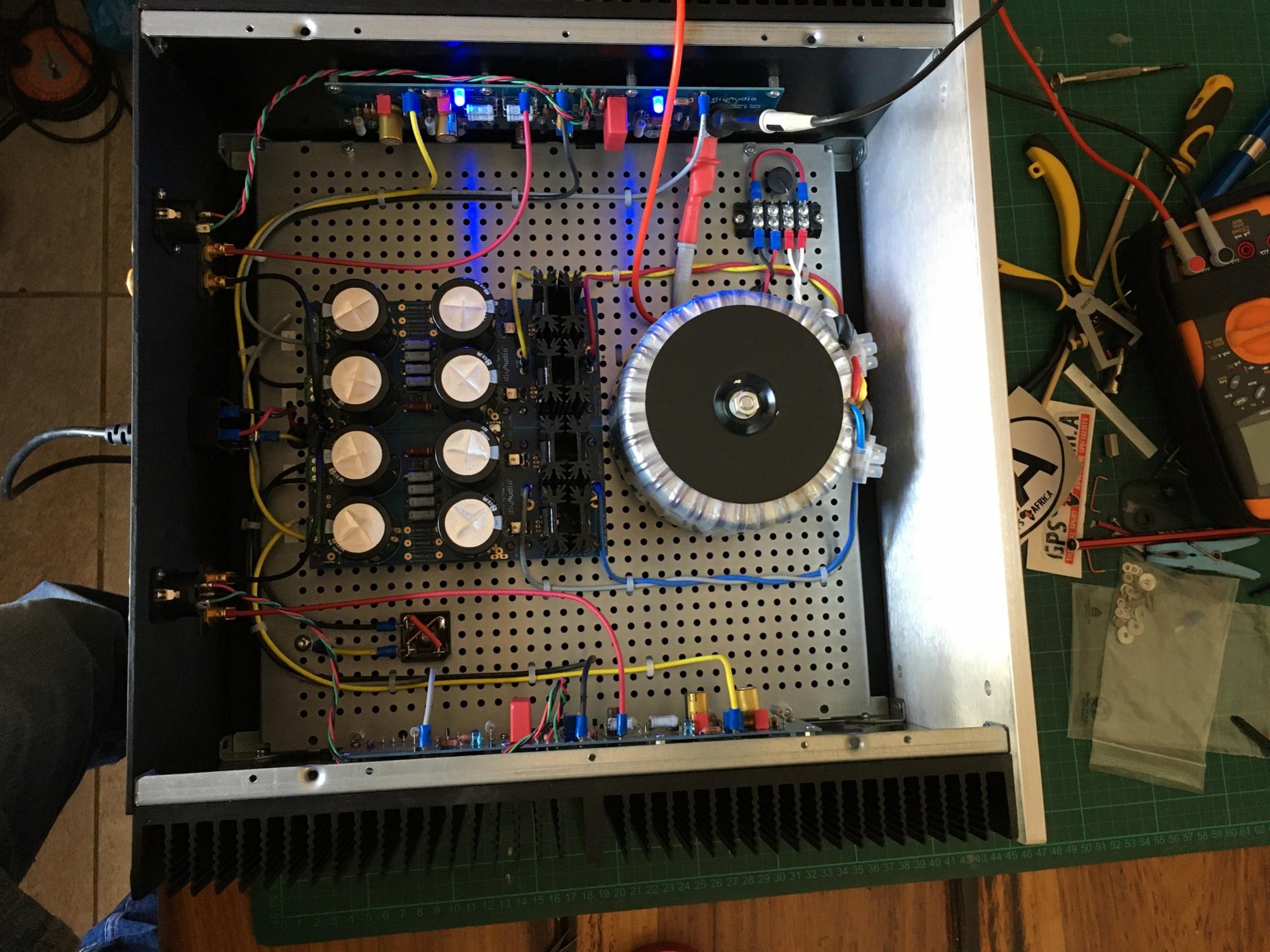

OK, wiring complete. Started the testing and adjusting.
PSU checked OK with both DC voltages at around 25.9V and -25.9V unloaded. Then I connected just one PCB and started biasing. Is it normal for the bias voltage over the resistor to drop as the amp heat up? Started at 400mV, but every now and then I have to adjust to get it back up. DC offset is about 0.006 mV. EDIT: Corrections are getting less and less as it heats up. Sinks are nice warm now after 30 minutes.
Once this PCB is done I am connecting the other PCB. Hope that channel goes as well as this one.

@henryve, yes, it's normal for the bias voltage to drop when the amp heats up. Check the initial voltage to be sure that it is not too high and then close the lid and let the amp to reach it's normal working temprature (wait for at least 30 min., perhaps an hour). And then open the lid and set the bias.

She's making music mama!
Spinning Dire Straits's Alchemy on the Linn at the moment.
Congrats! I see you used Andrew Russell's method of breaking up a ground loop! Well done!
Do you have dual heatsinks on each side? Or single? What bias did you settle on, 0.85A (400mV) or 1.06A (500mV)? I have found 0.85A for single heatsink (4U/300 chassis) is safest.

My case is the 4U/400, in other words it has 2 sinks per side. I have settled for now on 400mV bias since it can get toasty around here. Even now in late April we still get the occasional 30 degrees C day.

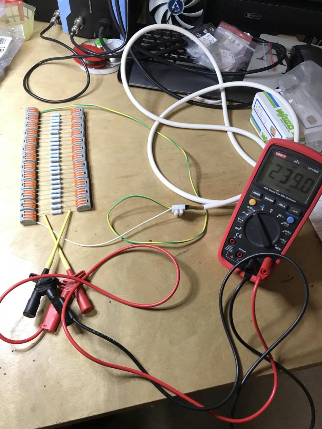

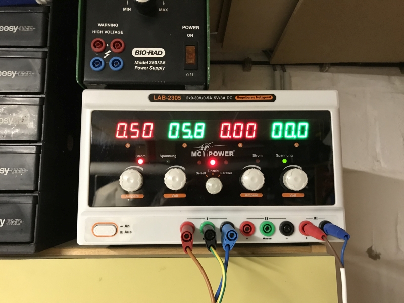

I second that matching source resistors is important, especially if you are using +/- 5% resistors.
Have a look at my technique of matching source resistors. The usual multimeters and measurement techniques are very bad at measuring low resistances, but are quite accurate in measuring tiny voltages 😀
Best regards, Claas
