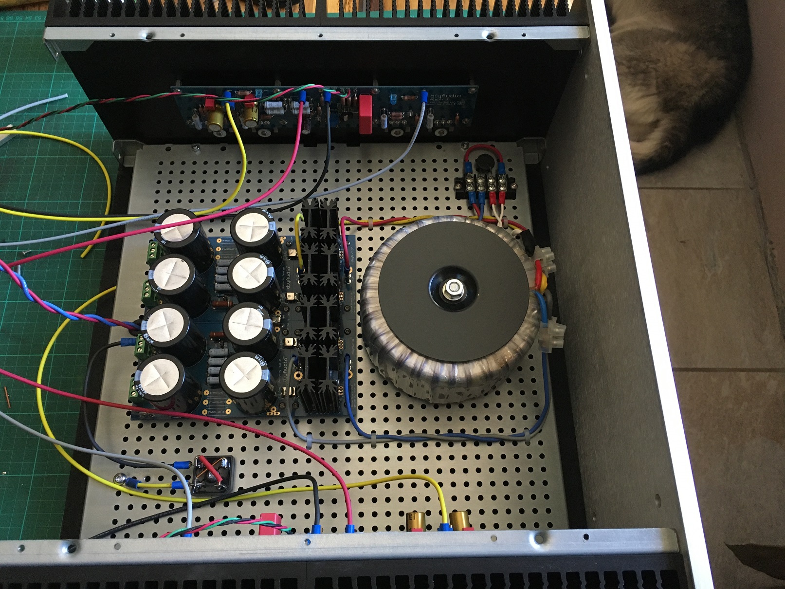

Another Zen Mod AJ nearing completion! I was fortunate enough to be provided a set of ZM AJ boards to participate in an experiment. We'd be attempting to answer the question: Is is possible for a noob to successfully build an Aleph J without excessive confusion, headaches, teeth gnashing, or other calamities?
Yes!! The answer is a resounding YES. Even someone who knows ALMOST nothing can pull this off. Ok, truth be told, I asked a LOT of questions of pFarrell, and 6L6 who were kind enough to answer all my questions.. Boards built up beautifully, were easy to set offset and bias.. and my AJ sounds amazing.
This journey started about a year ago for me with the Whammy. I really enjoyed the build, however I started itching to buy a set of descent speakers and a build a power amp. Patrick and Jim worked tirelessly putting this plan together for me..
I still have to button some things up, the LED wires leading to the front face are really janky and need to be finalized, but I'm absolutely loving the sound. Listening to the AJ via vintage Hersey I speakers, my Whammy as a pre, Schitt Modi DAC, and Tidal for source.
Thanks very much to everyone on this forum.. Particularly pFarrell, 6L6, Zen Mod, and Papa Pass!

OK then on to the end goal. Should be done by the end of the weekend.
Have not yet manage to find someone to do my front panel. No Front Panel Express type of service around here, although I downloaded the S/W and did a design. Oh well.

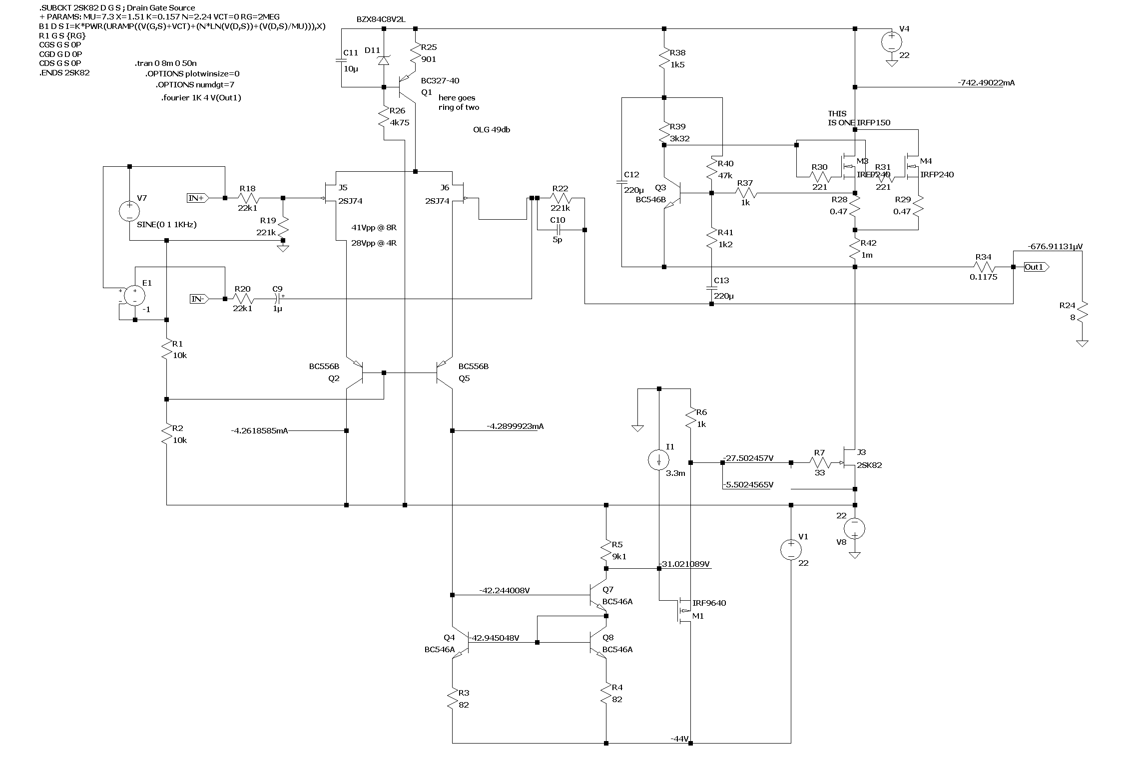

any news?
well, I almost forgot
here's what I came with, several nights ago
didn't look at it afterwards, maybe will tomorrow, really interested to see how much stupid details I succeeded to push in
can it be done simpler - yes
is it worth hassle- at all ........ nope - I think
