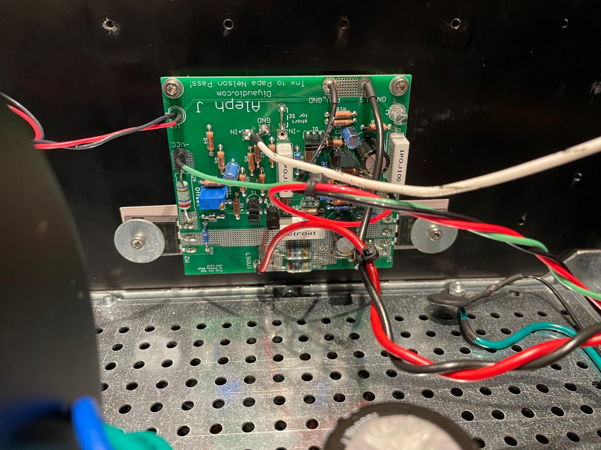

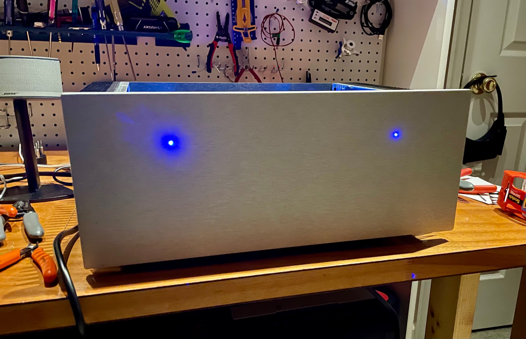

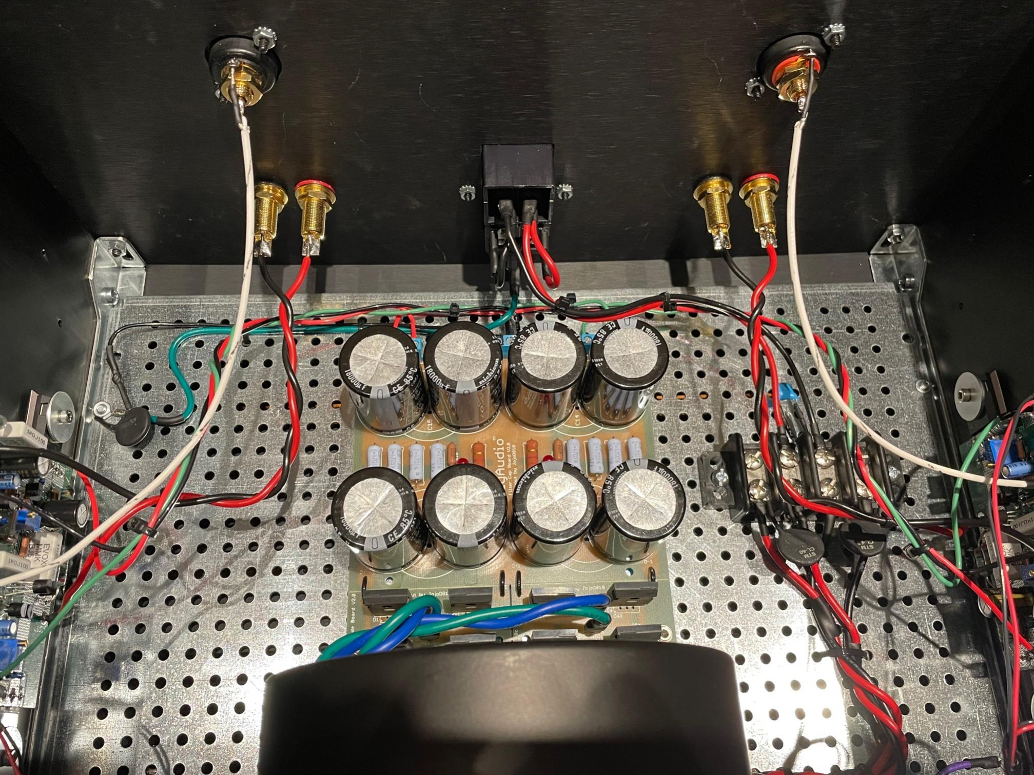

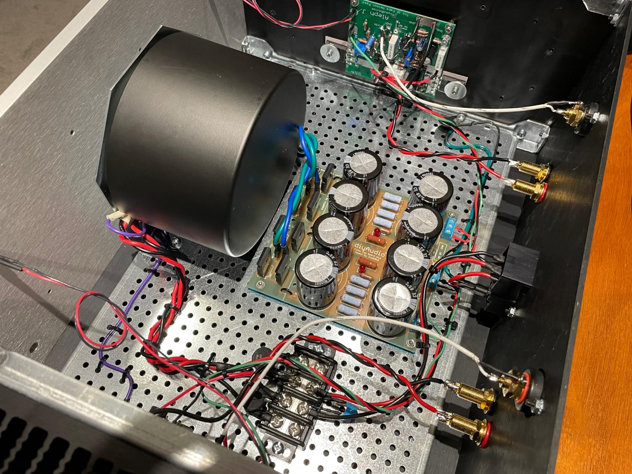

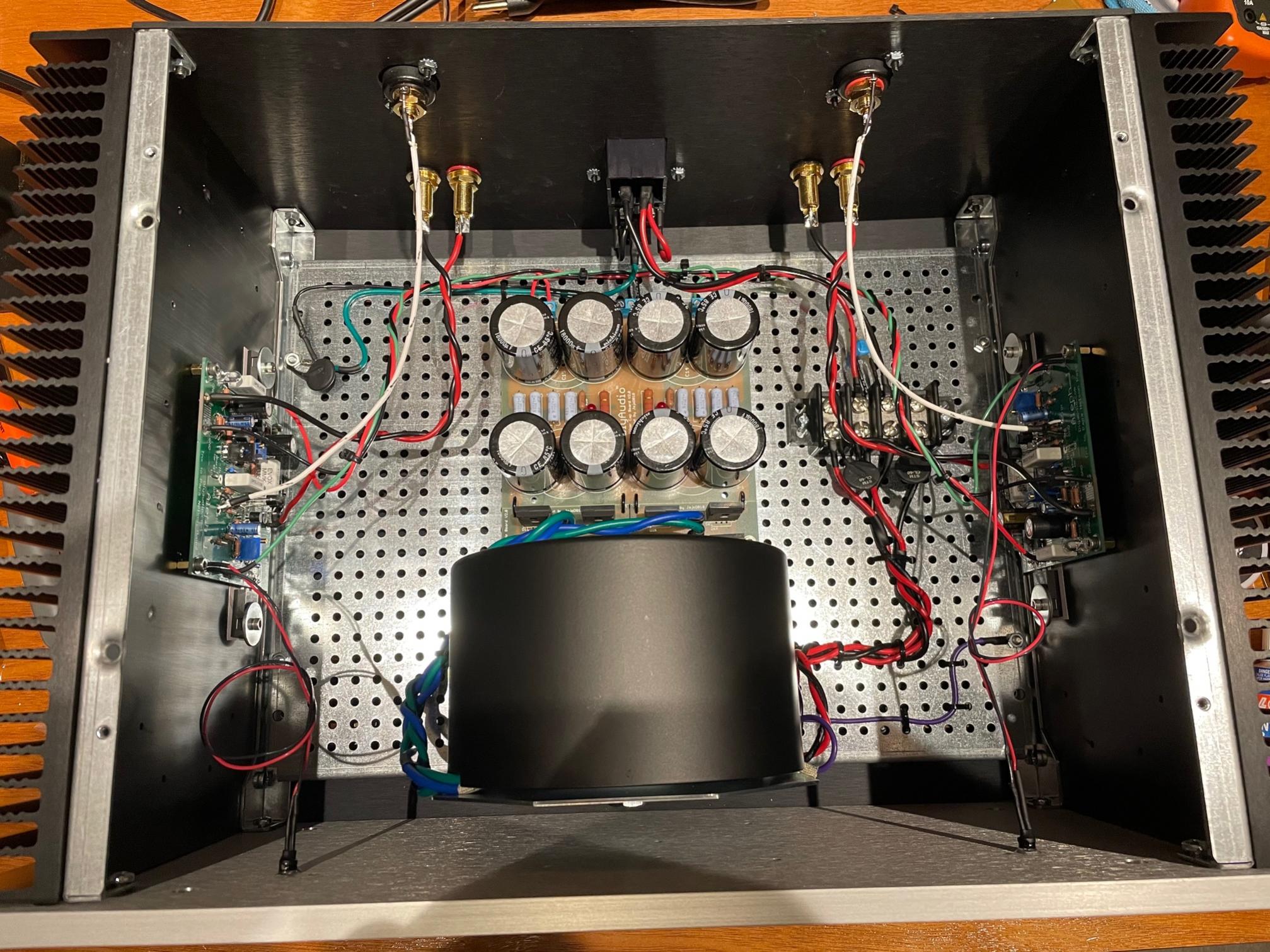

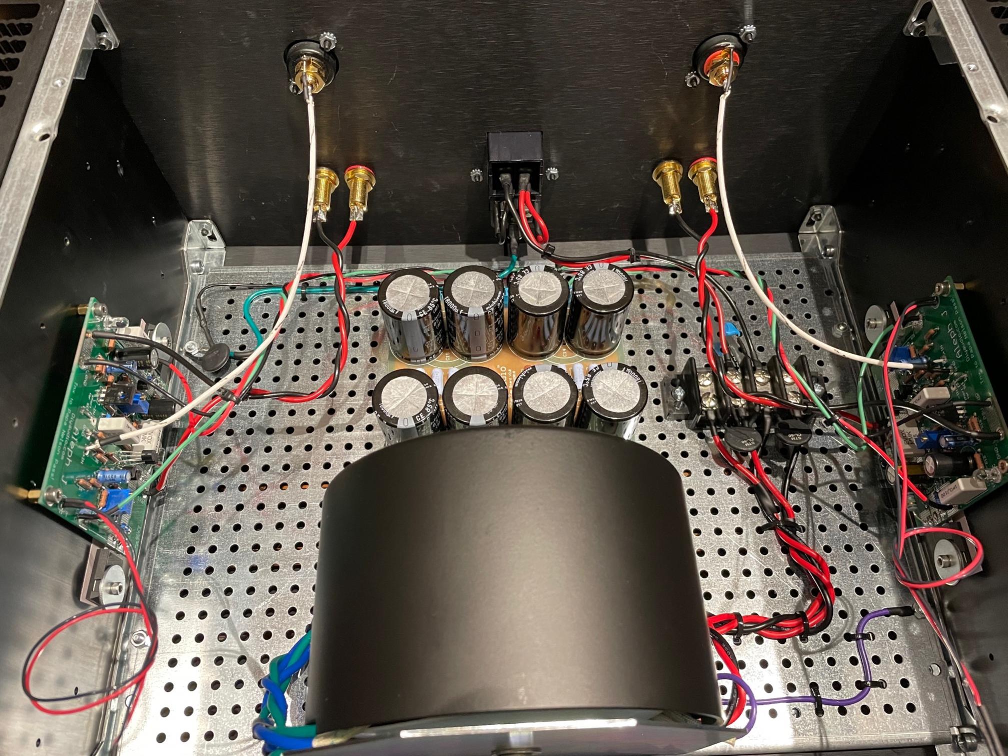

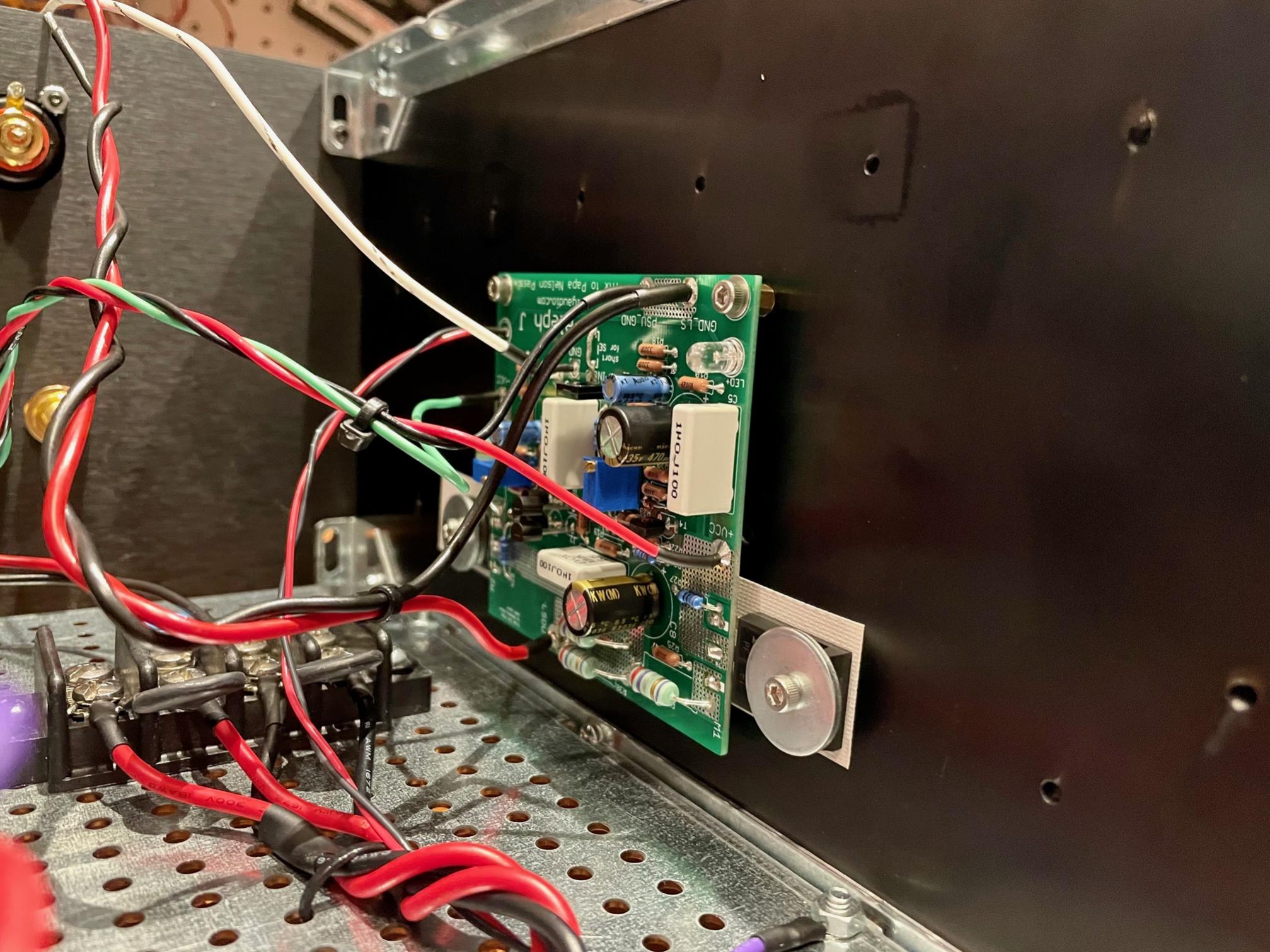

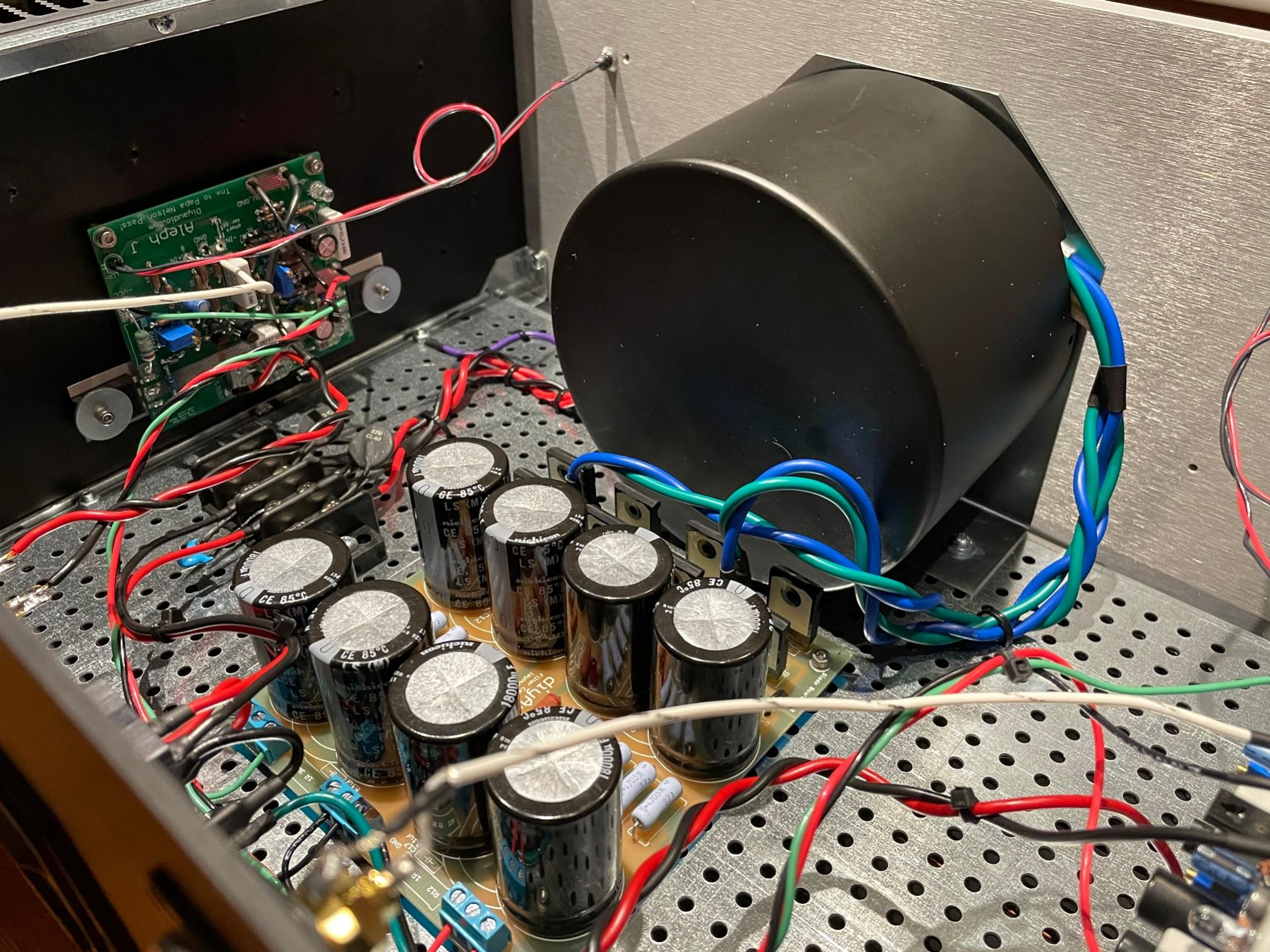

AJ boards are now flipped! Not to difficult to do, thankfully I had enough slack in the power wires that I didn't need to disconnect them. I did desolder the signal wire, and LS Out/Ground to make things easier.
Also moved thermistors up and out of the way of the transformer primary wires, didn't realize they got so hot! Shortened up a few other wires mounted LED's into front face, then after getting everything buttoned up, I plugged it into a circuit with GFI and blew my 2A fuse.. boo.. My amp will be quiet for a few days while I order a few spares!
Better pics as requested, thanks for the suggestions all!
