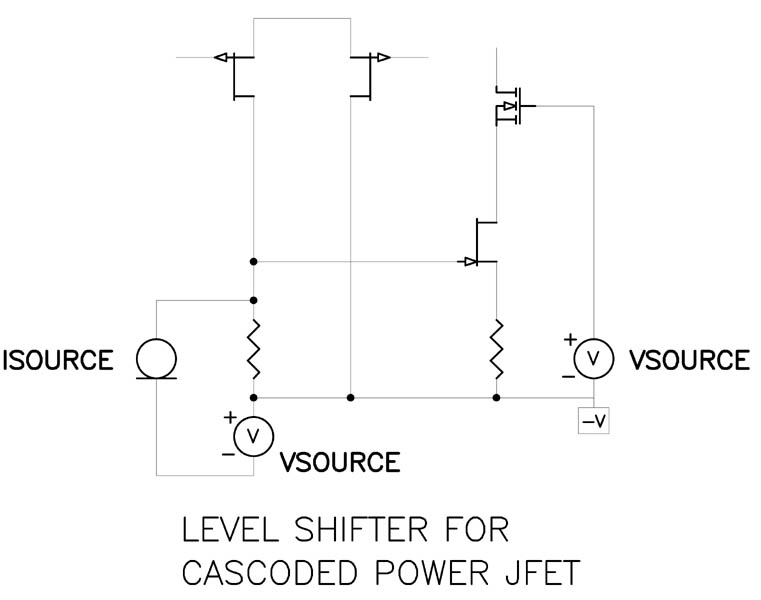

had some fun tonight with Aleph J Sonyfication, of course just in LTSpice
need to check latest Sit data thread and my files, to see how far I'm from melting
EUVL's solution with aux neg-neg rail and small CCS is working as charm in Spice, no doubt it'll work in vivo, but I'm not exactly happy driving VFet gate in A2 region with puny 2SJ74BL drain directly, so some additional complication inevitable
now , polylemma- tossin' on ya, in few days, what I have in sim .... or trying at least simplest solution EUVL gave, to decide do I like how it sounds...... or to make proper ikebana proto on T-Bed .......

[...]so some additional complication inevitable

I was wondering if your complication involve also adding cascode... you know NFB :)
Mr. Pass added 22k on the JFET gate, using I assume JFET input capacitance as a LP filter to prevent oscillations...

yeah, cascodes for input JFets are already customary for me, you know - ZM Chicken
also, nested current mirror in between input LTP and rest of circuit, to isolate weeny JFet, and increase gain without too much fuss, there is no other way to compensate missing gain than gaining the same ( gain :rofl: ) in sole place where you can ...... without that, OLG dropped down to simple SET territory, that's no good
VFet gate modulation going deep to A2 Class ( again tube domain classification) which means positive Ugs, which means inevitable gate current, which simulation is not showing
eh, you can't expect everything, especially counting on fact that nice ppl who gave us free models, did that job for free
