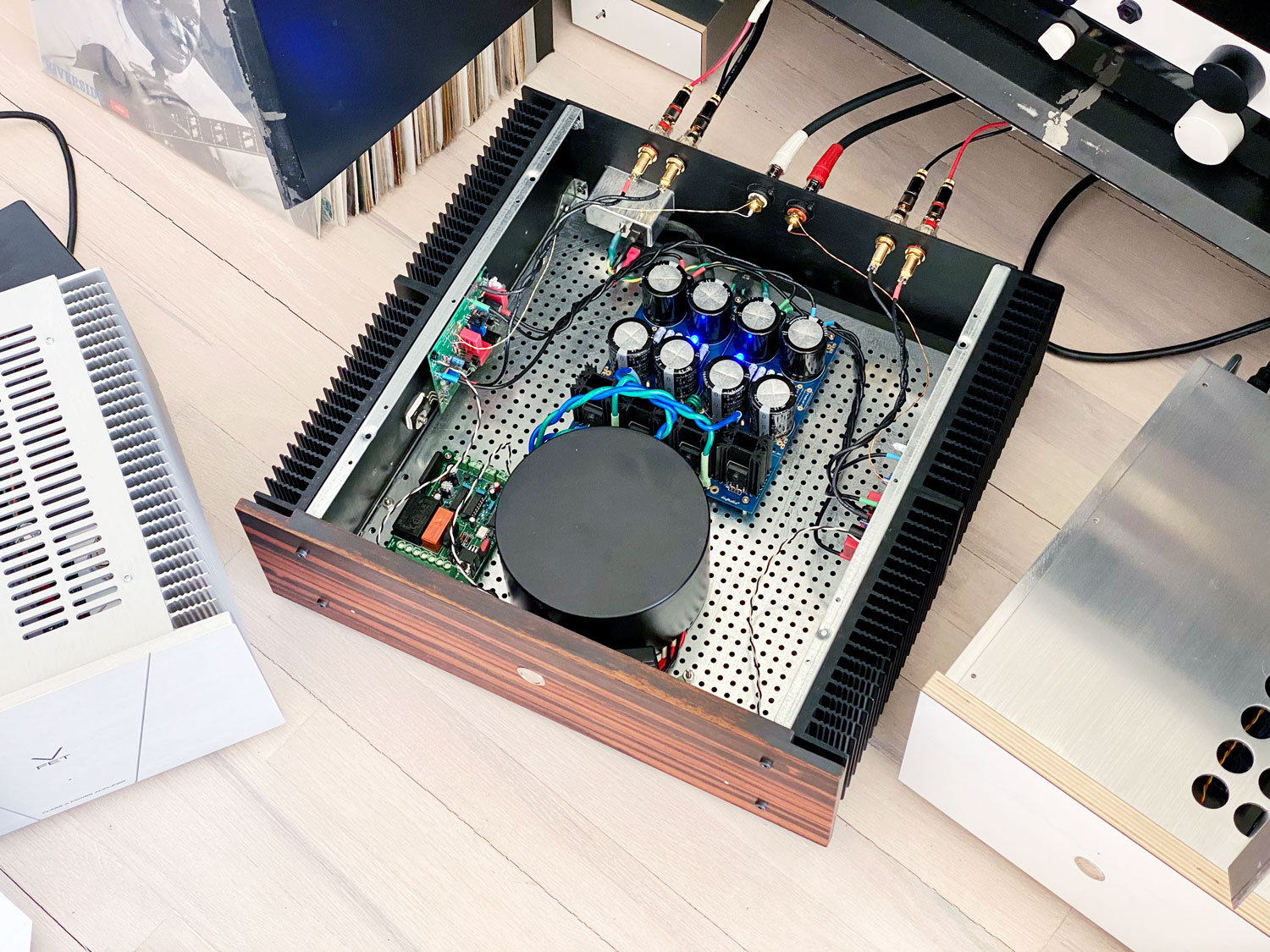

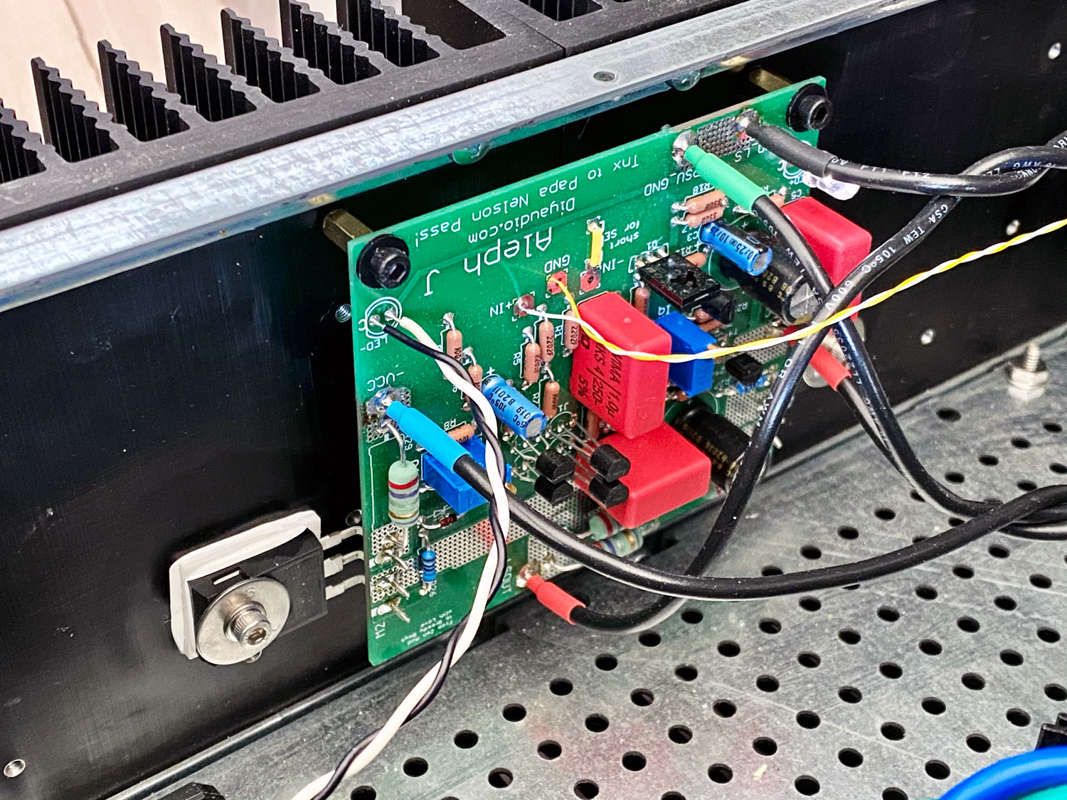

For me, it's like having an old friend over for dinner that I haven't seen in ages... I have missed this amp! AJ was my second amp build ever after F5. It was audio heaven—lot's of lush editorialization perhaps?—but I soon realized the amp wasn't quiet at all—After a lot of learning and experimenting—HBRs etc—Nothing would solve the buzzing...I moved on to M2X... and that's been incredible for learning and audio awesomeness.... but it's a different amp (it's a GREAT amp—we are afterall comparing Ferrari's—thanks to 6L6 for pointing that out to me one day).....
So here's my original AJ PSU and trasnfo and chassis, and with a couple of new holes tapped—and some ZM magicalness—and YES! YES! YES!
I'm seeing AJ ZEN monoblocks in my future. Might derail my BA-3 build. (also NEED to get SISSYSIT right channel working, boo.)
THANK YOU ZEN MOD!!!!!! (And Nelson 😀). I am truly honored to have such creations in my life everyday spreading love and joy. It was a pleasure to confirm the sweet sweetness that is the AJ Zen.
Vfet and AJ Zen cohabitate-ing — I must be VERY fortunate — Keith Jarrett on solo piano on vinyl never sounded so good (and Coltrane, and Miles, and Wes, and The Duke). So big and bloom-y and tube-y? I don't know. There's nothing not to LOVE about this amp. Maybe I just take my music with a healthy dose of MORE.
A birdie also told me that the boards are already in v.2—we LOVE a motivated ZM!

ZM: 1000% success on both fronts—YES. Assuming PSU is good, first fire up... Set offset, 0 easily achieved. Set Iq, .45 on initial fire up, dialed down to .35, let cook with lid on for an hour. Readjust Iq, dropped a bit to say .34. Recheck offset, still 0. I let it cook another hour. Stabilized at .35 Iq, Offset still 0. Good enough for me, dead easy. Been listening most of the day. LOUD. Simply love this amp. Maybe 105F on sinks... Same on Mosfets. My original AJ always ran cool though... not that it’s relevant. All twiddles on dials very stable and predictable... no drifting. Just lovely. 😀

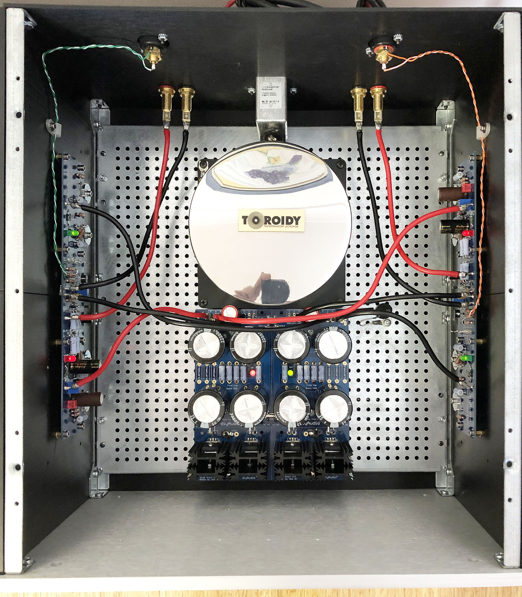

Well, I have to say I am still not happy with my Aleph J. I have built ACA, M2X and F5 before and all went perfectly well, but one of my Aleph channels happens to be a bit whimsical.

My journey with Aleph started with a hickup as I did not used good thermal interconnect on mosfets, so for a few hours my mosfets (and especially this bad channel) ran at quite high temperatures (I did measured close to 150C at some short time once, and this is at the case). Overall looks like mosfets survived and now, after changing to aluminum oxide thermal pads, they all run at about 50C at case, and voltages on R16-R19 are ok (434, 390, 415, 415 mV respectively), DC offset is also fine (+- a few mV when the amp is warmed up).
What could be the reasons of this high THD and intermodulation on this bad channel?
Where should I start my investigations. Being a noob, I hope for some guidance.
The voltage drop of 390mV points that either a MOSFET or a resistor are damaged. Or both. However, I would replace all MOSFETs and all 0.47ohm resistors due to exposure to excessive heat.
You can get a tube (25 MOSFETS) from Mouser or DigyKey and they'll all be matched. Just state on your order that you want them transistors from the same tube (same batch).
I suggest that you match those 0.47 ohms resistors. I get discrepancy in the 3rd digit; for example: 0.478, 0.477, 0.476, 0.475mV... but I matched the 0.47ohm resistors from a bag of 50.
The mains wiring runs in parallel with speaker wire (for about a 3rd of the total length) and in parallel to DC wiring. This is not good. You have 2 options:
- keep the current placement of the transformer and the power supply PCB, but run the mains wiring straight to the transformer, through the middle of the AMP PCB and then through the middle of the transformer (away from everything else). Even better, run the wiring between the bottom plates (just put some shrink to ensure no shorts!!!). But still, make sure you run the mains wiring in the middle, away from AMP PCB's.
- re-arrange things! Have a look at the photo I attached. Mains wiring length is 10cm (including the CL60!) It is completely tucked away between two metal plates as well. The layout also ensures the shortest possible DC wiring length.
You are also using borderline capacitance required for Aleph J. I think I read 18,000uF capacitors. It will be difficult to change the caps now....so your other option to tame the buzz is to do a ground lift mod. I think this is a must in your case (18,000uF caps and single-ended inputs).
