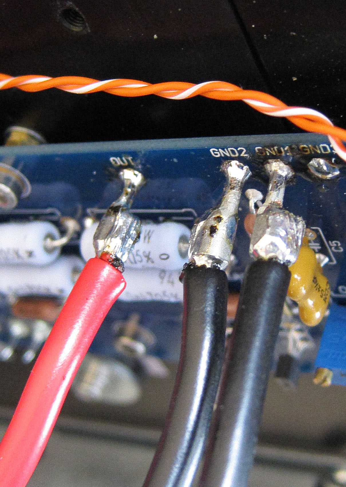

Extreme_Boky is right.
That primary wiring needs to disappear below the PS PCB (I think he meant PS PCB, not Amp PCB).
Your current filtering caps may not address the amount of ripple in this Class A design.
Where do your ground wires from each amp PCB to the PS board go? Are they on the same side? You should choose one GND side.
Do I see (2) chassis grounds? The electrostatic shield (yellow) wire goes to one part of the baseplate while the PS PCB/Thermistor goes to another. Try to make it all the same. Use thick gauge ground wires if you can.
Keeping the input RCA’s next to each other and bonding the ground tabs together would help but I think that is impossible in your build.
You can use an L-Bracket on the toroid (mount it vertically) and see if that helps. Changing the orientation of the toroid (move clockwise or counterclockwise) can also help. Move any and all primary wirings as far away from the Aleph J main amp board. You may need to move your white 3 terminal board that holds your thermistor/cap as well (closer to the toroid).
See Andrew Russell’s/Hifisonix’s writeup on proper elimination of ground loops and the like.

Thanks for all your comments, @Extreme_Boky and @poseidonsvoice.
I am very much convinced already that my problem is due to the scorched MOSFETS, so I already making plans and calculations what is the best way for me to change them. I will also look at the power resistors when doing it. Anyway, the big reshuffling of my Aleph is going to happen, so thanks for all the other suggestions as well.
I've read about dealing with hum and buzz a lot before and was also "playing doctor" with my amps with the headphones on the outputs. Still find it being very much a witchcraft - trying all these small miniscule differences to get the result. On the other side seeing others having quiet amps with all these bad errors that are supposed to be eliminated. But please don't take it as any critique or something from me - I am quite a novice and therefore I am very thankful for all these suggestions that I will have in mind when rebuilding my Aleph. Special thanks for the reference for the HBR installation!
On the other hand, I got a PM from 6L6, who promissed me more info about the Zen version (and even the PCBs!), so I'll see what happens first: I fix Aleph J or make Babelfish J version :) - both ways will add a lot to my learning :)
