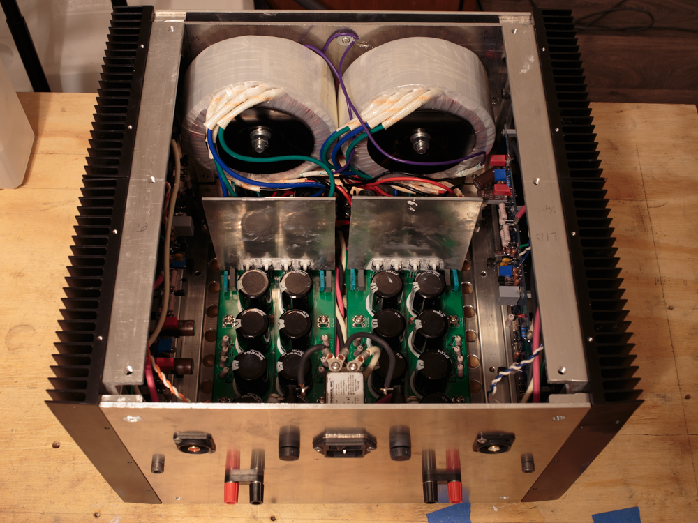

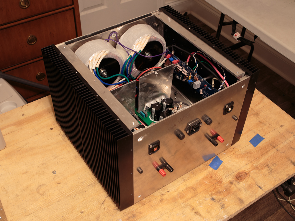

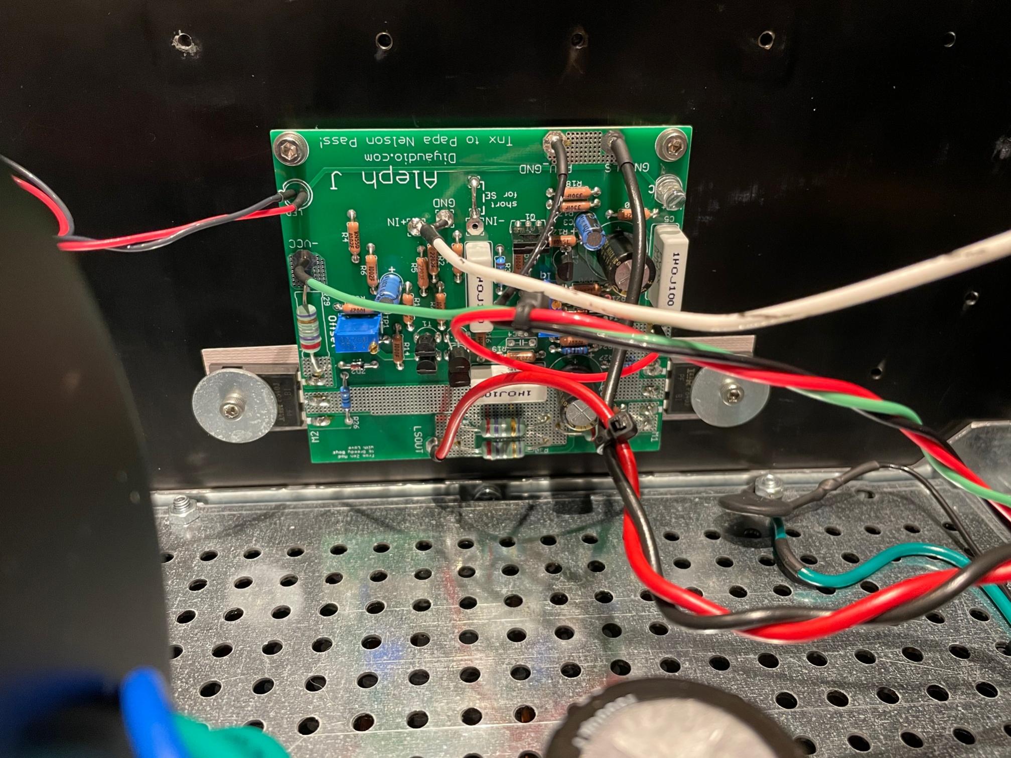

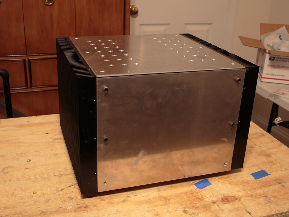

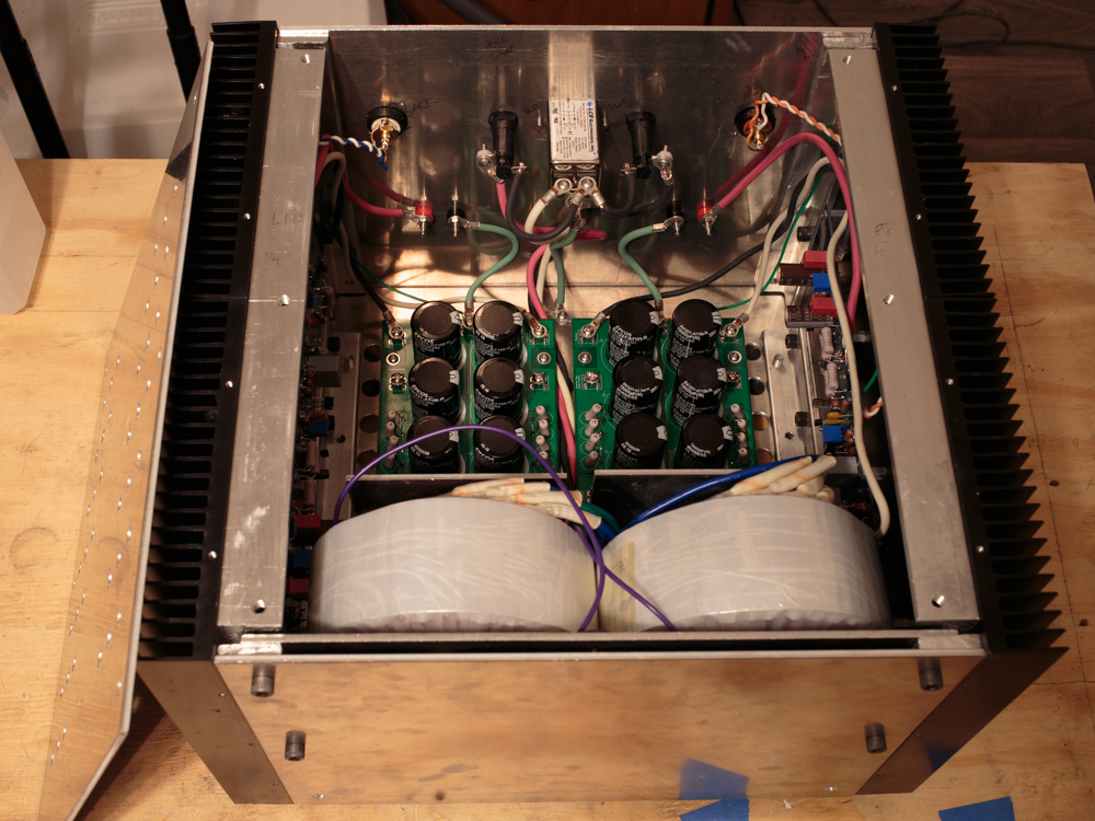

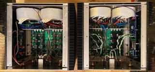

Finished AJ
Over a year ago I embarked on a journey to design my own Aleph-J variant for a giant, four-sided heatsink in the style of the Aleph 0 chassis.
Thread: Aleph 0 layout for Aleph J
I got as far as wiring everything P2P and plugging it in - but it was a rat's nest of jumpers, questionable soldering, and new circuits (I also had a P2P capacitance MX that let out some smoke...). I was NOT prepared to troubleshoot my way out of that corner.
After setting that project aside for a bit, I scored more, nicer heatsinks on eBay, and set about making a chassis to fit the UMS pattern.
I ended up building the M2X first. (Link in sig)
With newfound confidence and enough raw material to build another UMS-compatible chassis, I returned to the Aleph J using the store's UMS boards. (Dual mono w/ AS-4220; 28V rails)
I was happy to find that it fired up without a hitch! Makes music. Thankfully, the problem with the last build was my implementation, and not the jfets.
...well, there is one minor hitch. I forgot to jumper the vertical R27, so the bias pot isn't connected to the gates of the current source - the bias is running full steam at about 1.3 A per mosfet. I went ahead and tossed the panels on (as shown) to see how the temperatures worked out - and the mosfet mounting bolts are right at 65 deg C. When I feel like pulling it all apart again, I'll likely solder in the jumpers to bring the bias down a bit, but for now, the temperatures are manageable.
Last picture has the M2X on the right.
Now, I still have those four heatsinks from the original chassis - more room to build!
