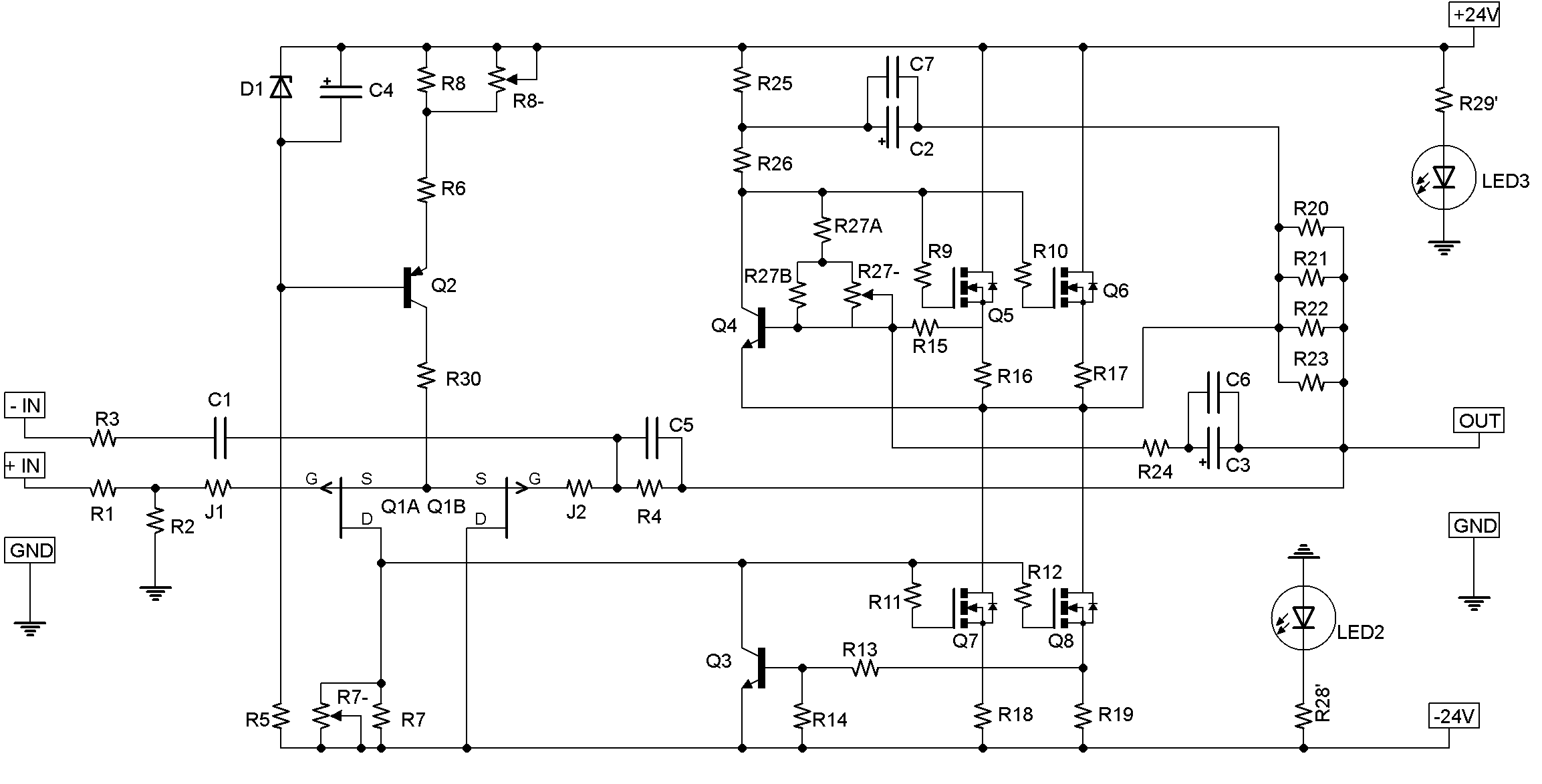

Looks interesting..well, I almost forgot
here's what I came with, several nights ago
didn't look at it afterwards, maybe will tomorrow, really interested to see how much stupid details I succeeded to push in
can it be done simpler - yes
is it worth hassle- at all ........ nope - I think
I think the circuit needs more room to breathe, allow possibility for setting different Vds load lines.
So at least +/– 24V on the power rails, maybe 30.

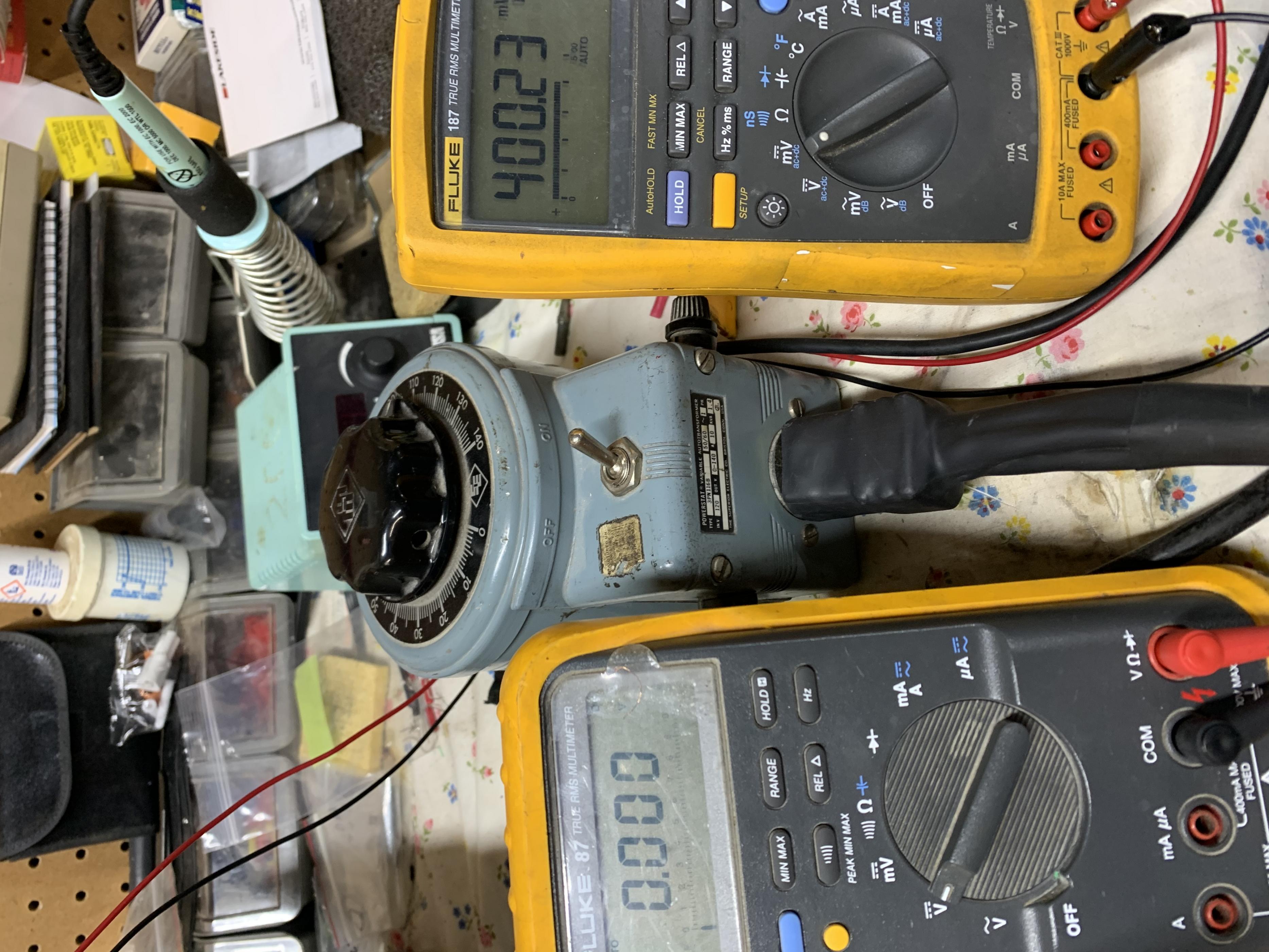

I am playing the MOSFETs matching game. Ordered a tube (25 units) of IRFP240, though Mouser could not guarantee that they will be from the same batch.
Anyway, my simple setup is in the picture:
- PS wallwart is rated 12V 800mA though in reality is gives about 14.10-14.40 V under the load. I also understand that the other day this could be different as it not regulated.
- resistor is 60 ohm, 1%, 3W (gets quite hot under ~2W load).
Measured just two MOSFETs yet. Got 4.01 and 4.02 Vgs after 30 seconds.
If I keep it longer, I see Vgs falling down to 3.98V in 1 min., 3.97 in 2 min., 3.96 in 3 min.
MOSFET itself gets just a little tiny warm in 3 min. (running at about 170mA Id).
Does all this makes any sense (without any thermal measurement/control)?
How long should I wait before taking the Vgs measurement?
Or is all this just monkey business?
Trying to match transistors for the first time, so any teaching would be appretiated.
Thanks.
- Alvis

Alvis,
What you're seeing sense.
The main thing is keep your mosfets at the condition when you start, and do
your measurement at a consistent time. (I would go no less than one minute.)
You're not looking for absolute measurements, only to help you select pairs
that are reasonably close.
Dennis

Thanks, Dennis!
Checked all 25. Measured Vgs after 3 minutes.
18 fell into 3.96-3.97, 6 into 3.93-3.95, and one was at 4.00 Vgs.
Do numbers in the circles in the corners of the case have something in common with the batch number? In my tube I had several "series" like 01 08, 02 08, ... 08 08, then 01 12, 02 12, ... 10 12, and 05 01, 05 02, ... 05 05, and that one with 4.00 Vgs was 12 04.
Overall, Extreme_Boky was right when he suggested I will find plenty of pairs from the whole tube. Thanks, Boky. (Though Mouser did not guarantee that they all be from the same batch, and they were not exactly from one batch as I understand).
Anyway, two small questions remain - will they behave the same at 800mV in Aleph J as they behaved at 170mV in my test? I think I will have to check that in the circuit 🙂
And when speaking about the matched pairs, do I understand correctly that the pairs are Q5-Q6 and Q7-Q8 (schematics attached for the quick look)?

I suppose that now you have a full appreciation of what I posted few pages back...
the heat dissipation at higher currents is a problem.... you need a temp. controlled environment, large heatsink.... the BEST is to try and do it... you'll understand 🙂
I think that the 2 groups of MOSFET's can be used without any issue, apart from that one that measured at 4.00Vgs.
The 2 groups are matched perfectly. The measured difference can be attributed to the multimeter reading/measurement tolerances, contact resistances and temperature variations.
This is exactly what I found when I checked my tube.

Thanks, Boky! I always had the highest appretiation of your posts! 🙂
What I learned from this activity:
- Mouser do not guarantee the same batch even if you buy a full tube,
- Mosfets in a tube are still quite similar (except some - and that was good, I could see that my testing jig really gives different results in some cases 🙂)
- testing with low currents (up to 200mA or a bit more) is easy, with currents close to real usage (800mA or more) - difficult thermally.
Nice learnings! Thanks!
-Alvis
