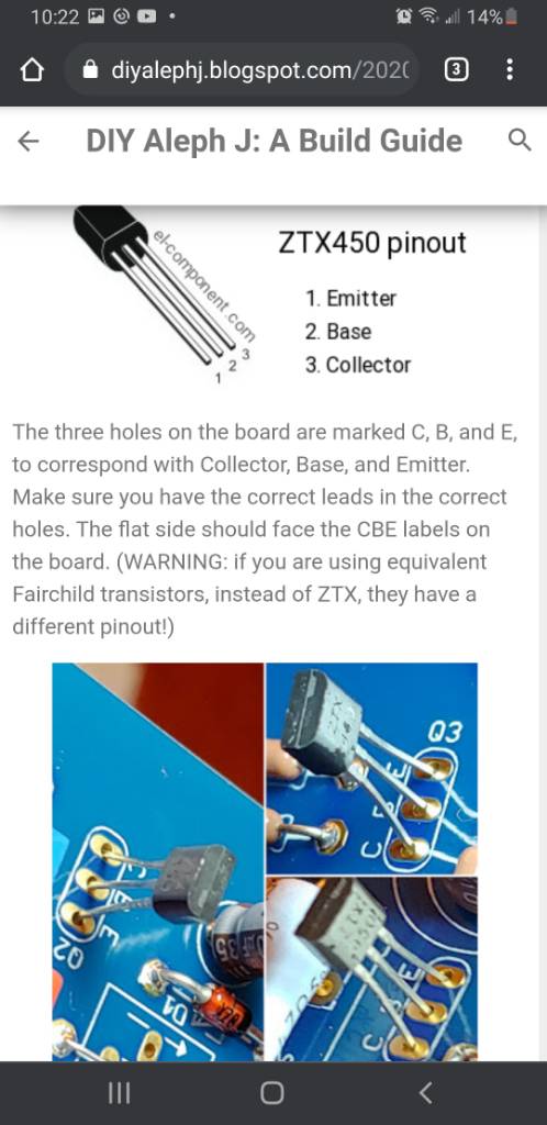

The flat side of j fet faces CBE printed on the board on q2 q3 and q4. I hope they are correct.

Thats what I did. Just like these in the build guide.Jfets should both be lsj74....if the flat side of the ztx is facing you the leg on right is C.
