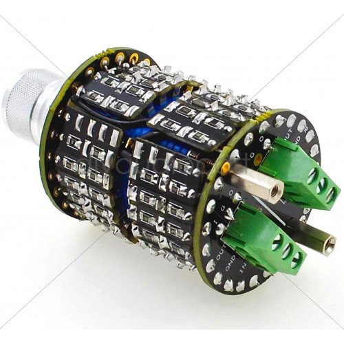

My advice is to use a stepped attenuator instead of an normal potentiometer. I have tried both, my potentiometer though high quality (a motorised TKD Potentiometer from Hificollective, so not a fake ebay pot) is not as good as the stepped attenuator and there is so much a difference in sound. Both are good, but a and b-ing the stepped attenuator has far better sound.
For reference, I have these:
The TDK pot:
TKD CP-2511, 2CP-2511 & 4CP-2511 Series Potentiometers | Hifi Collective
The Stepped Attenuator:
Search | Hifi Collective
That sounds like good advice. What value are you using for the overall attenuator? 100K?
I don't think I can afford those ones you list. There are Dale filled attenuators on Ebay for a fraction of that price. And the boxes previously recommended were only $50 each. That's my budget anyway.
So maybe just fit a 100K pot in line and see what happens?
Yes, I have 100K, though it was actually originally bought to match a tube amp I built but reading something that Nelson said a while ago they should also be OK for the Apleph J (maybe someone can correct me if I interpreted wrong). In any case, I use this 100k attenuator myself and it works great with the Apleph J.
If they are genuine Dales, then the ebay ones should be good. My personal opinion is that even a lower quality attenuator is better than most pots, especially if shunts or the more expensive ladder types (mine is a shunt).
OK so I got a pair of these which are dual attenuators.
1PCS Assembled Dale 23 Step Attenuator 2-Channel Volume Potentiometer 100K | eBay
Looks good, assuming this chinese attenuator is using genuine Dale resistors.
This is a series type attenuator, and as you turn the volume down, more and more of the resistors are inlined in series, rather than swapping increasingly resistive resistors in as in the ladder and shunt types. This may result in slightly more noise floor level as the volume is reduced, but doubt that this would be audible at listening volumes and distances.
