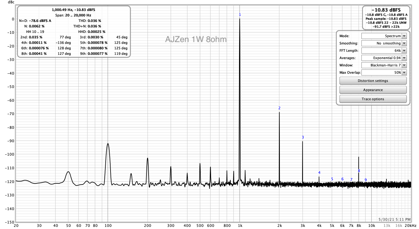

And what a sound it is! THD spectrum attached at 1W and 8W at 8 ohms. Total THD at 1W is just 0.036%, and 0.035% of that is 2nd harmonic.
And what a silent amp! Nothing but the music. No hum/buzz at all with 96dB Klipsch loundspeakers! The most silent amp of all the FW clones I've build so far! Nothing, nada, zilch in Zen speak
Thanks again for all who made it happen!

Setting was easy (but I never found it being difficult with any other apm either). I started with trimpots set to the middle. It corresponded to about 1V5 bias current after initial warmup. So I just had gradually increase it to my desired 1V6. Same with offset. Nice and stable.
But it's something else what I liked most about your version, Zen Mod. I have a feeling that Papa makes his genius designs biased to his so well filled and matched stash of parts: lots of Toshibas, lots of mached MOSFETS etc. This makes life for us, simple Greedy Guys, interesting, but a bit more complicated. And you took Papa's idea and looked at it from a bit different perspective - no matchings, cheap and easily available parts (except Jfets, unfortuntely). Also nice thing about the PCB was included place for the GBR and convenient jumper for SE input. This is what I liked. Same good result, as you say, but with less hassle!
