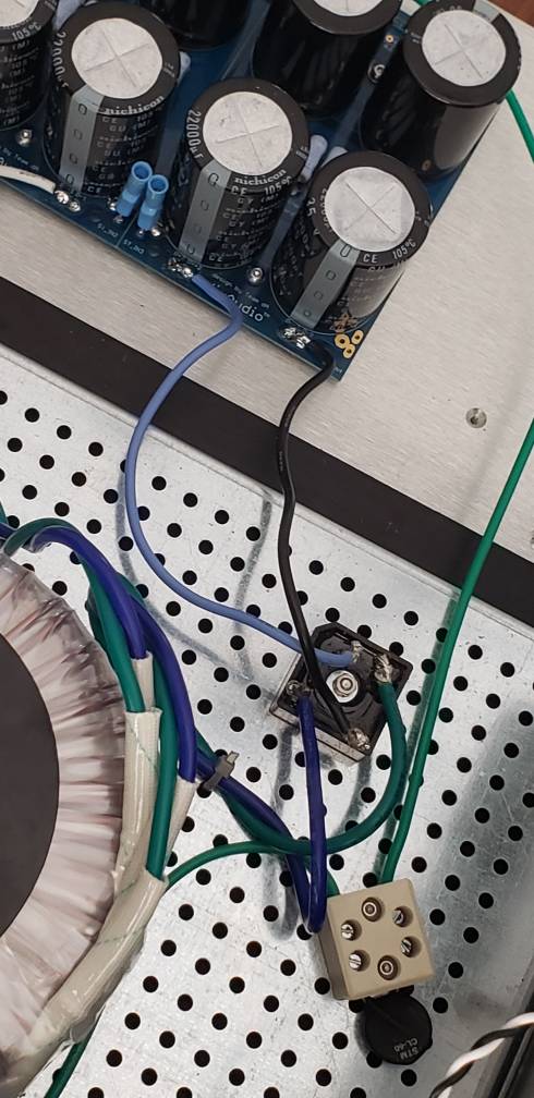

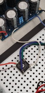

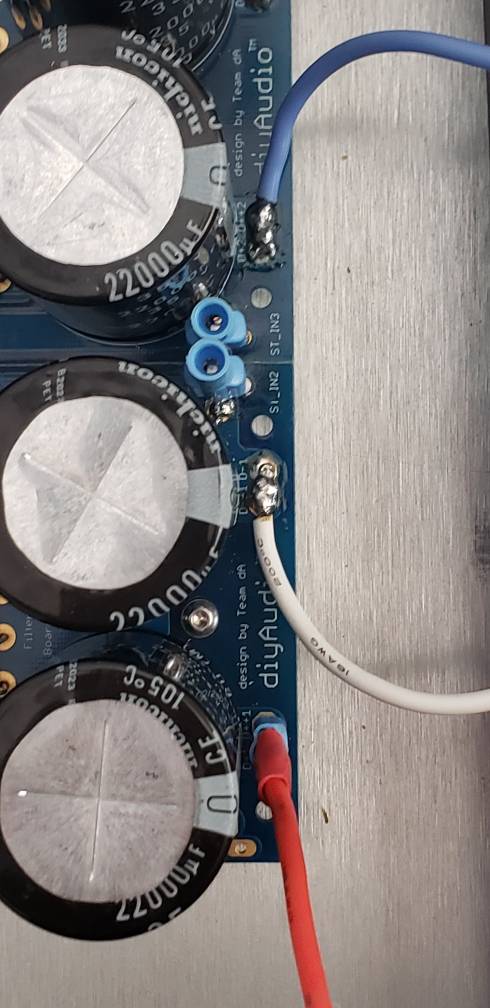

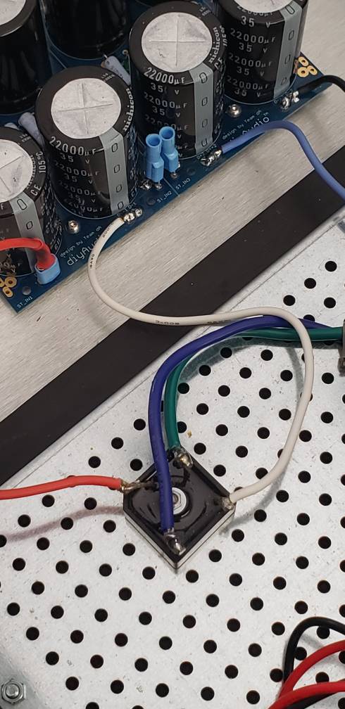

I hope you have the grounds linked on your power supply board. It is not clear in the picture as you have those blue spades there and the large caps are obscuring the view.
Here are examples:
https://files.diyaudio.com/archive/gallery/data/500/medium/PSU211.jpg
https://files.diyaudio.com/archive/gallery/data/500/medium/PSU26.jpg
How everything in the PS should be connected:
https://www.diyaudio.com/archive/gallery/data/500/IMG_2182.jpg
Please thoroughly look through page 1 (and particularly post#1) of this thread:
diyAudio Power Supply Circuit Board v3 illustrated build guide
Best,
Anand.

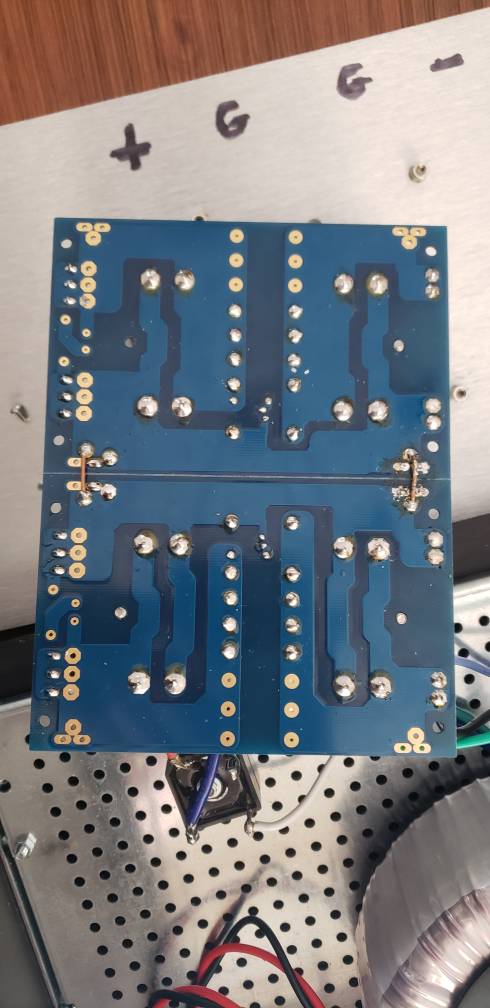

Joined 2019
KP -
Those are certainly not the cleanest joints I've seen. However, I would focus your efforts elsewhere for the time being. Your PSU seems to be functioning properly. Neat idea to swap left to right, but why'd you do that?

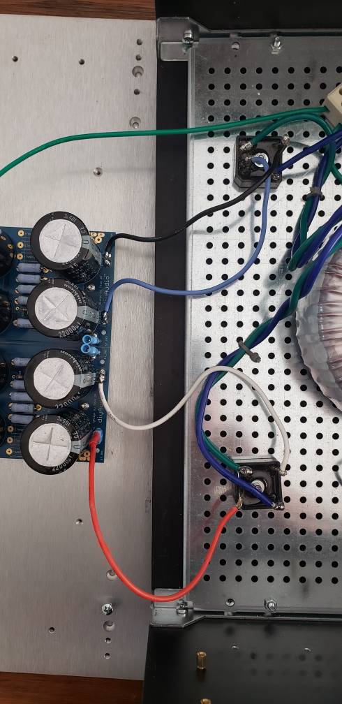

I was hoping to see if the power to the left side of the amp was a problem.
Since it quit making music I assume thats the issue somehow. Now both boards need help.
Is this wired properly? View attachment 956604

Earlier you wrote that you had 1.8mV across R7 for the left channel board so the jfets
again could be the issue. The soldering looked questionable and there I also saw a fair bit of residue that may have been a problem.

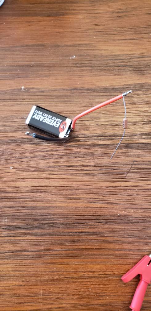

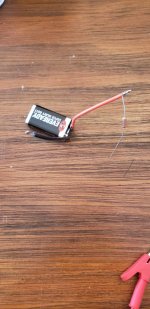

Since you've removed the jfets from both boards, can you test them as Zen Mod suggested in post 6646:
https://www.diyaudio.com/forums/pass-labs/241729-aleph-illustrated-build-guide-665.html#post6675397
You can use a 9V battery and in place of the ammeter, put in a 100 ohm or so resistor and just measure the voltage drop across the resistor.

I am trying to figure how to do this test.
Its reading 9.83 volts with a 93 ohm resistor

I've attached a drawing of the setup. The voltmeter should show a voltage
proportional to the Idss of your jfet. For example, with R=93 ohms and
if the Idss of the jfet is 8mA then you should see about 0.74V ( 93 x 0.008) across the resistor.

Ok Dennis finally home from work.
Thank you for the diagram.
JFETS measure : 1 pair .744v and the other pair .745v
Is this is what we would expect?
Joined 2002
So, with R=93 ohm, you measured all four jfets and got 0.744V, 0.744V, 0.745V and 0.745V.
This is good. You have 4 well-matched jfets with Idss at 8mA. If you got the 7-9mA quad from punkydawgs then this is right down the middle.
So the jfets are probably fine.
