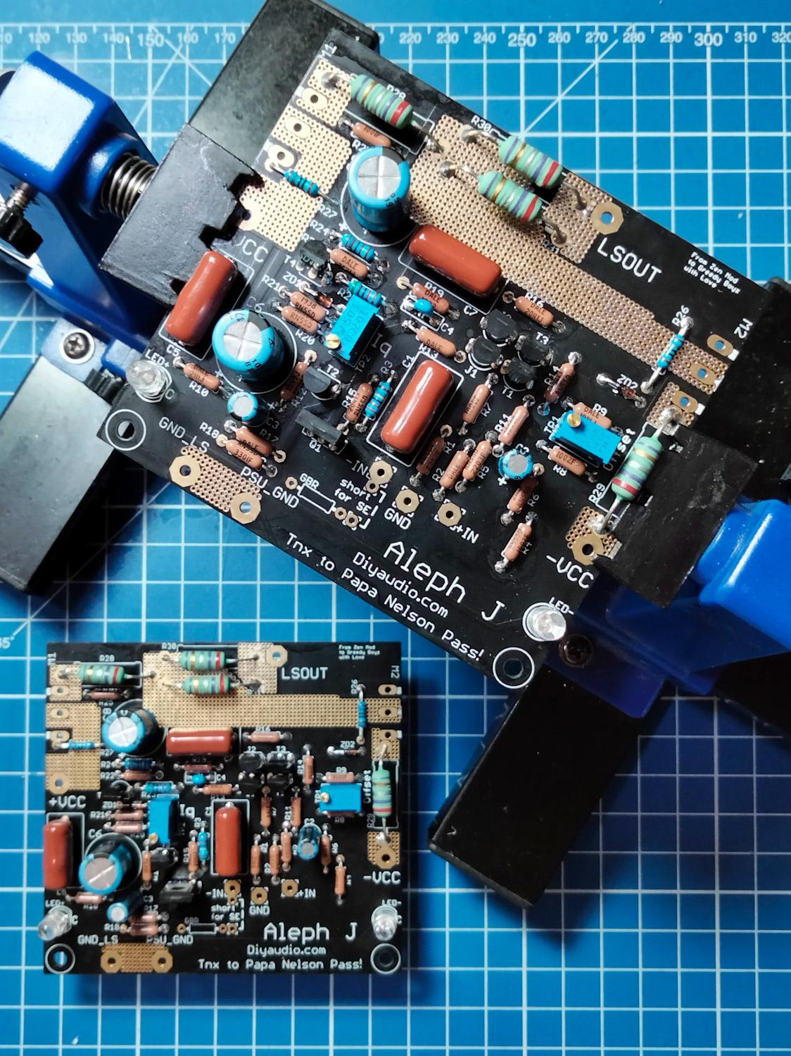

Looking great! Love the board in black! Can't wait to hear your thoughts on it after it's playing music!
Mine has been getting hours of love every day.

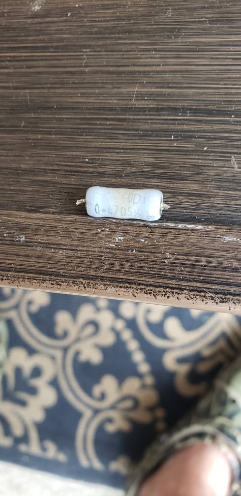

New Jfets coma in and fixed the problem of no voltage across R18 on both boards.
I was able to set Bias and DC offset on the left. So yay for me.
Now the right channel is not adjusting when turning the Bias or the DC offset. The heating on the right side is noticeably warmer than the other side. The R 7 pot is measuring 5.5 volts.
When the amp gets warm after just a few minutes R17 is starting to turn a brownish color and I killed power because I started to smell a component heating up.
I replaced R17 and again had to shut things down because the new R17 was doing the same thing.
Any ideas where to go next?
What are the Bias and DC offset pots not adjusting?
