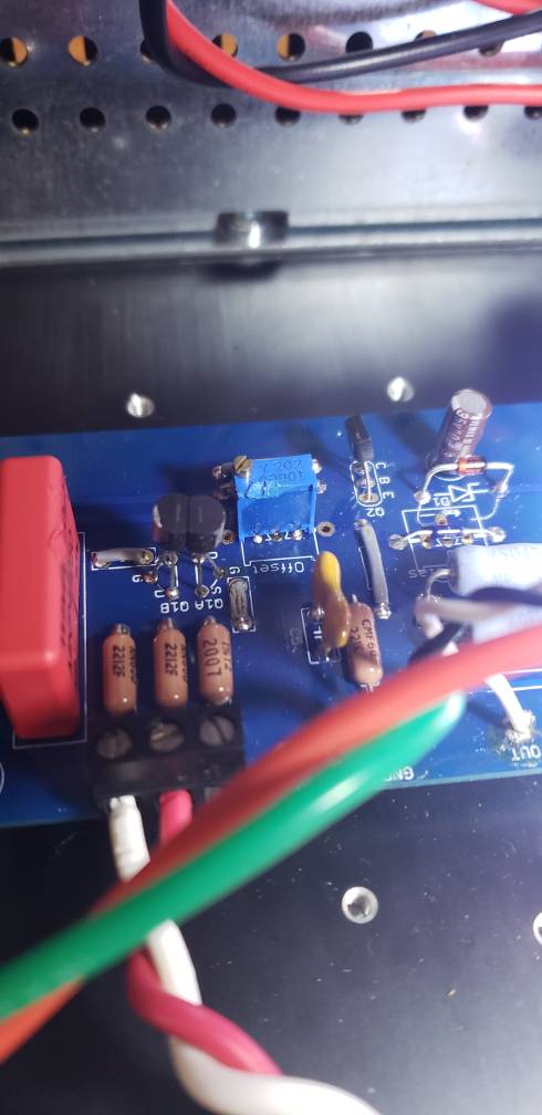

Anand i took out the right board , carefully inspected keratherm. I cleaned the heat sink with alcohol. When I turn on after a minute I can smell the heating on the right side.
R17 seems to be overheating by the looks of it. Perhaps I should have replace it again.
Upon inspection during the Jfet replacement twice the soldering iron slightly melted the R7 top part of the blue case. Could this be the problem? 20210607_111209.jpg 20210607_111124.jpg

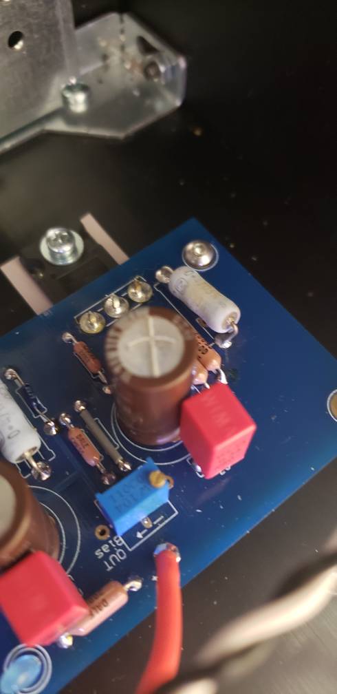

Troubleshooting question.
If R7 potentiometer is bad, seen in this picture, would it prevent R27 from being able to adjust bias voltage? I have accidentally touched it with the soldering iron when swapping Q1A and Q1B twice. When turning on the amp I am getting 400 MV at R18. This number begins to rise quickly when the amp is on and that is causing R17 to overheat.
Adjusting R27 potentiometer does not reduce the voltage at R18 as it is supposed to. 20210607_111209.jpg
