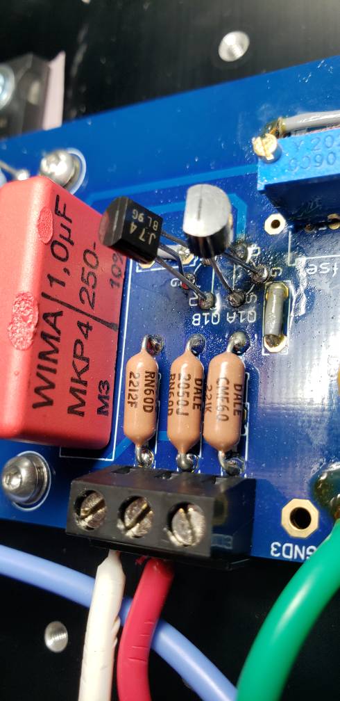

I am curious so I started taking pictures and the right channel has matching description of J74 BL4C. Keep in mind this side was making music.
However upon inspection the left side was J74BL9G.
Is this the culprit yet again?

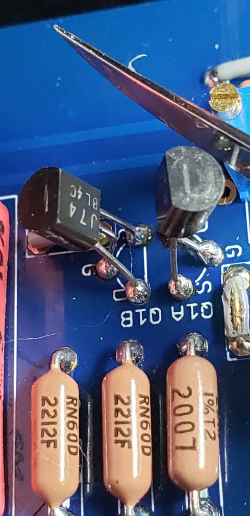

Well the toshiba transistors came in.
I installed them quickly with excitement.
The right channel went according to plan with the bias adjustment and the DC offset.
Then I moved to the left channel and the bias adjustment went ok but the DC offset the meter kept dumping around but it was hovering near 0 give or take a couple milli volts. So I turned things off and hooked up my speakers. When I turned on the amp I heard scratching from the left channel and the right side was music at last.
Is this the culprit yet again? View attachment 956333 View attachment 956334
that is bad soldering of JFets
too much solder, thinking that you maybe scorched something (heated them too long, trying to push solder too much; there is misconception often, that each and every through-hole part necessary must have same amount of solder on both sides of pcb; more critical for high current parts, but for small ones mostly irrelevant - metalisation of pad holes is glorious thing, per se)
resistors beside are looking as neater soldered - nice concave forms
edit: on second look, resistors are similarly soldered
post better pics, where Boyz can see all details

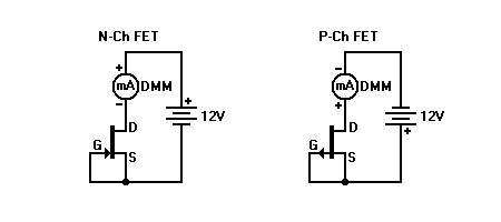

if nothing suspicious can be found, desolder (quick and efficient!) JFets and check them with simple matching jig
9V battery will do as voltage source

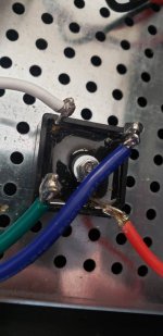

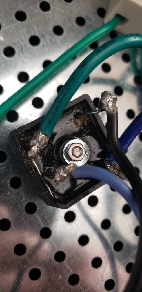

On the right side rectifier there is continuity when testing diagonally across on the AC side with each other and the DC side with each other. This side is working and making music.Yes that is correct. I turned off the amp and came back a few minutes later and now the left channel that was scratching is now silent. I go back and remeasure bias pot to R18 and now zero it reads zero volts again.
Right side is ok View attachment 956361
On the left channel rectifier I have continuity on the AC corner to corner diagonally but no continuity on the DC side corner to corner.
This channel is not playing music.

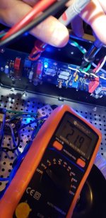

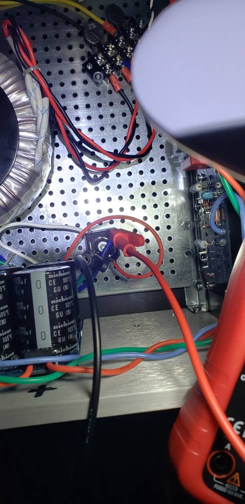

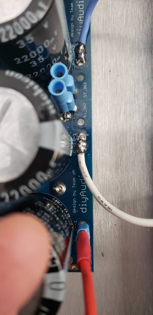

I'm not sure what the rails are?remove both rails from channel pcbs, test PSU voltages first, confirm +24(ish)Vdc, -24(ish)Vdc
When placing probes on the power supply board euroblock connector screws i get 21.9 volts on positive to ground and negative to ground on both sides.

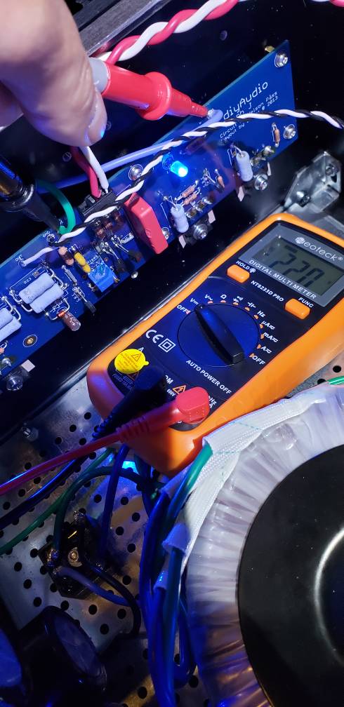

R7 measures only 1.8 mv on left.
R7 measures 4.82 on the right.

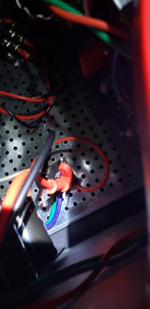

Kinda tricky photography but I think I got a good shot.when black probe is on GND, can you confirm two power wires coming from PSU to channel pcb having +21.9Vdc and -21.9Vdc?
post better pictures, so we can see properly entire pcb (and all of them, including xformer and PSU pcb), with wires and everything

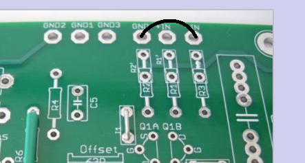

I am using XLR and grounded it to chassis on a screw next to xlr input.An observation.. When we use an SE input with this amp (normal RCA connection) we need a jumper as shown in this picture. I am unable to tell if that's been done here with your pcb's.
Right channel is done the same way and its working.

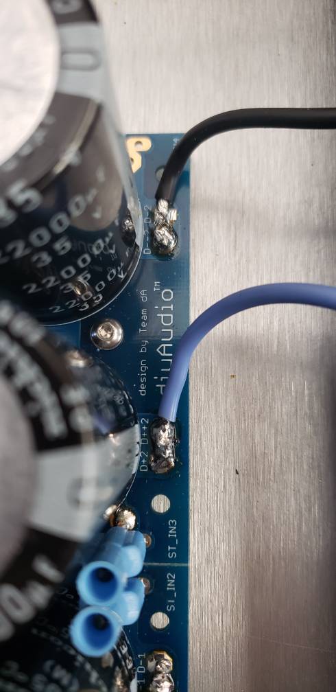

I had the bright idea this morning of taking both amp boards out and putting the working right channel on the left side of the amp. I powered it up and it was playing music for 30 seconds then poof. The sound disappeared and I noticed a small amount of smoke coming from the board. I immediately powered off. I went ahead and desoldered q1a and q1b from both boards and ordered another matched quad of J74 jfets.
I am thinking I need to redo these connections.
On these rectifiers I have soldered to the leads but want to get the spade connection type if this can be a potential issue. Also need to get spade connection to the power supply board.
Any thoughts about these issues?
