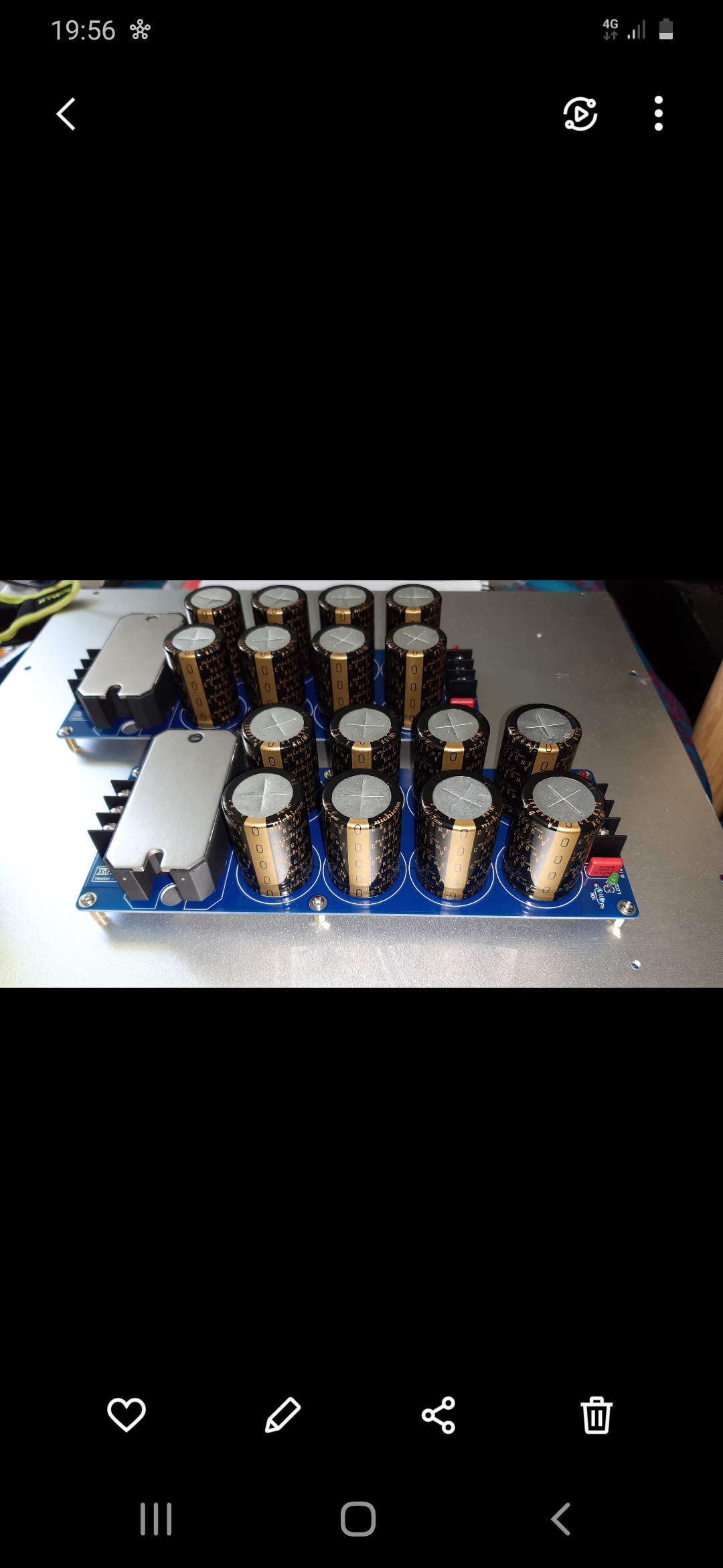

Here is a annotated board that I did a while back(Not my board but a great looking one), Please use with caution as not sure anyone but me has proofed it. I am still working with same problem of populated board and which component is which. Good luck. Lots of good help here. C6 and C7 have no components installed yet in picture. Picture is still useful.
I proofed it.... they are my boards. 🙂

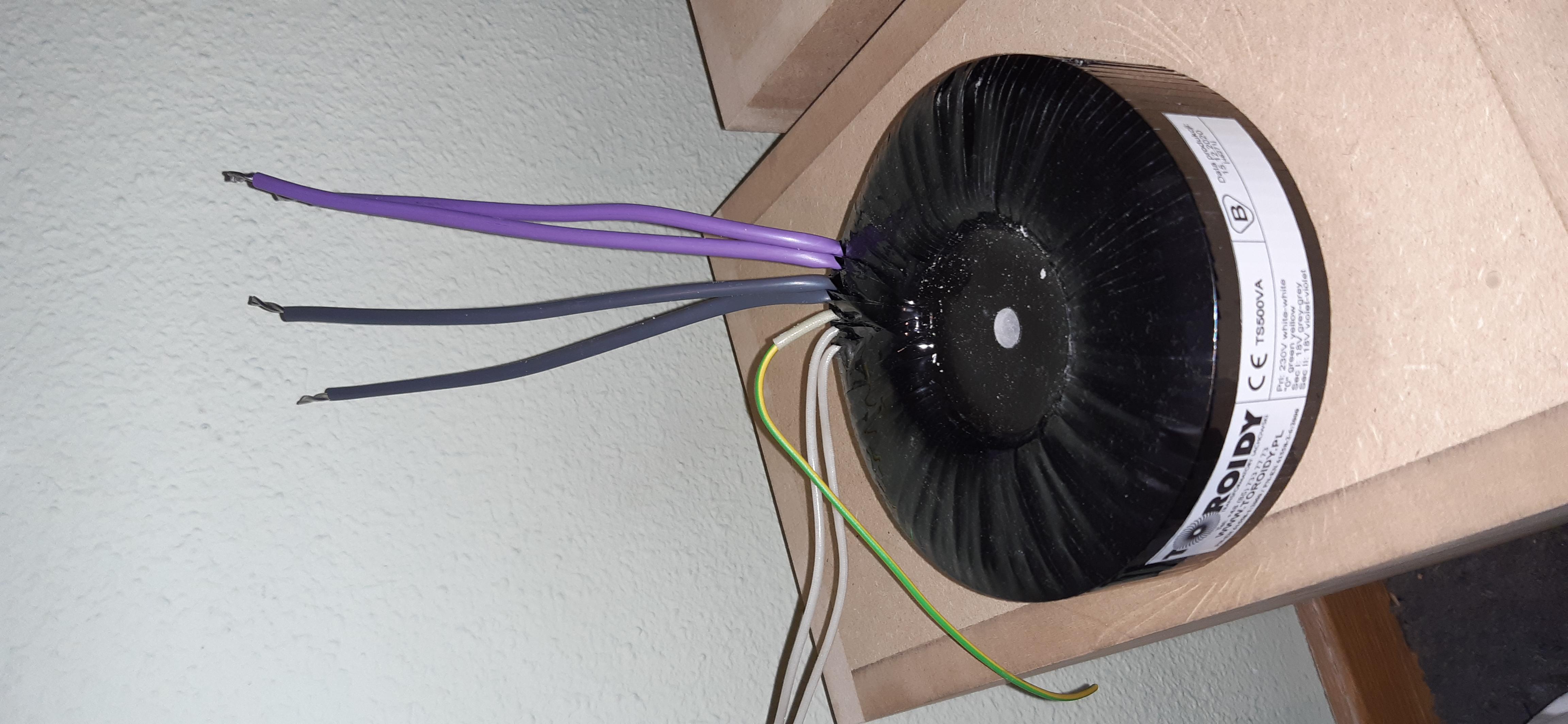

I hope you can help me, I bought a 2 x 18-0-18 v Toroidy transformer audio grade for my aleph J. I really recommend it, is absolutly silent and quiet all performs one step more.

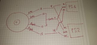

I bought other transformer for build other aleph j for a friend but I have 2 x 18v (4 wires) without gnd.... Is possible use this transformer or I have to bought other new 2 x 18-0-8?? I can connect for find one gnd but I have 36v in the two wires and as you know web need dual centered 18-0-18... not 2x18 😕
I think use ground and chasis like gnd but I think is not correct... thanks for your support....

The 2 x 18-0-18 v Toroidy how many secundary wires has it? 4? 2 times 18v (thick wires) and a thinner (yellow/green?) wire? The yellow/green is connected to an internal shield between primair and secondair. Connect this wire close to the transfo to chassis. This wire is not shown in the schematic above because it is optional. If I understand correctly, the other transfo hasn’t the optional screening, but can be used. (You make ‘gnd’ yourself in the PSU board.)

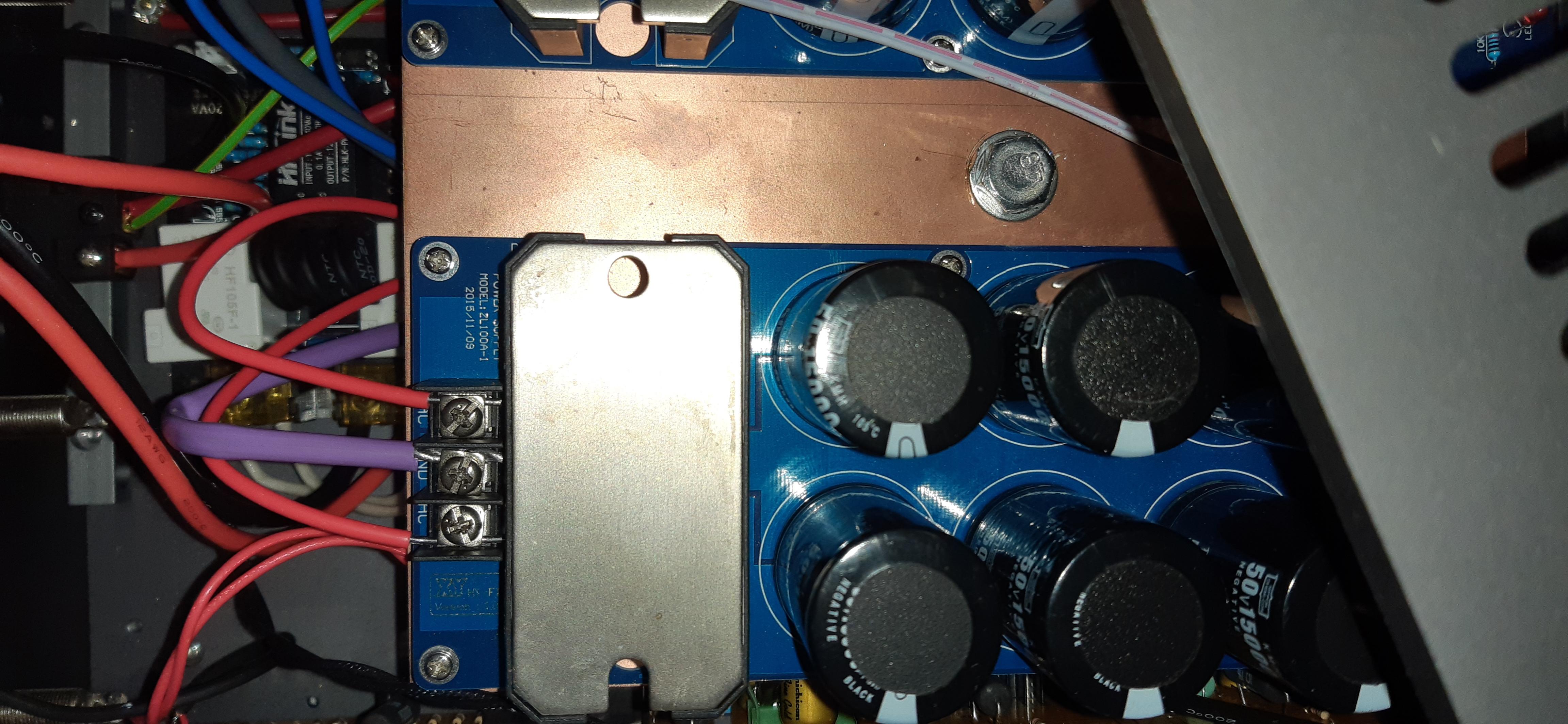

Hello, I want to say 2x18, 4 wires un total... look the attached picture with the trafo and power supply. The question is that the trafo only has 2x18v and PS need 18-0-18. In this case, I have to find a gnd or change the trafo. Thanks

I use the PS you can see in the picture. With ac-gnd-ac input and v+ gnd v- id course for each chanel.
So, i can use the middle grey and purple for get the gnd and get 36v between the other wires, but can i bridge it for the other PS ? or I have to get other trafo ?... sorry but I have a lot of respect with this current level.....

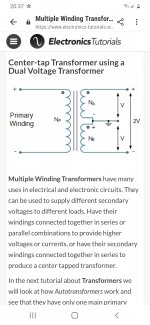

It is possible to connect two identical secondaries to make it a centre tapped secondary.
https://www.electronics-tutorials.ws/transformer/multiple-winding-transformers.html

You don't destroy the transformer when you connect the 2 secondaries in antiphase. They are in series, not parallel. When connected wrong you don't get 36V, but 0 V. No harm done.

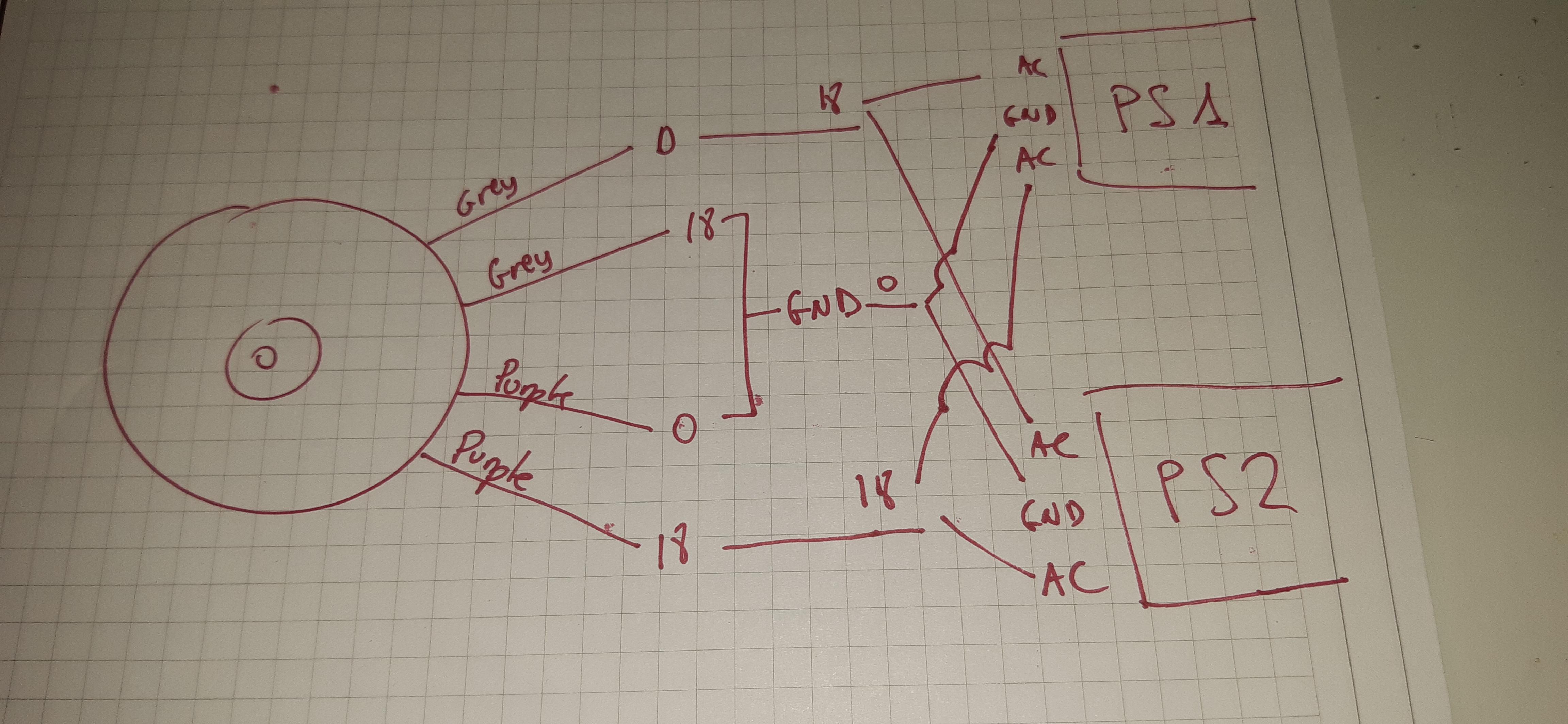

So, with this instructions, I get the schema I attach.
Can I connect in paralel the v+ gnd v- to the two PS ??
Don't look at that circuit, it is very confusing (seems out of context). Transformer is AC not DC as on the shown circuit, you don't have dc at that point.
(and don't connect the output of the 2 psu's together!)
