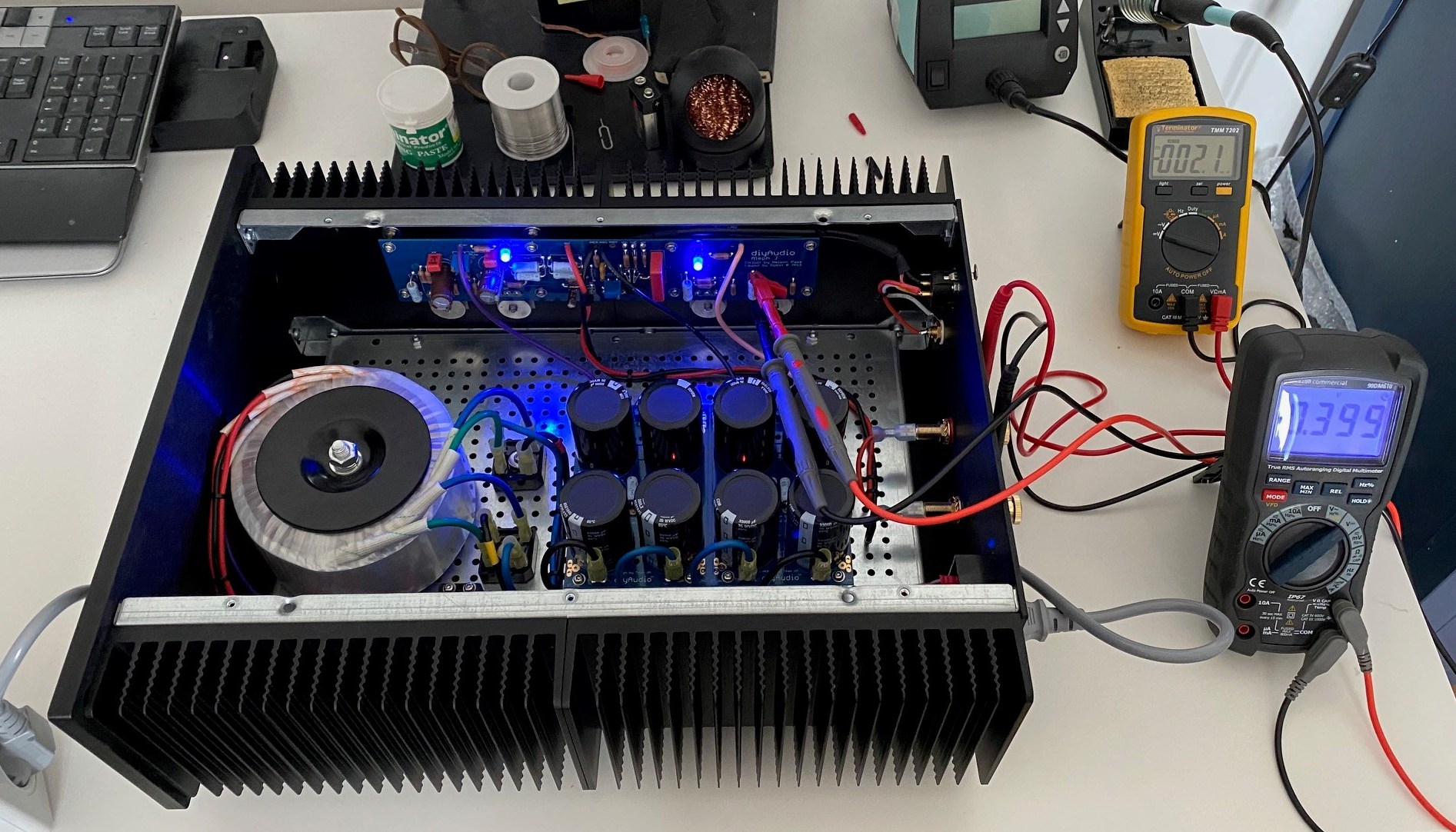

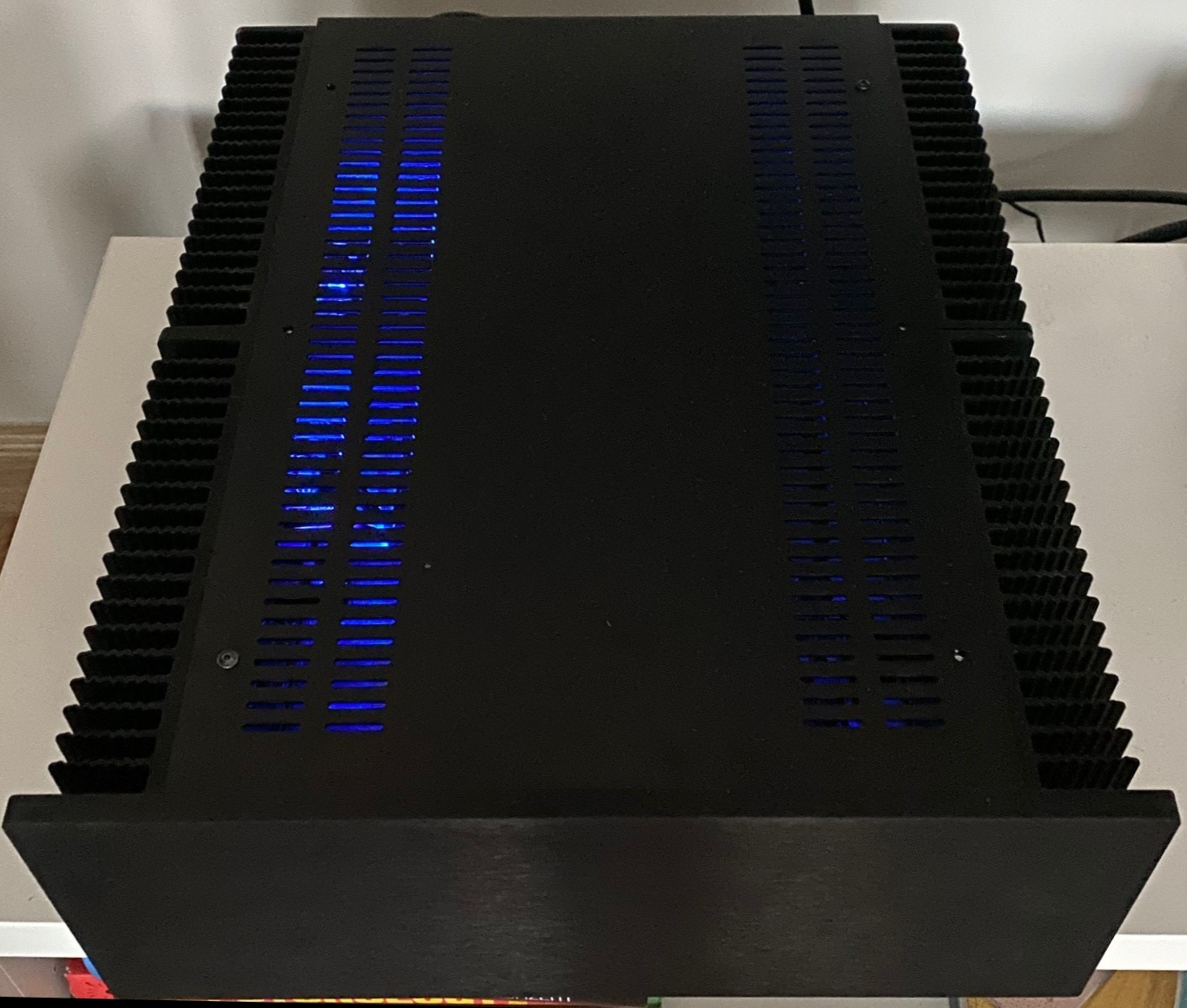

Sure - attached.
There is still one improvement on the way. I ordered 2 copper bars to thermally bridge the heat sinks. Right now, one is hot and the other one room temperature.
I hope to reduce some temperature a little and increase bias of MOSFETS.

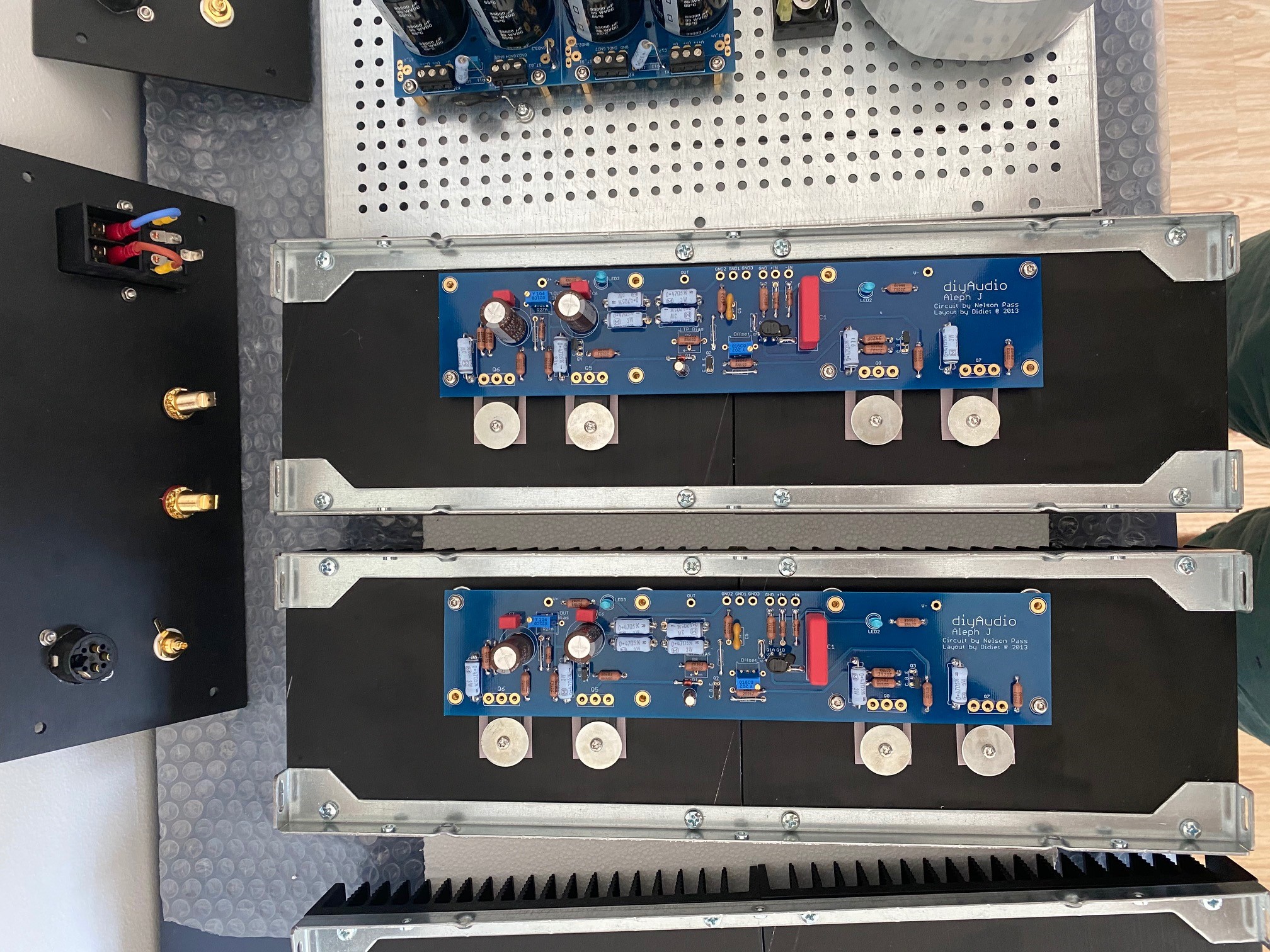

Wires are soldered from the bottom of the PSU board - 4 wires interconnecting both sides.
Regarding temperature of the heat sink - this is monoblock. So the Aleph J PCB is mounted on one side only. I hoped that heat would be transferred easily to the other heat sink - in reality heat dissipates on the why the heat sink - mostly on the front and top plate of the chassis.
Any advice how to distribute the heat more evenly?

I misunderstood.
There probably isn't a practical way to efficiently send heat across the chassis. On the other hand, the heat sinks on one side are adequate to dissipate the heat anyways.
Oh, I see that you want to increase the bias. It is a shame then that it is difficult to transfer some heat to the other side.

I build a F5 with transistors on opposing heatsinks. I simply ran jumpers from the board to the transistors. You must place.the Gate stopper resistors on the gate pin of the transistors.

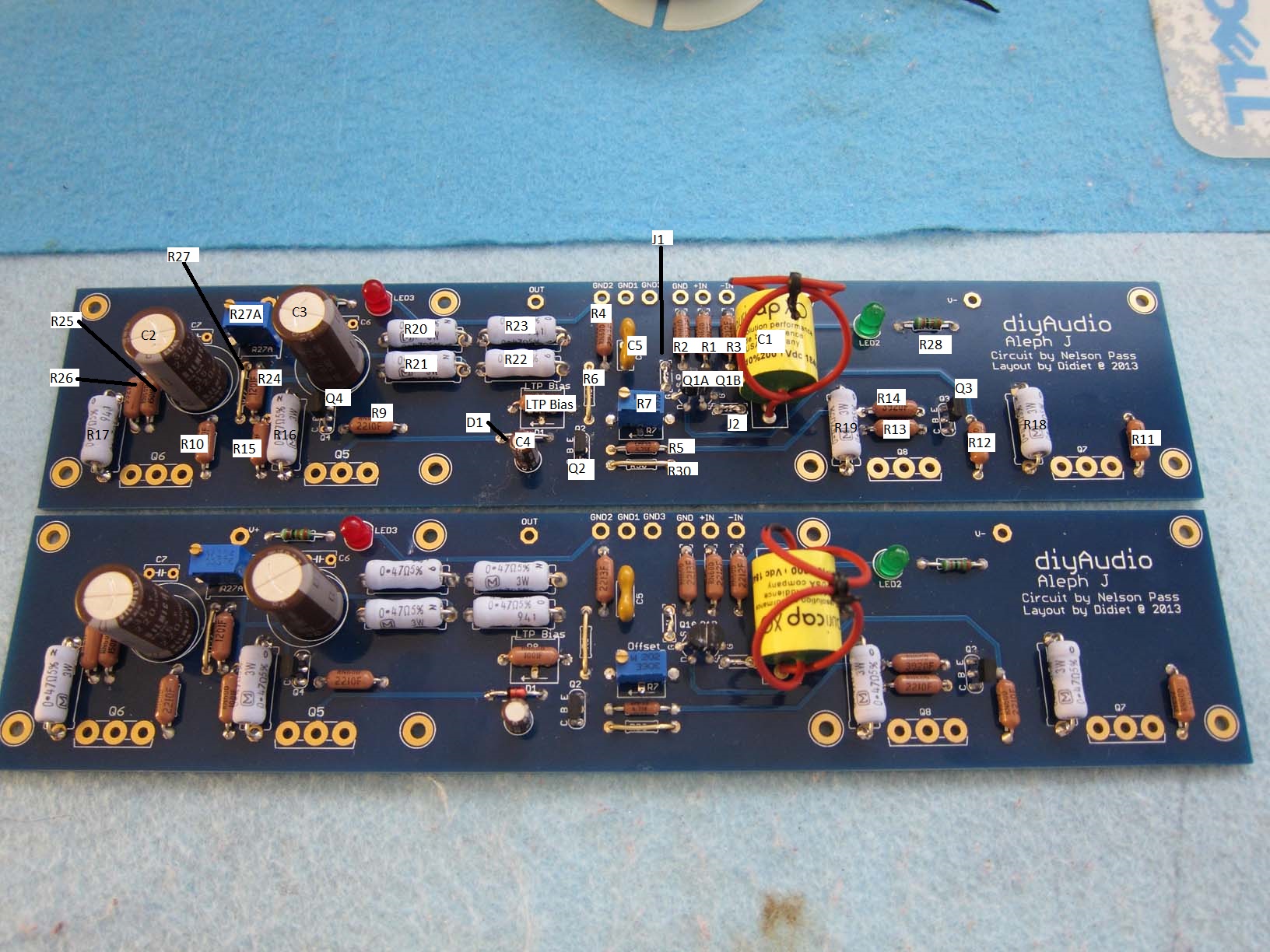

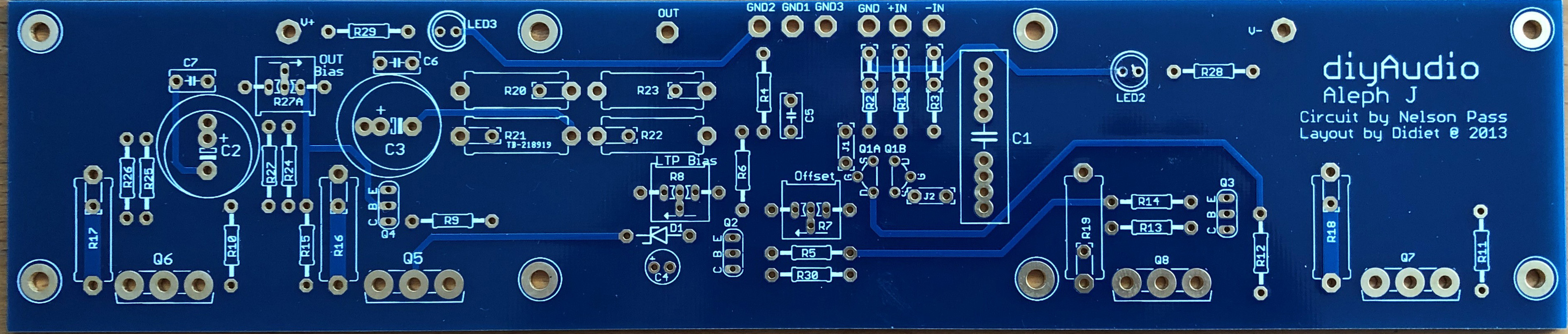

Clear, high resolution photo of empty pcb?
I've just completed building an Aleph J and one amp board is misbehaving. I'm attempting to diagnose the problem by comparing voltages between the good and bad boards, working from the input point, using the schematic. Unfortunately I'm having trouble identifying all the resistors on the populated boards, without access to a clear photo or similar image of the empty pcb. Can anyone point me to such an image? I've looked at the images included in the build guides but either they are already at least partly stuffed, or the image is not of sufficient resolution to read the details on the pcb.
If I continue to hit a wall diagnosing the problem I'll humbly post details and photos, and request a bit of your valuable time and expertise. Before bothering you folks I'll see if I can track it down on my own.
Thanks.
Here is a annotated board that I did a while back(Not my board but a great looking one), Please use with caution as not sure anyone but me has proofed it. I am still working with same problem of populated board and which component is which. Good luck. Lots of good help here. C6 and C7 have no components installed yet in picture. Picture is still useful.
