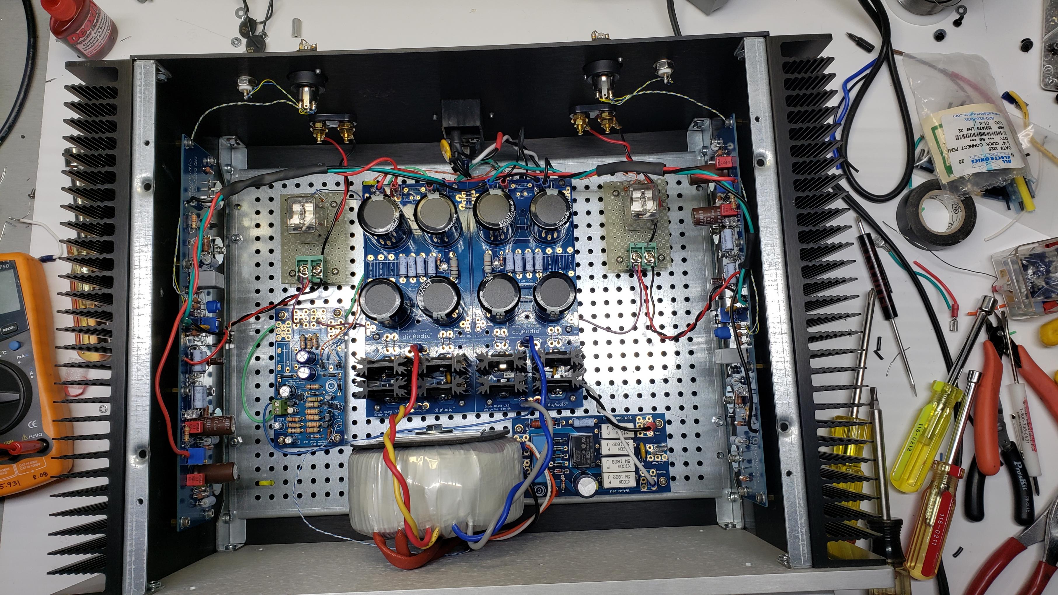

power supply update
I recently switched from a standard bridge rectifier to the fep30dp-3 rectifiers. I also removed the CL60 inrush limiters and installed the soft start board. I do not have time to listen tonight. It will be interesting to hear any changes.
I added the soft start kit because I had it . It came with speaker protector as a bundle from the diy store. There will be a small increase in the rail voltages as the resistance in series with the line is bypassed by the relay.
My in-laws are in town until 12/3, so my audio room is out of commission. But while they were gone a little bit ago, I put the shorting pins into my XLRs and switched cables to SE. In addition to the static in the right channel, I now have hum in both channels. There is zero hum with XLRs connected.
I have already replaced the damaged Q2 in the right channel, though it made zero difference, so perhaps the damage was superficial. In my quote above, see all my chassis photos.

My in-laws (love them) have left and, tonight, I switched the JFETs from L to R and R to L. My static sound switched from the R channel to the L channel. I have just purchased a new matched quad of B-grade JFETs from the DIY Audio store. Reports soon.
😕Help
I have now got 2 new and parred MOSFETs (Q7-Q8) and I can still only raise bias-out (R27) to 0.35mv. ???? It's just the one side.
