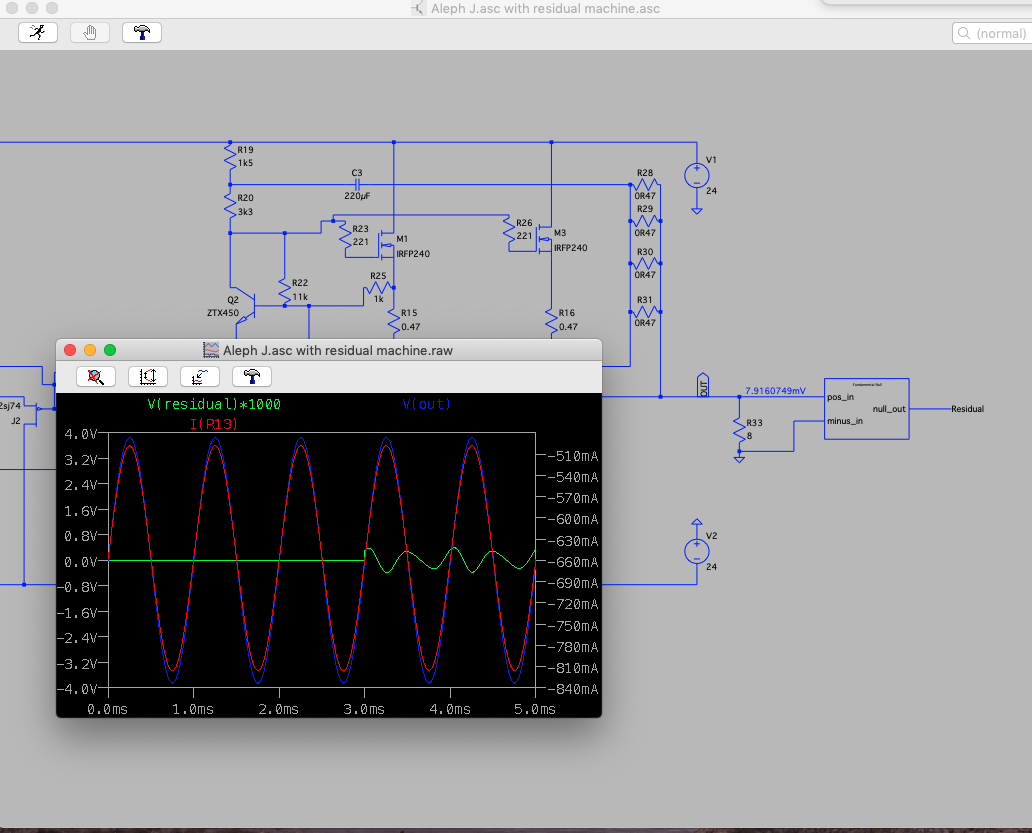

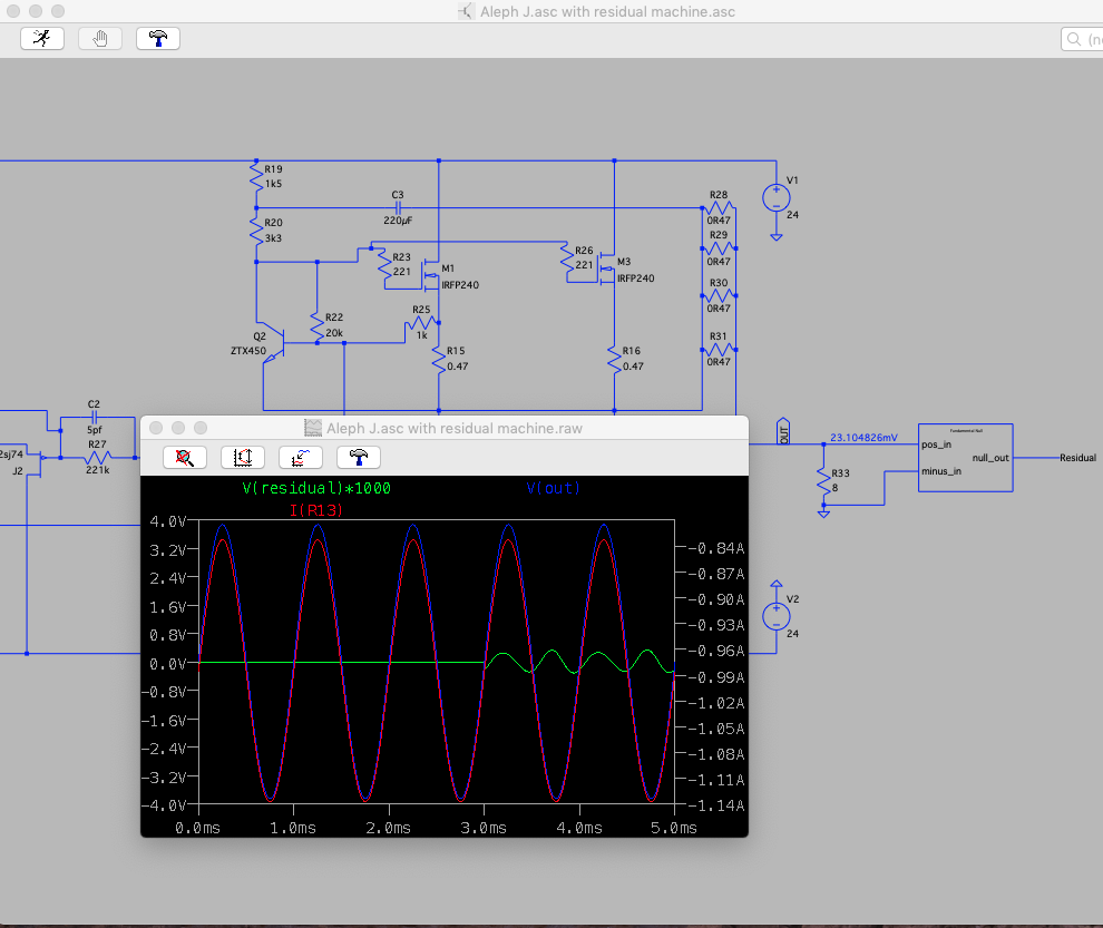

Joined 2009
Hope this is the right place, did not find a better one...
:D:D:D
A riddle in pictures to adjust the Aleph J....
Firsts picture:
Aleph J in Spice with 1.8A bias
Second picture:
Aleph J with 1.3A bias
To do it in real, you need to google the software tool "Diana" spectrum analyzer
and of course the a suitable sound card and PC/laptop arrangement.
Have fun adjusting the AJ!

OK, now that's cool. From a "really clean" positive to negative phase H2 with maybe a bit of something else. I'd need an FFT to understand completely. That's accomplished just by changing the bias... At least I think that's what I'm seeing. NEAT!
Also ties into my (poor at this point) attempt to learn Diana in order to see exactly that when I measure amps. More incentive to get off my rump.
:cheers:
Edited for clarity. I really haven't even had a glass of wine yet. :rofl:

The bias values shown are of course only for one pair!
One IRF gets 0.66A x 25V = 16.5W. So I see no problem.
My main intend was to show that more current can change the wanted neg phase.
This is Spice....
Where the point of change is in real ...... Please check it.
In the initial post, you mentioned 1.8A.
Then you said that this was for a single pair...
..... and now the 0.66A.:confused:
This is why I tried to move away from stating the bias current values, to stating the voltage drop across {R16, R17} OR {R18, R19}
I think I'm getting old...
:headbash:
