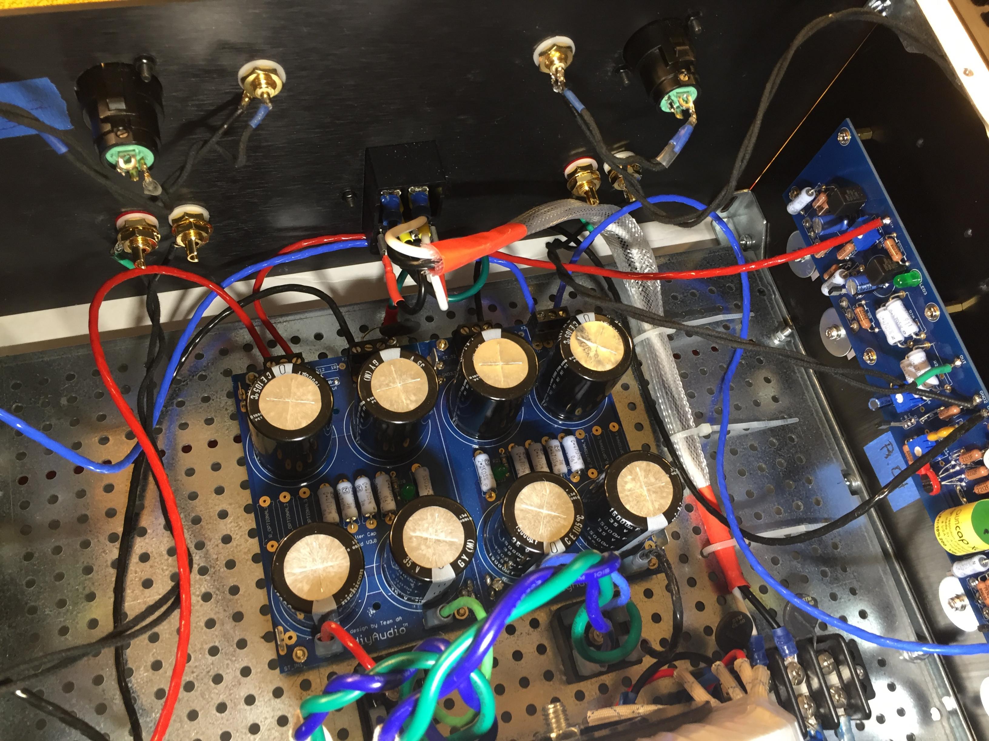

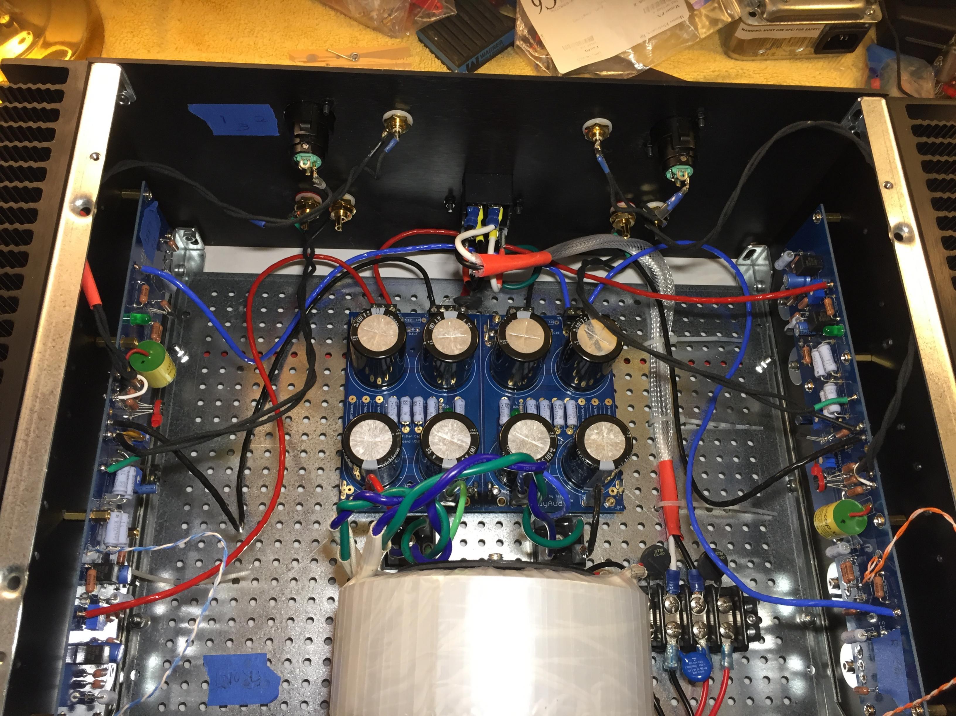

Awajoy - you have the RCA ground attached directly to chassis... I.E., on the wrong side of the ground-lift thermistor. That needs to be on PSU ground.
But before changing that, try wiring the RCA directly to the amp PCB (bypassing XLR) and jumper -IN to GND at the amp board inputs.

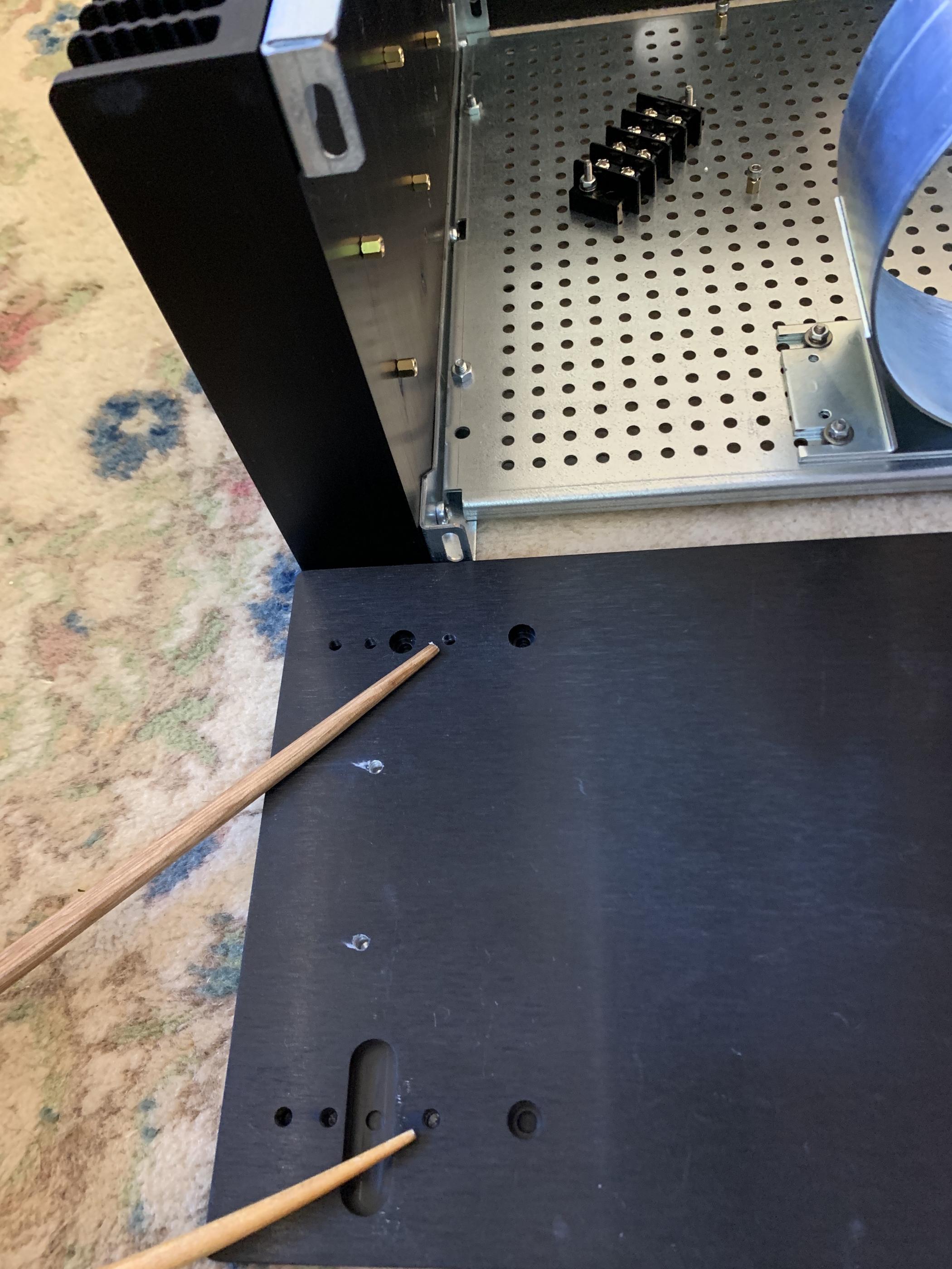

@6L6-- thanks... but I don't see how the big holes fit. Of the smaller, tapped ones (indicated by the chopsticks in photo below) I can get both upper ones to fit, or lower ones, but not both.
lonepine510,
The tapped holes you’ve indicated on the photo of the backside of the faceplate are the correct holes for mounting.
To align the slotted holes on the angle brackets for mounting the faceplate, I loosened the screws that mount the top and bottom angle brackets to the heat sinks and adjusted the top-bottom distance between the top and bottom angle brackets so that those tapped holes will line up properly.
First, you will need to take the baseplate off to make this adjustment. Believe it or not, this slight adjustment of the L-brackets will line up the slotted holes on the L-brackets with the holes on the face plate and rear plate. When you remount the baseplate, use M4 flat or oval head screws with a long enough length to attach the baseplate and heat sink subassemblies. I used a combination of M4 washers and M4 Nylon lock nuts. I didn’t tighten the M4 screws and Nylon lock nuts completely until I had the face plate and rear plate mounted properly. I also did this assembly on a flat, level surface to insure chassis assembly was properly squared up. Believe it or not, once you make these small adjustments, the chassis is solidly assembled.
Of course, this will require additional hardware that doesn’t come with the chassis kit, but it will greatly improve the chassis assembly process. In fact, a lot of the hardware that came with the chassis is sitting in a bag unused.
Thanks @rhing and @Bone13- I loosened the L-brackets on the heat sinks, and that certainly worked. I'll try the baseplate idea too- I'm having trouble getting the bottom cover to align with the holes. Thanks!

I’m glad that worked! The fun part about the bottom plate is putting the screws in the bottom (all not quite lined up), is doing it through the feet, so you can’t see at all what’s happening.
The chassis are not immediately obvious in the way they go together because everything bolts into everything else and the tolerances are actually a little tighter than it seems, so sometimes they can be assembled a little akimbo.
Essentially the entire amplifier is attached to itself at the heatsink rails... But the rails themselves are not stiff enough until the heatsinks are attached... so the heatsinks need to be attached very squarely to the rails. BUT
There is actually no mechanism to make sure the rails are on perfectly. That said, trying to square them up by eye to the heatsinks is a good place to start.
SO... the best order of operation is -
Rails on the heatsinks
Heatsinks attached to front panel
Rear panel attached
Perforated baseplate
Bottom panel
Top panel
IF the top panels don’t seem to line up with the mounting holes the best thing is to loosen the rails on the heatsinks a little and let everything wiggle a little, and then you will be able to find the holes. Attach the bottom panel squarely and snug the heatsink screws. The top should be square as well at that point.
6L6 and Zen Mod:

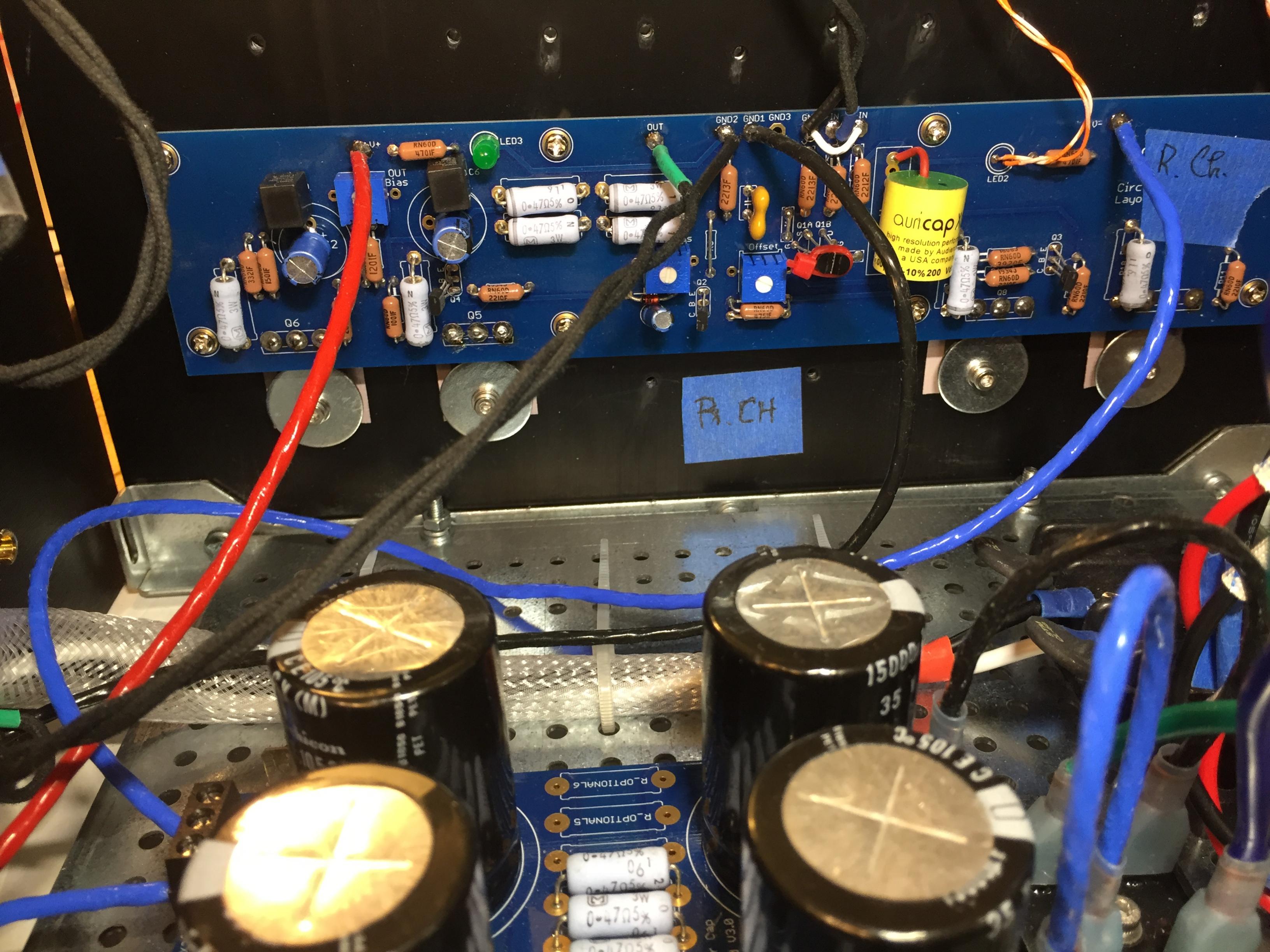

Made changes as suggested: twisted and connected the +IN and GND wires directly from amp PCB to RCA connectors, and jumpered -IN to GND at amp board. Disconnected the XLR connections.
Result: I think the change in grounding has reduced the turn-on/off pop on the both channels. On the right (problem) channel, the turnoff pop is still higher than the left. The cracking noise has reduced some in both.
With the RCA inputs connected to a source, there is now a slight hum with the left but still a very audible hum on the right channel, which also seems to carry an electronic noise component in additional to in the hum.
The offset immediately after power on for the right channel is as high as 2.4 Volts with a reading around 260mV on R19 and 300mV on R18. After it has been on for about 20 minutes, the reading would settle to around 12mV offset, and 349mV on R19 and 394mV on R18. Anything coming through the right channel is faint and distorted.
Does anything stand out to be the problem?
