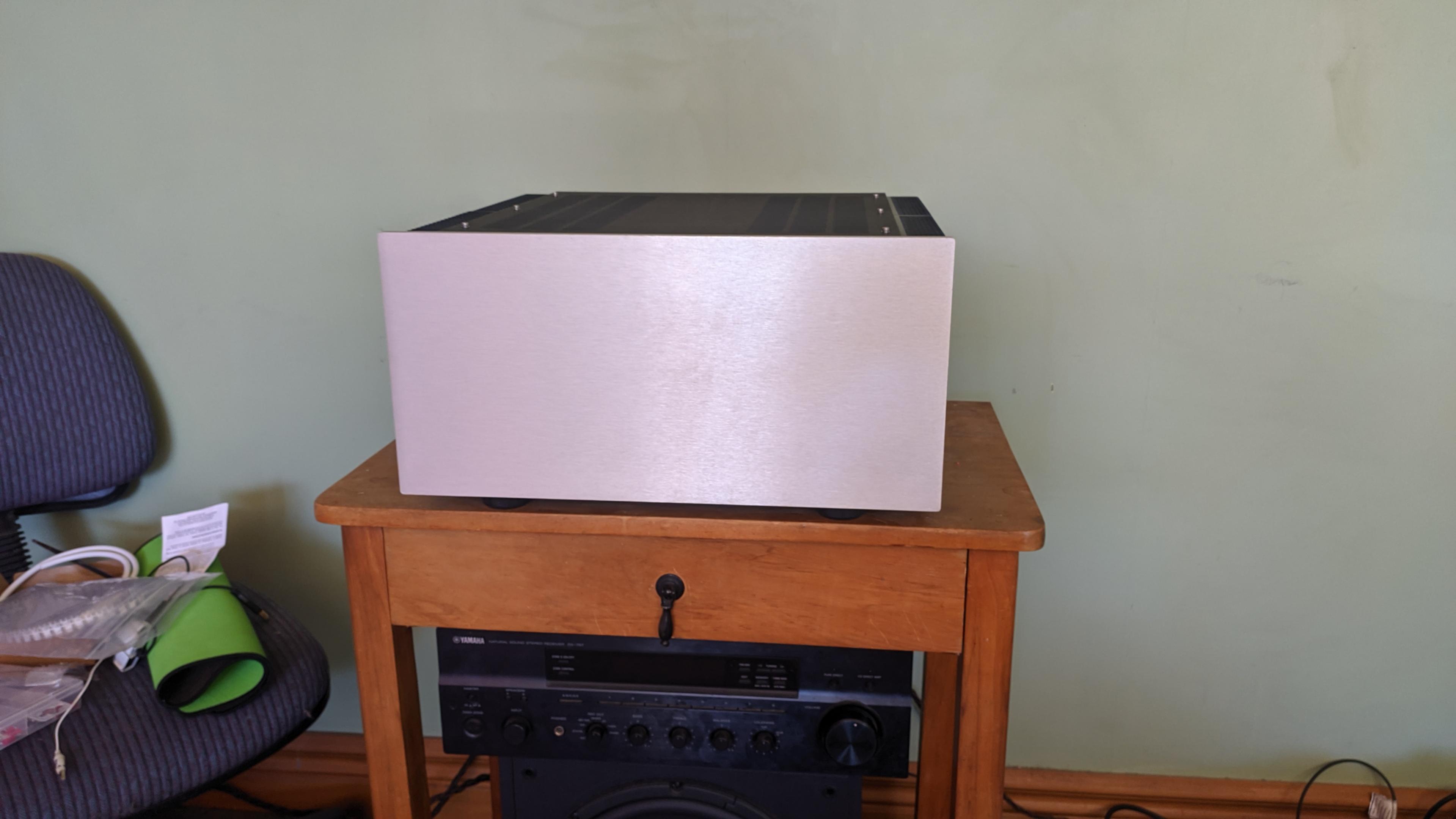

New transistor arrived yesterday and now the aleph is all up and running. Thanks team for the help and thanks 6l6 for the guide 😁 the amp sounds wonderful.
All I need now is a pre amp (thinking the ba3 front end)
Oh and a better shelf than this old desk

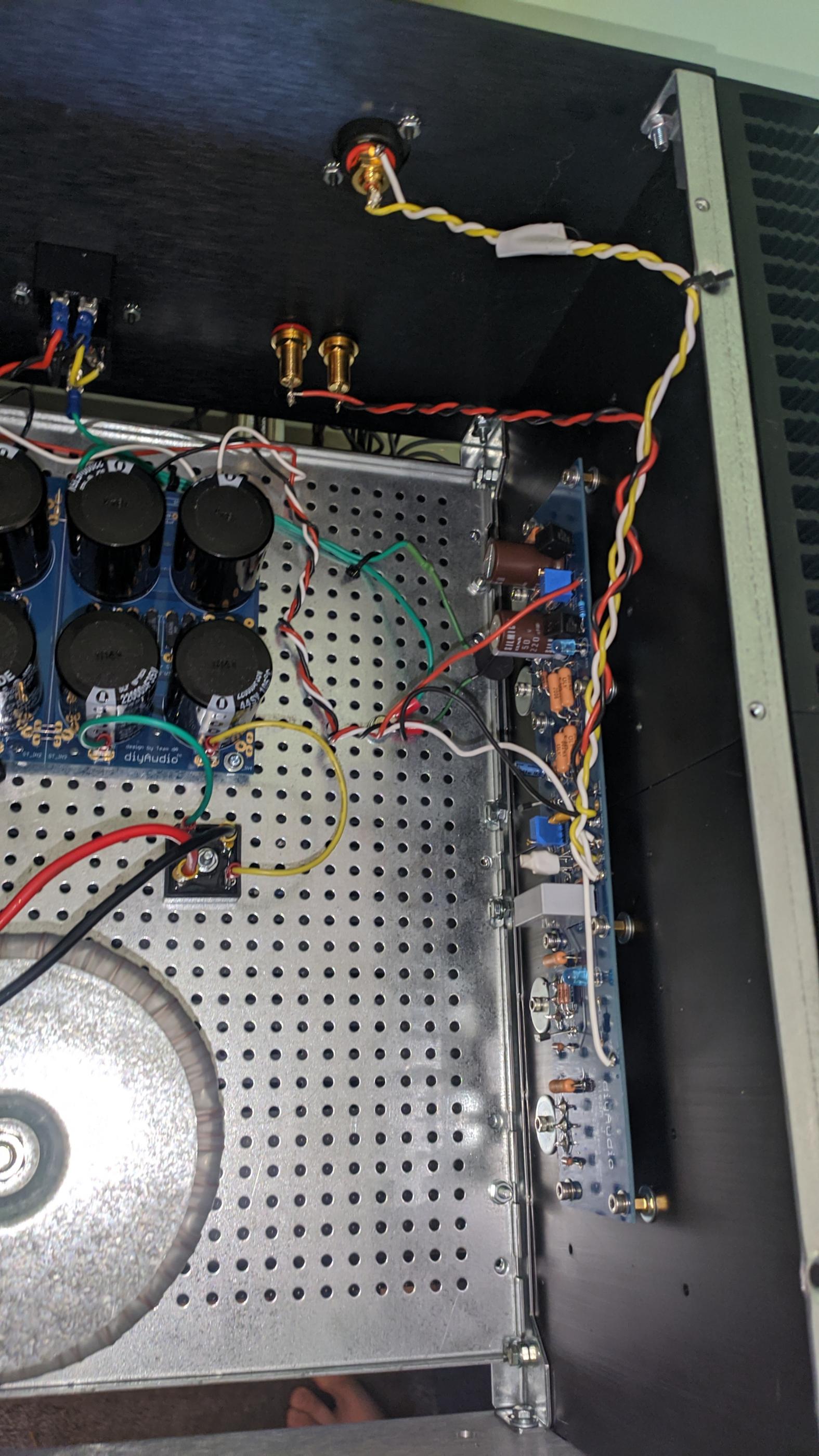

I DM'd user @Sov today and he explained that, due to life and other projects, he never found the cure for our shared ailment. In his message, he suspected jfets. Mine are not eBay – I got mine from the store, in B grade. He said he also replaced his capacitors (amp board? PSU?), but to no effect.
Earlier, I said that my situation was only half like Sov's, that I hadn't experienced a high-pitched whistle at shutdown. What I neglected to note is that I usually shut down my preamp first, then source, then amp. It's quiet that way. This afternoon, after removing both XLR cables from the amp and then powering up, and then noting that the right channel static still existed, I shut down the amp first. That's when I heard the whistle. Fck.
Ok, so my problem is just like Sov's. I have zero hum and my amp sounds amazing. It's just that, in between songs and on mute/pause, I hear static in the right channel, at the speaker, and not in the amp.
I should note that a very helpful member of this thread who requested to not be named walked me through the measurements and biasing and, aside from my own newb'ishness, we ran into no problems. The measurements and biasing were a breeze.
Attached below are photos.
Here is video 1: DIYAUDIO Aleph J static - YouTube
Here is video 2: Aleph J static 2 - YouTube
*Edit, thought: If you look at my Q2, you'll see that I added some shrink wrap to it. That's because I initially had it mounted backwards and... I had the Missus pull it out with mini needle nose while I applied the solder iron to its pins. Upon retrieval, a bit of its black plastic broke from the top, exposing some silver beneath. Hence the shrink wrap. Yes, on this right channel. Could it contribute to the issue?
My in-laws are in town until 12/3, so my audio room is out of commission. But while they were gone a little bit ago, I put the shorting pins into my XLRs and switched cables to SE. In addition to the static in the right channel, I now have hum in both channels. There is zero hum with XLRs connected.
I have already replaced the damaged Q2 in the right channel, though it made zero difference, so perhaps the damage was superficial. In my quote above, see all my chassis photos.

I explained the root cause couple of pages back...
You should use the pure solid core copper, twisted pair - unshielded. The shield, coming from the XLR connector, should be connected to amp chassis right at the connector (pin 1), using the same screw used to mount the XLR connector to the backplane. You could even use the ground lift at this point: DC coupled using very short wire, OR AC coupled using 0.1uF disc ceramic cap (ground lift). This will drastically reduce the noise pickup loop length.
The amp PCB's will still get the ground reference connection from the power supply board common... and... the slight buzz that many have reported will be completely absent.
Unfortunately, with a single-ended input, this can not be done... so a ground-break resistor could be used.
The input stage on the AMP PCB needs to be relocated to be physically close to the RCA sockets at the back of the amp. Then, the hook-up wiring would be short... just look at Nelson's amps... he "terminates" his input loom as soon as it enters the AMP.
