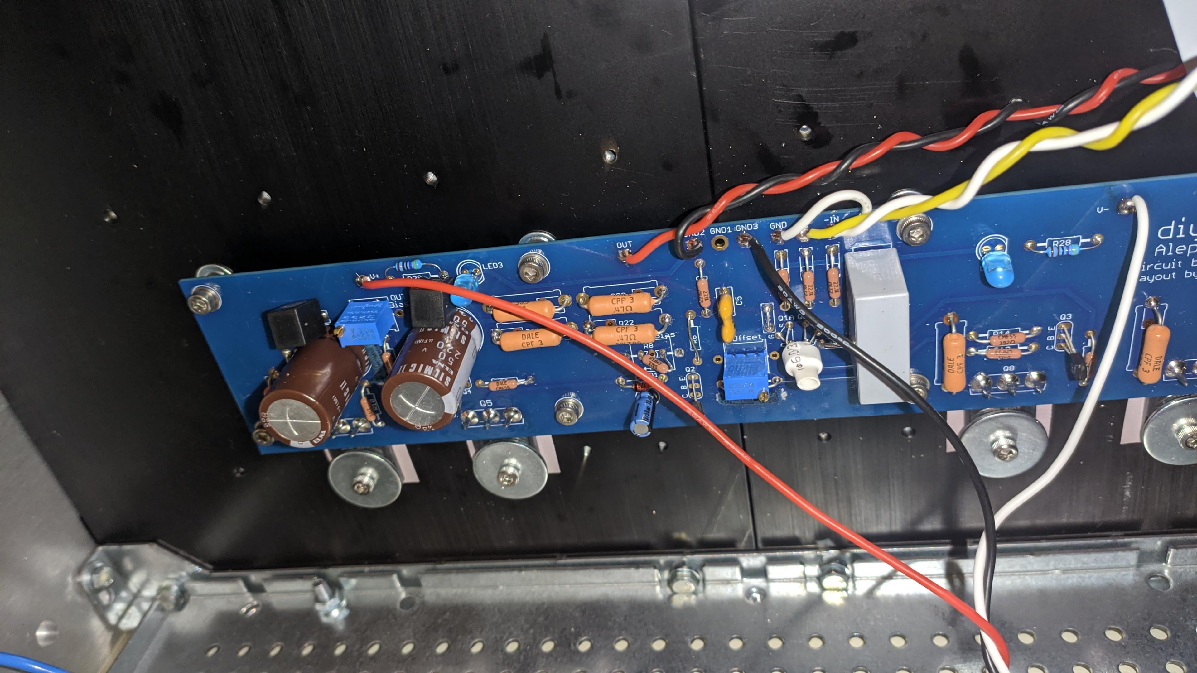

Step 1 didn't work. 🙁
So a new Q2 didn't fix the problem. Dang... 🙁
See if R5 has the correct value and also consider replacing the 9.1V zener D1, in case it is 'noisy'.

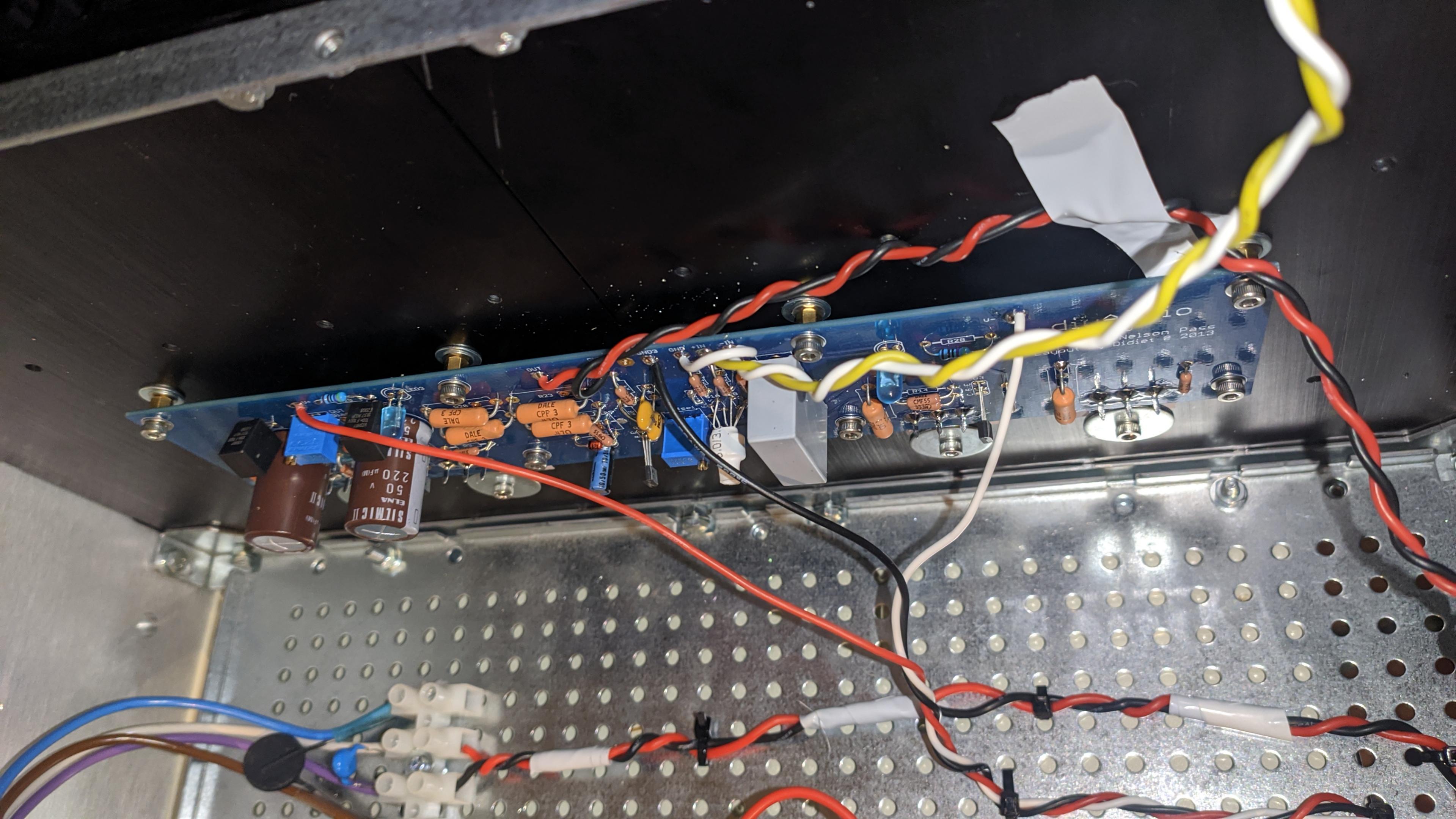

OK, so if I understand correctly, does this leave the GND hole on the amp board vacant? Twisted pair running from +IN and -IN to Pins 2 and 3 on the XLR connector? If I then use a XLR-to-RCA adapter that connects pins 1 and 3, will that still work?

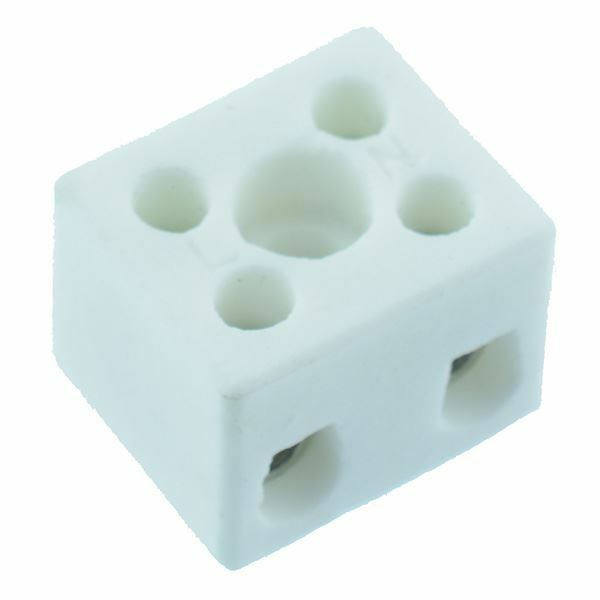

Use a ceramic terminal block, both legs of the CL60 in one side, two wires on the other side, one wire to chassis, the other to the PSU ground
Use a ceramic terminal block, both legs of the CL60 in one side, two wires on the other side, one wire to chassis, the other to the PSU ground![]()
Any reason that a plastic terminal block wouldn't do just as well for this? I've got an extra two position plastic terminal block handy.
Yes.
The AMP PCB is still getting its ground reference from the power supply PCB. If you connect the speaker negative to the AMP PCB (as per the build guide instructions) -> then there will be some current (few amps if you like your music loud) running through that point as well. If you connect the speaker negative straight to the power supply common, that point will indeed serve just as a ground reference for the AMP PCB. Try both and see which one sounds better.
Yes.
It will, as long as you connect pin 1 to the XLR screw (to the amplifier chassis, by using the screw that fastens the XLR connector to the chassis). This wire link should be reasonably short (2-3 cm)
You could choose not to connect the shield at all if using XLR exclusively. Just leave the source-end shield connected to the source chassis (this is usually more “quiet”).

Any reason that a plastic terminal block wouldn't do just as well for this?....
In a fault condition, the CL60 will get hot, it's possible a plastic one could melt 😱

I haven't done that yet, but help me make sense of this?
At the amp, I put the right channel XLR cable to the left channel, and the left channel XLR cable to the right channel: no change, static stayed in the right speaker.
I put it back to normal. Next:
At the amp, I put the right channel banana plugs at the left channel, and the left channel banana plugs at the right channel: the static moved to the left speaker.
I put the speaker cables back to normal, except that I switched out the right channel speaker cable with an identical but unused cable. The static sound stayed in the right channel.
Today I added those plastic washers (from the back panel kit) to the interior side of the right channel speaker binding posts. I'm certain there's no contact, but thought it could help.
I also pulled the amp board and clipped every through-lead as close to the board as I could get and added some backside soldering to anything that wasn't perfect. There was no heatsink contact before, but I did it anyway.
No change. Still have static in the right channel that sounds like the end of a record, just spinning (same for all sources). 🙁

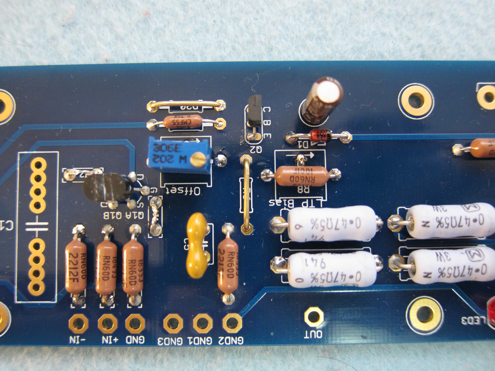

Question: is D1 directional?
Sure is! Check the photos...
Thanks. Mine are in correctly, based on your photos.
