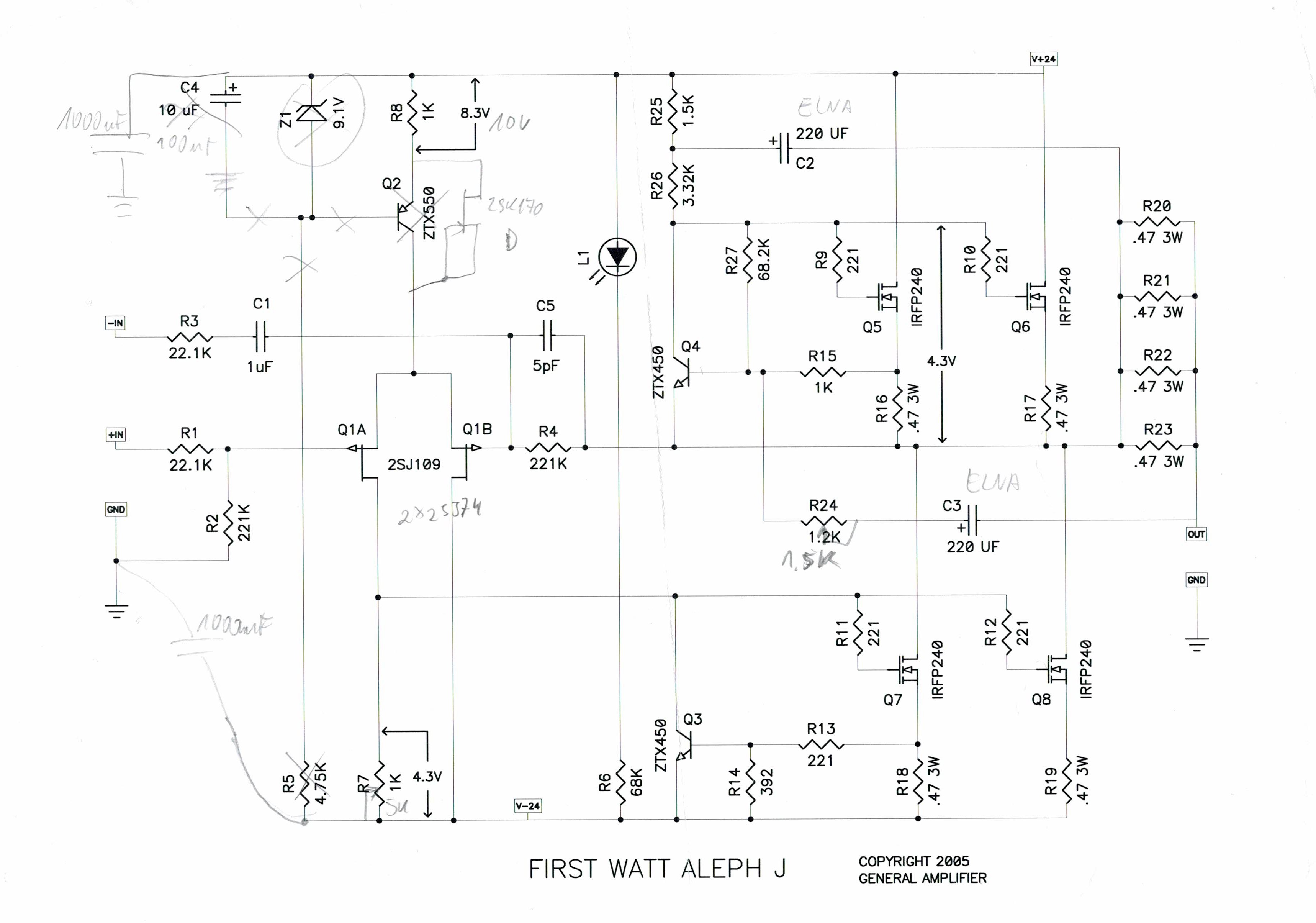

After several year break in DIY I get back to Aleph J project. Among my stuff I found a picture of amp schematic with modyfication put on it by pencil. I don't remember the source of this mods. Was it my idea or I found it somewhere ? Could you tell me guys will it work ? Which ones are OK ?

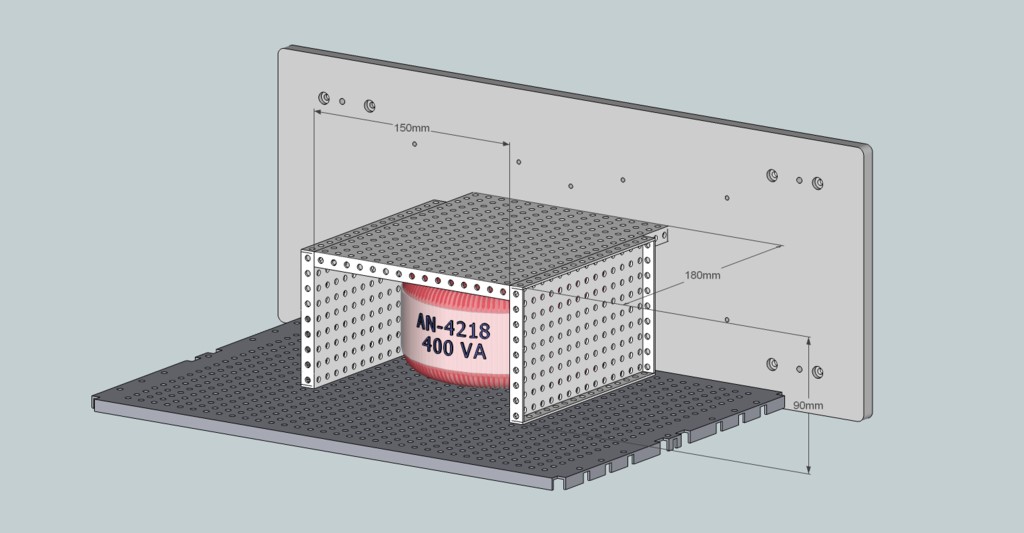

Q re stacking psu board above transformer
I was planning on using an "L" bracket to vertically mount the transformer, such as this:
https://toroid.com/l-bracket/
Unfortunately, the shipping is prohibitive. Would this work instead:
https://www.amazon.com/gp/product/B...&pf_rd_p=edaba0ee-c2fe-4124-9f5d-b31d6b1bfbee
Another thought would be to use the risers from the DiyAudioStore to make a platform over the transformer, as shown in the listing for the risers (see attached).
With that type of platform, could I safely attach the PS board to the top of the platform?
Any thoughts would be appreciated.

You may be able to find something like this on your side of the pond Aluminium Angle ║ 6" x 3" ║ (L section, edging, bracket, alloy,ally) | eBay
