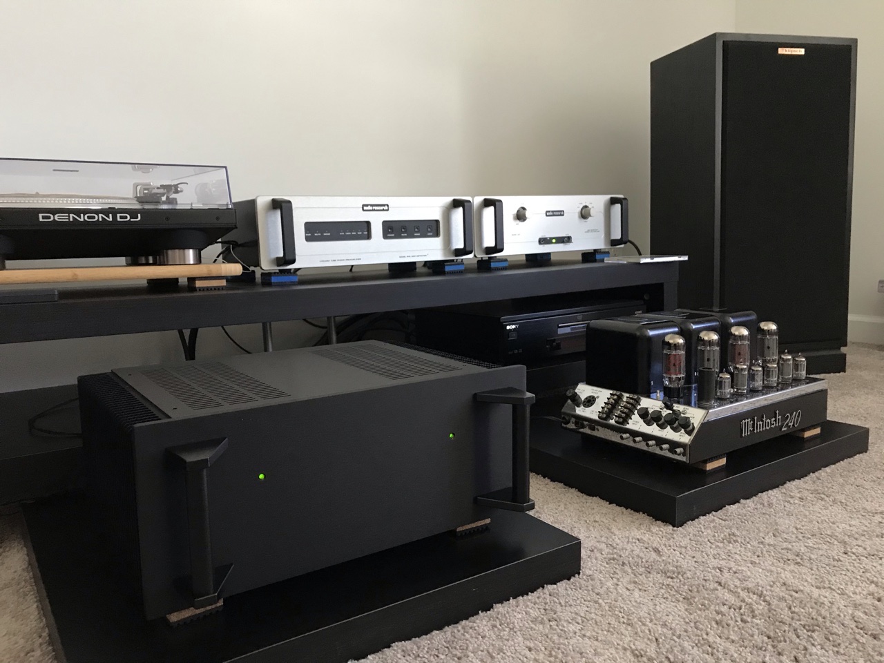

I just completed an Aleph J build, and now I am burning the amp in my system. I only experienced one glitch during the build where I damaged the JFETs while installing them and tightening the ties. Fortunately, I was able to get a matched quad of the Toshiba 2SJ74 BL JFETs from eBay seller Punkydawgs where I have purchased transistors from in the past. This time, everything tested well and it sounds great right from the start. There is a faint hum, so I’ll rotate the toroidal transformer to eliminate it.
Anyway, thanks for this excellent build guide 6L6. It made building and testing this amp a lot easier.
This amp has a big sound if I can call it that. It is also very nicely detailed with great separation of musicians in the soundstage. I am very pleased with this amp. It sounds different from the Pass DIY Sony VFET amp and my McIntosh MC240 tube amp. They are all excellent in their own ways. To my ears, this amp almost has bloom like a tube amp. Is this due to the single ended nature of this amp design? I like it!
I need to get my measurement gear in place and analyze this amp’s output. Thanks again.

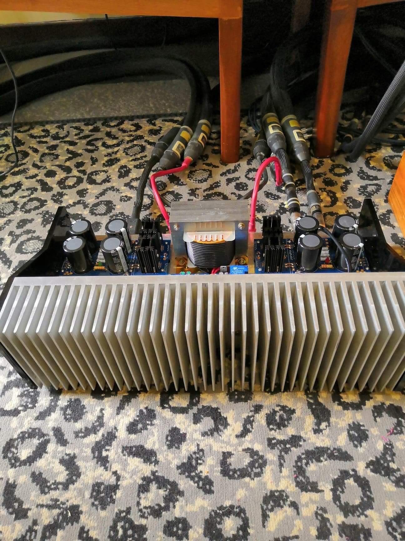

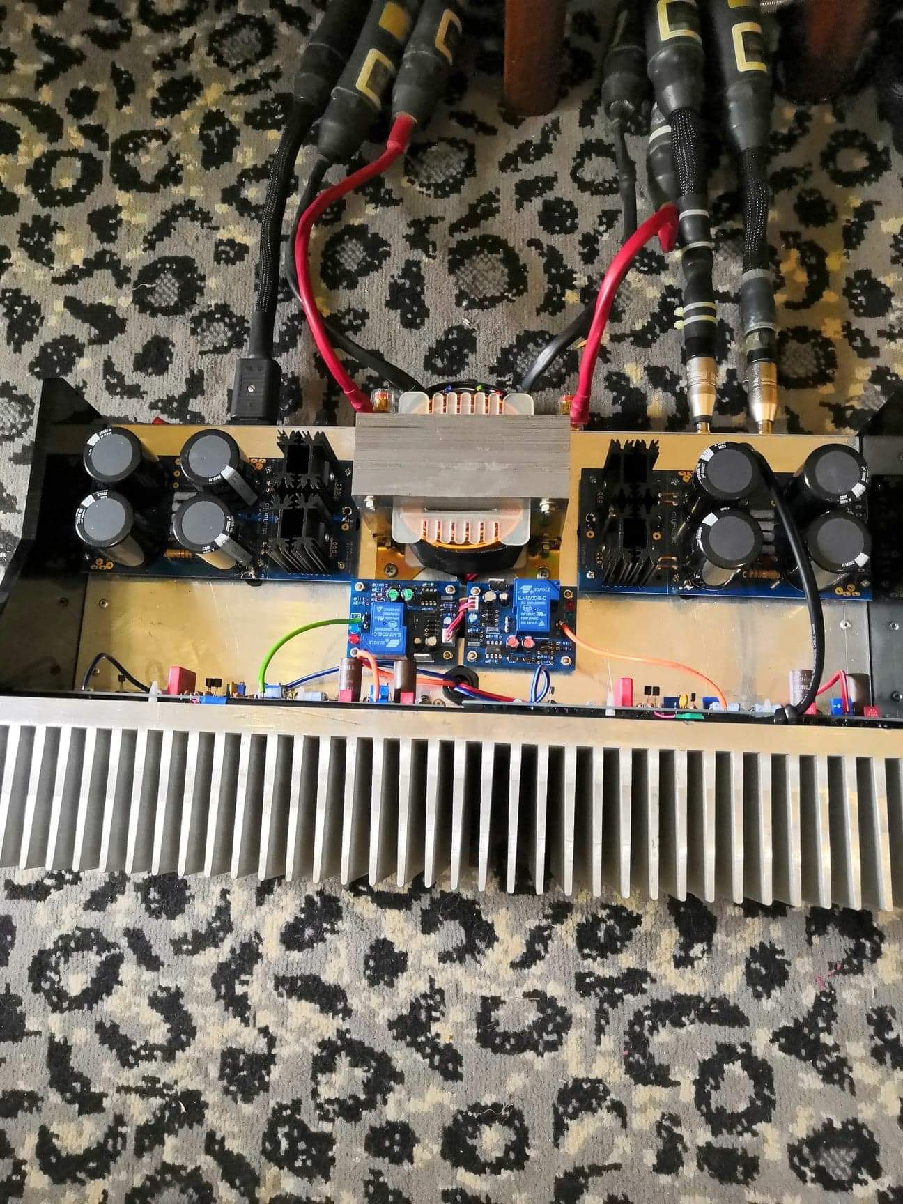

That's a nice looking build, Rich! Nice looking system as well! Along with rotating the transformer, you might want to braid/twist those AC wires (both primaries and secondaries) and see if you can pull the input signal wires closes to the side heat sinks.

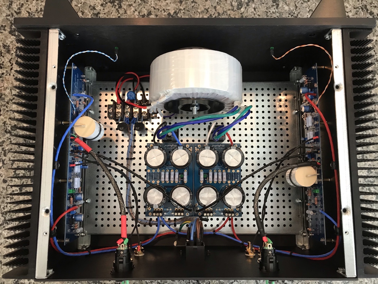

Where did you find that nice looking chassis?
Hi All,
Thanks for all the tips. I’ll route the ground with V+ and V- to each board. I’ll start with trying the transformer rotation and then change my wiring. I do like Zen Mod’s suggestion the best (ha ha), but I’m trying to coordinate the Aleph J with my Audio Research gear. I also have the B1 Korg preamp with the green LED and black Aluminum chassis.
The chassis is the 4U Deluxe chassis from the diyAudio.com store. I bought the optional handles and then drilled out 5mm dia. holes for the LEDs and countersunk the holes using. 1/4 in. bit on my drill press. I used a Sharpy permanent marker to color the drilled and countersunk holes and you’d swear it was anodized.

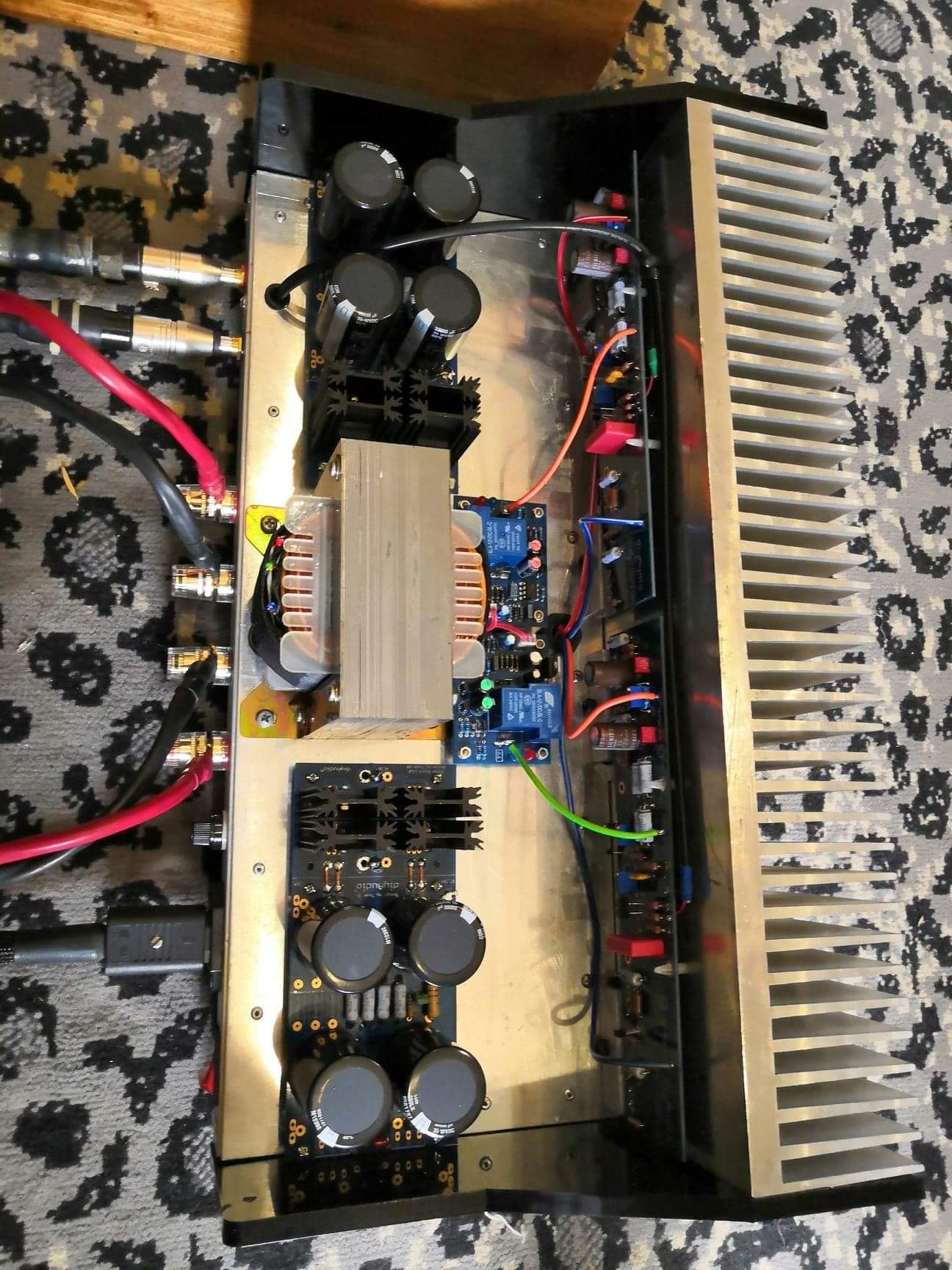

Also, just to share my AJ build.
Pass DIY Addict
Joined 2000

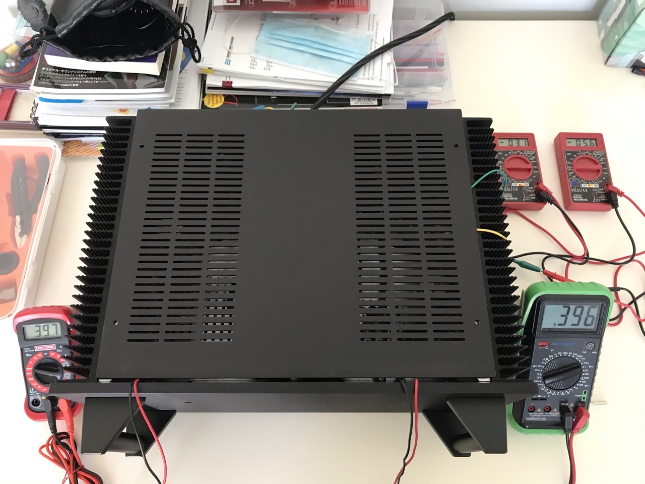

The chassis was built for the AJ. I had two of the heatsinks waiting for an appropriate project for it. But then came my interest with AJ and I thought using two might be an overkill so I decided to risk with one. Turns out one is more than enough. Temp stays around 35-39degC, though in an Aircon room.

Hey All,
