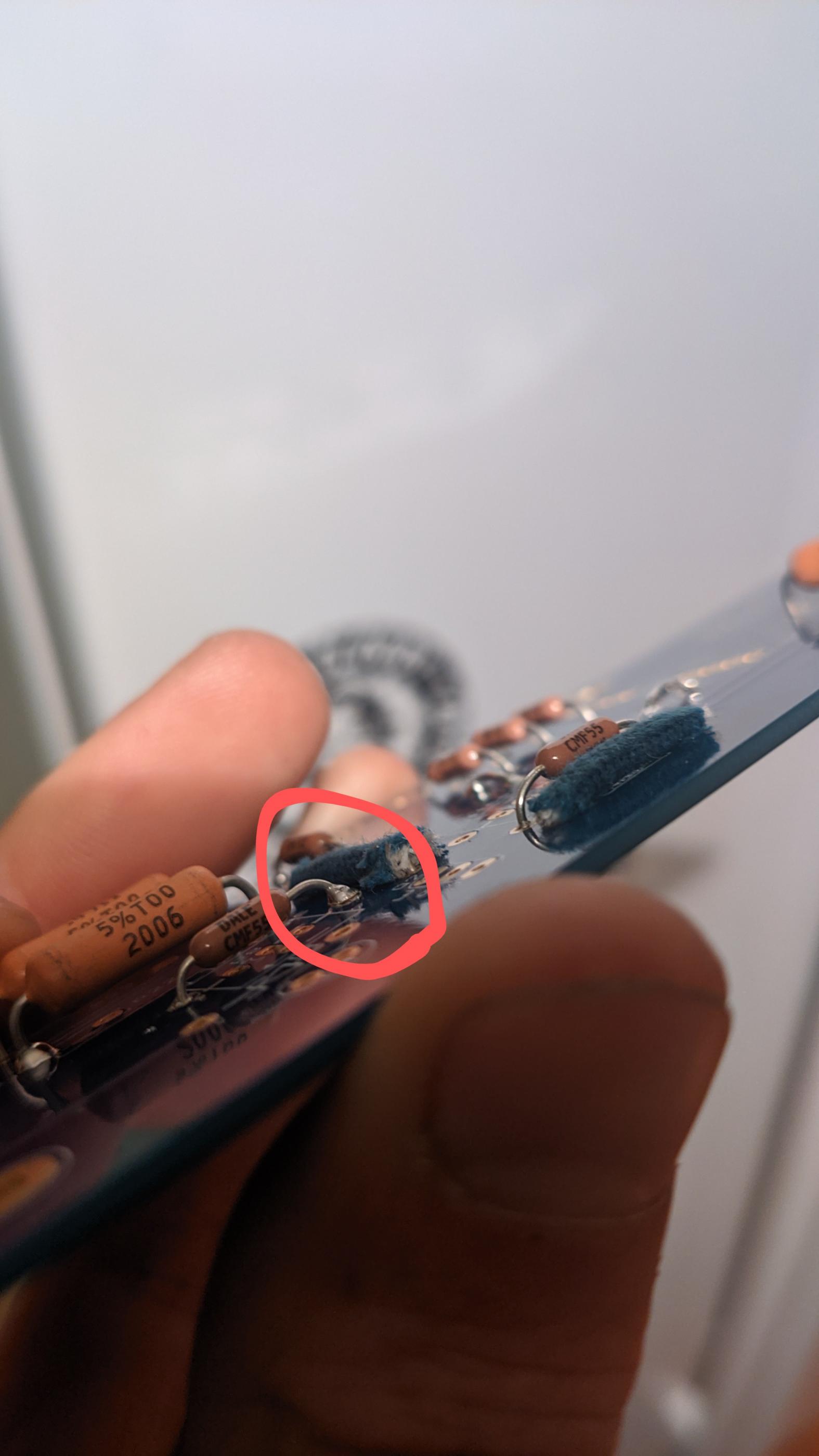

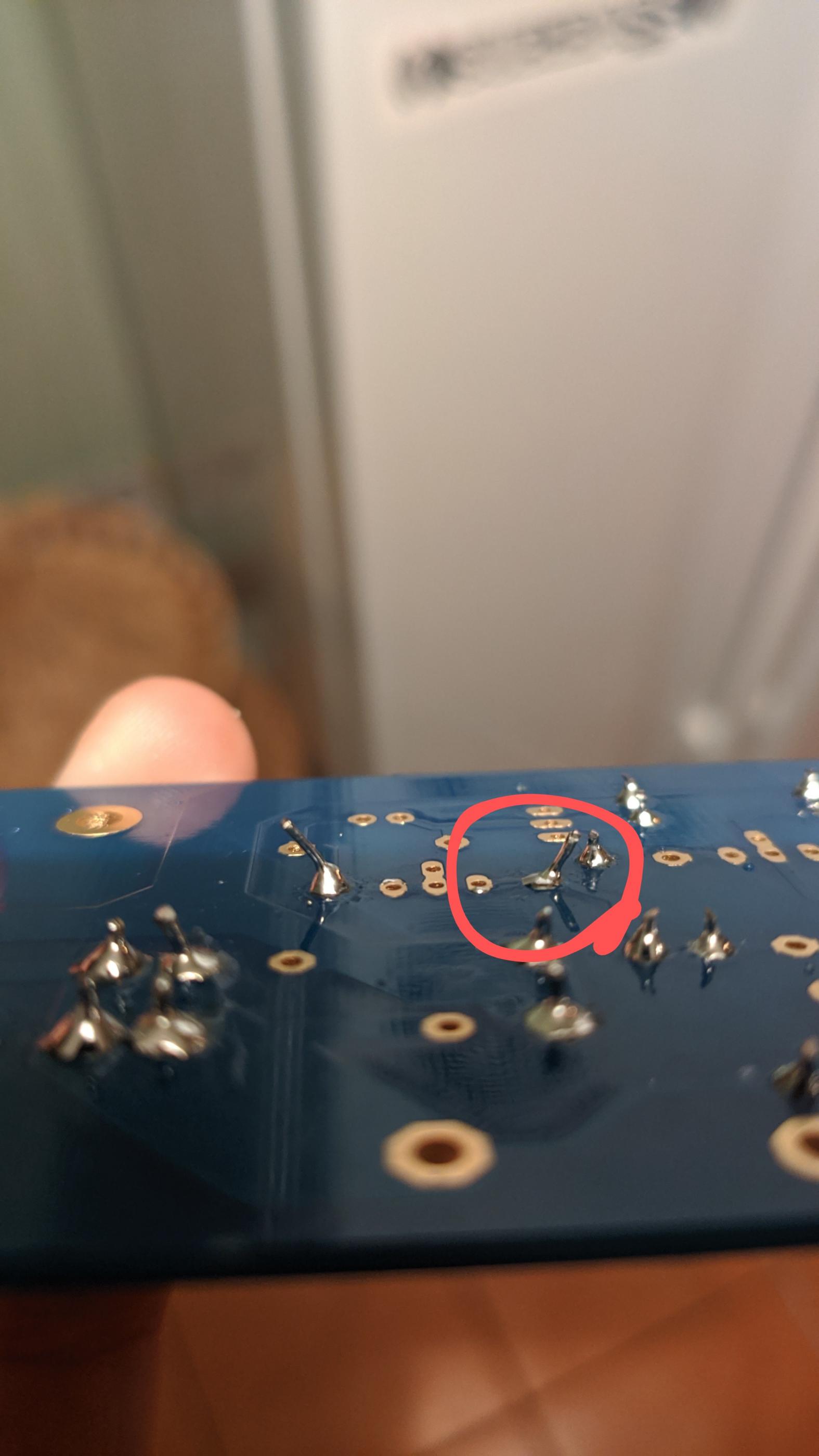

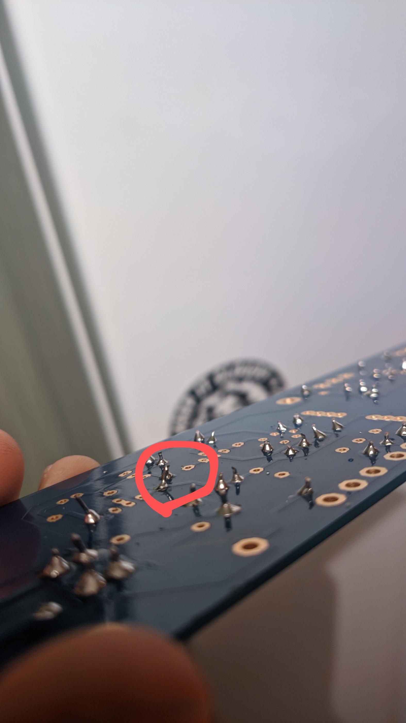

One question. I had to desolder r8 as I put the wrong value in it and it looks like the pad has lifted ever so slightly. I have tried to attach some photos but it was hard to get a close up with my phone camera. Is this still workable? Or will I have to replace the board?
I'm still measuring 1k between the jumper and the pad where d1 goes so I'm assuming it's still connected. But I'm unsure if this will cause me problems too

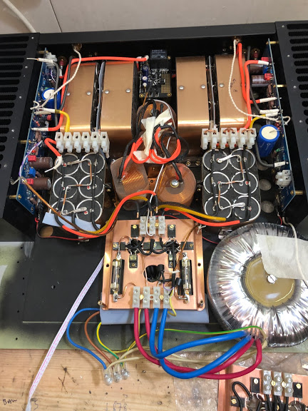

I followed Pechelman's recommendation on using the Simpson Strong-Tie A24 L-bracket. I little work on the drill press and some 6mm screws and Nylon lock-nuts made vertically mounting the transformer a breeze.
I'm glad this tip came in handy! I searched my local hardware store for about 30-45 mins before I stumbled on those. Good looking build too, enjoy!

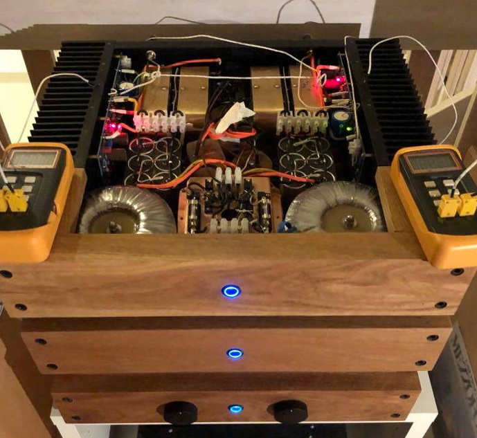

Up and running part 4 The end
Got my 2,2mH inductors hooked up yesterday,
As suspected it was quite a step up from initial setup without inductors.
Now its runnning CLC consisting of:60000uF - 2,2mH air coils in epoxy - 52800uf.
With the inductors in place the sound went anoter step darker and more quiet.
Just my cup of tea.
Love it,
thank you all for all the good info.
