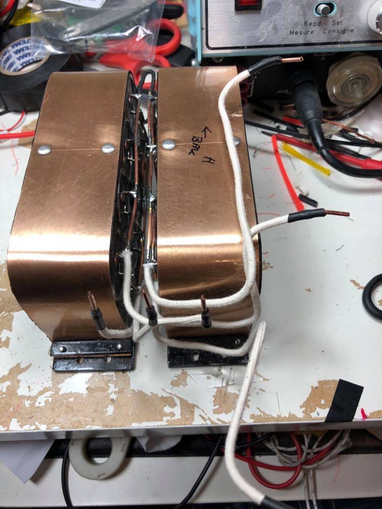

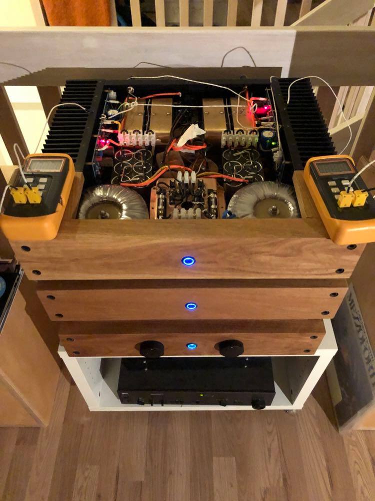

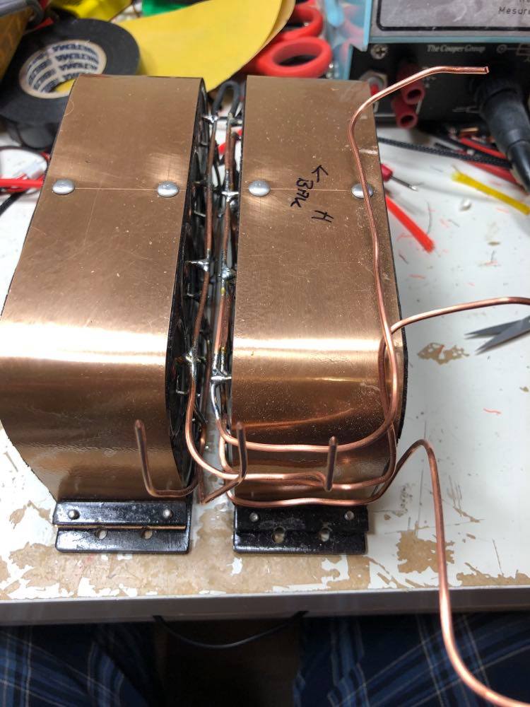

Nice work! Pardon my ignorance, but what are the four big coppery looking things in the back?
Thanx,

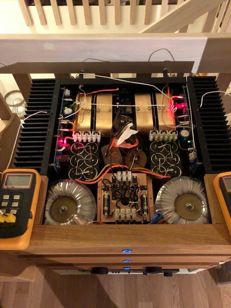

This Amp is the last in several "Pellesmil design" cabinets,
Oak and metal combined, and they all have my spesiffic footpring X 100mm high.
As i wanted to pack as much as possible capacitabce in the PS i needed to re-think the stacking of the capacitors,
With the inductors in place its wery close what this cabinet can carry.
As for your Q, the copper things are a cage to hold the no 2 bank of capacitors (8 + 8 3300uf ROE).
The room between the capacitors where then filled with silicone to hold them in place and reduce hamonics.
Im open for dicussion whether the silicone offers any sound benefits but it keeps me sleeping at night🙄

Up and running part 3
Yes.
Solved all issues tonight🙂
For those of you that have Holton HPA-LSP-One Rev 5 - Loudspeaker Protection Boards:
It will only work if you tap the AC from the windings that supply the posetive rectefier.
In short, the voltage between the power GND and any of the AC lines shall be poseive not negative.
So.....
Yesterday at the workbench i adjusted the bias to 450mv and the temperature on the transistors where sniffing at 60deg C.
Today whitout lid it settles at 59/58deg C (R/L device temp) and 54/53deg C (R/L sink)
The sound is as i expected to hear from a good Class A amp, at first glance its nothing special, no bling no flexing no shouting, just music
and after an hour or so it crawls under my skin.
Love it.
Need to adjust my DPS tho, it has less gain than my Holton nxV300R2 so in my dual amp setup the sub is beating a lot of bass out in the room.
The 2,2mH inductors are not connected, will do that later.

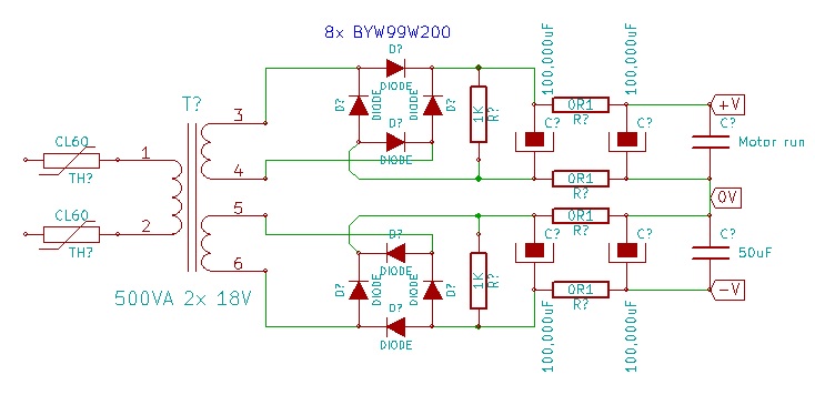

Hello experts! Can someone explain what capacitor C9 actually does (the blue one here)? Various earlier posts alternately describe it as a safety cap or a line filtering cap.
Also, some are telling me that the best practice is to use 3 CL60 thermistors, but I see only two attached to the AC in terminal block in this diagram. Where does the third one go? I assume all three same specs?
Thanks for any help!

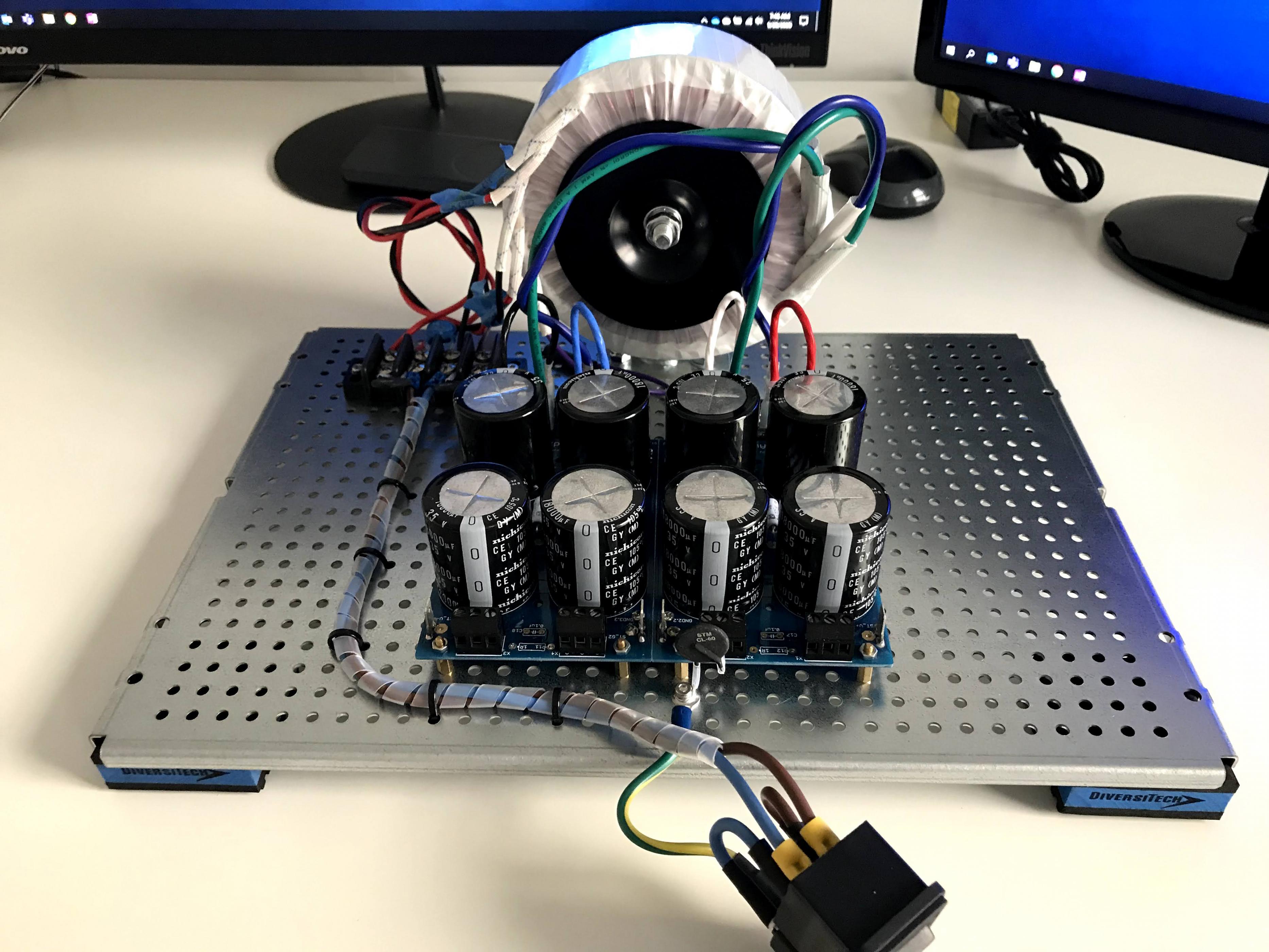

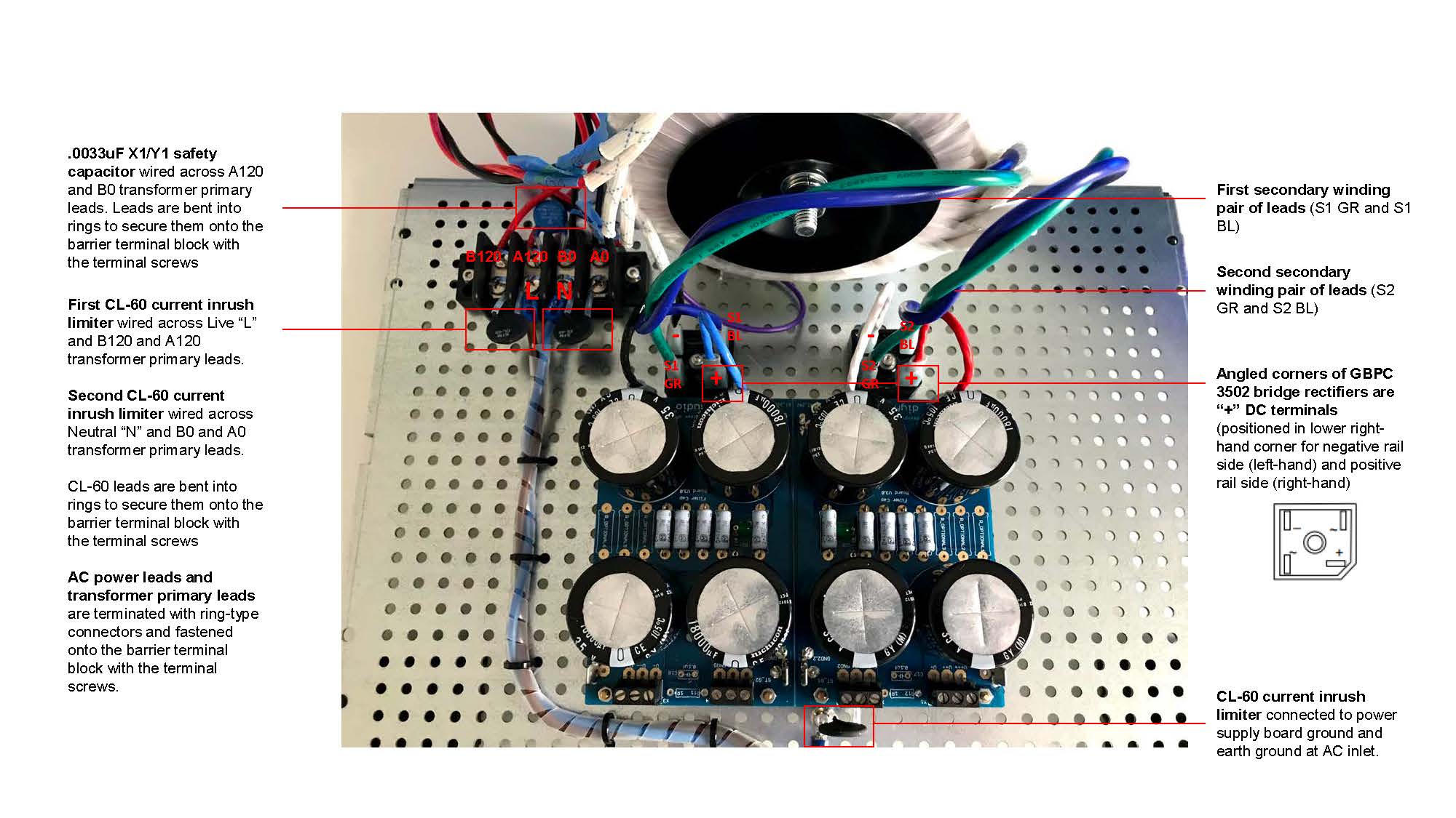

I recently built the power supply for the Aleph J and assembled an annotated photograph for the critical connections.
I will trim the transformer primaries leads and secondaries leads once I have the amp assembled and can determine the optimal rotational position of the transformer for least noise from interference.
The photo below shows more detail in mounting the third CL-60 inrush limiter between the amplifier ground and the earth ground and chassis. I formed one of the leads of the CL-60 into a ring and soldered it to the ring terminal connector on the earth ground lead, and then bolted that to the chassis.

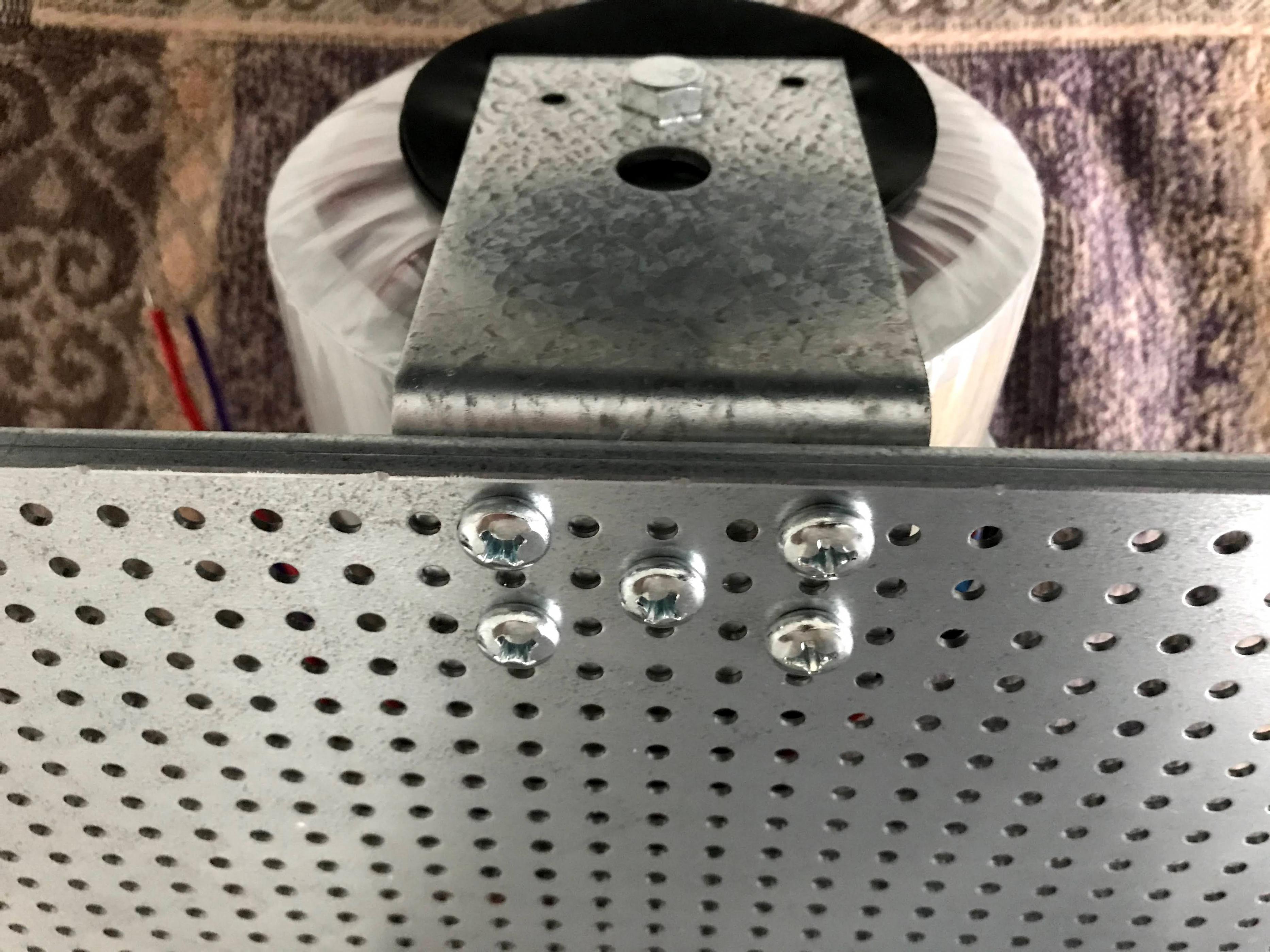

I followed Pechelman's recommendation on using the Simpson Strong-Tie A24 L-bracket. I little work on the drill press and some 6mm screws and Nylon lock-nuts made vertically mounting the transformer a breeze.
I double-checked all my connections and then used the dim bulb test on powering up the power supply. I got the momentary flash of the bulb, and there was no smoke, no sparks or any other drama. I measured -25V DC on the negative rail and +25V DC on the positive rail.
Good to go with mounting the Aleph J boards and wiring the amp. I still have to drill out some countersunk holes for the two LEDs on the 4U Deluxe chassis faceplate and a pair of 3/8 inch dia. holes on the back plate for RCA female jacks for single ended inputs to go with the XLR jacks for balanced signal inputs.
