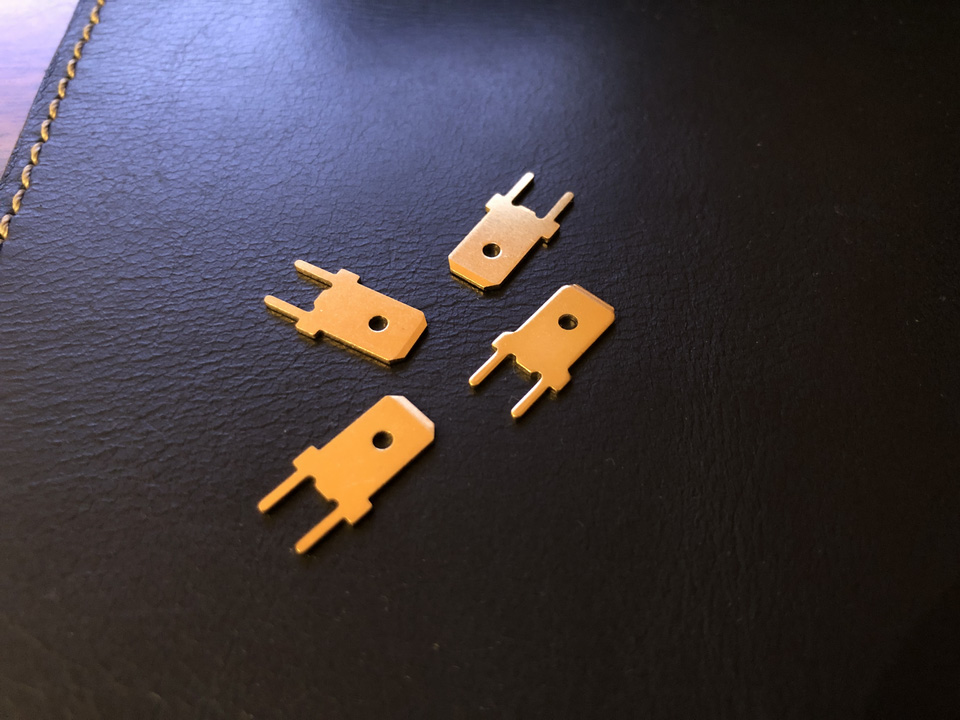

Could someone tell me the part # for the blade connectors please. I back to this build once again. thanks
There are a bunch, but these should work. You can even buy a reel of similar parts and cut them yourself if you need them in bulk and want to save a bit per part.
62409-1 TE Connectivity | Mouser
