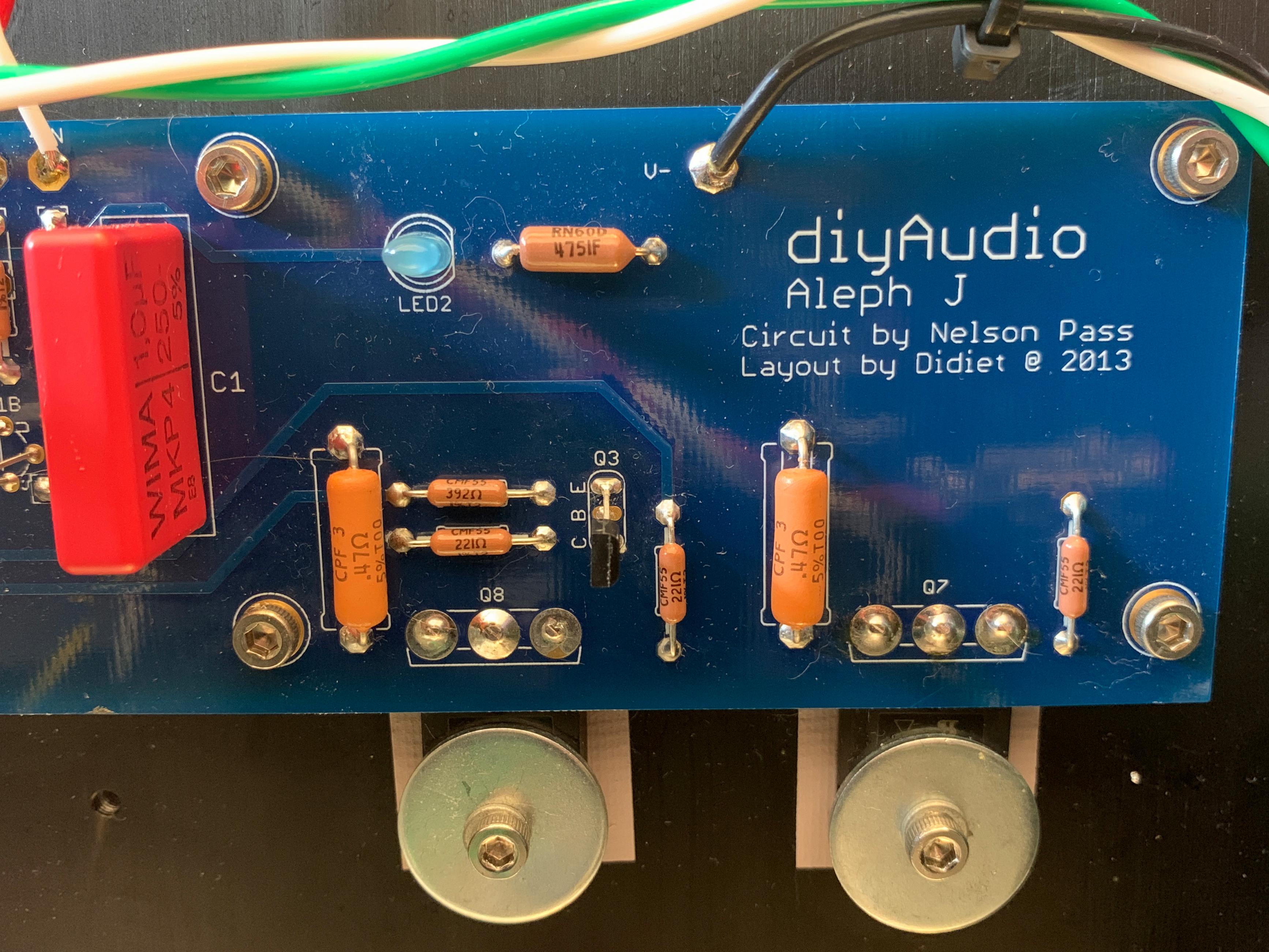

Here are two shots (left and right sides of the same board) of the channel that's not working. The opposite channel is working perfectly and shows zero DC offset at 400mv of bias. I will make your suggested measurements later today and get back to you with the results.

@bpr - Once you post some measurements, it'll be easier to nail down. Regardless of root cause determined, perhaps show a little more love to Q5. If you've soldered it from the top side, the joint on the gate may be a little sketchy long-term. I don't see anything that jumps out re: stuffing, but perhaps other eagle-eyed observers will notice something.
Nice photos. Easy for bad eyes to zoom in 🙂
Edited to add - Maybe a reflow for the gates of Q6 and Q8 too, since the iron's hot.

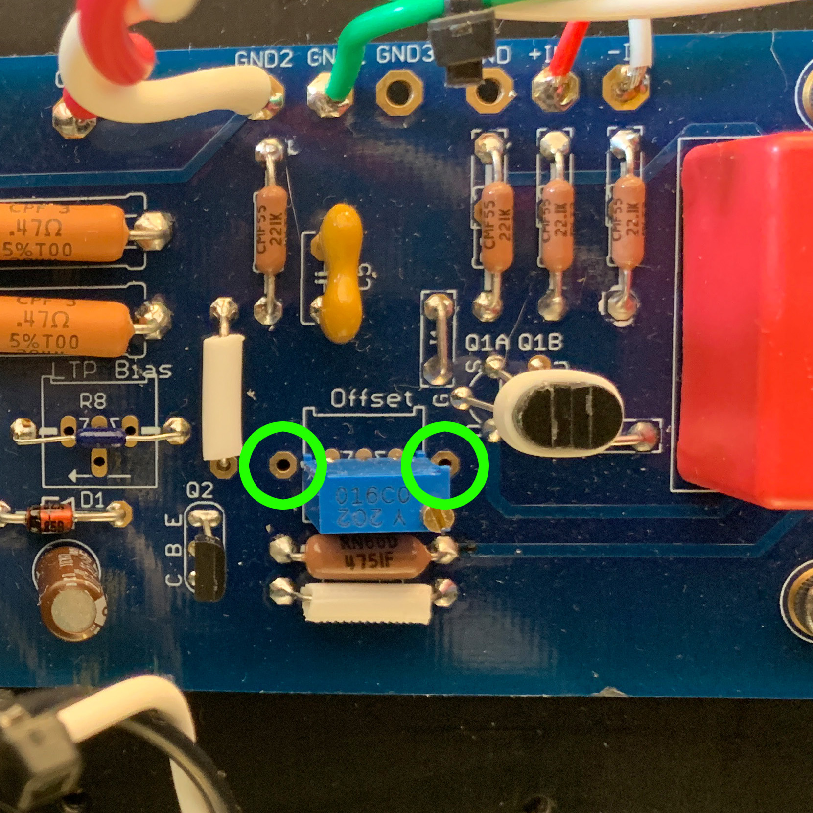

Help me make sure I'm measuring R7 properly. In the attached photo, I'm measuring the voltage drop across the pot at these two points (circled in green) on the board. Is this correct?
For measuring across R7, that is correct.

And to check, connecting -IN to GND is connecting the circled pads in the attached photo, yes?
Yes, that is the place for the jumper. Note, as 6L6 mentioned, you do not need the jumper if you are planning to wire only XLR inputs or both XLR and RCA. Then, you can choose to either have pin 1 from the XLR run to that point or to the chassis. That decision is yours, but there are strong well-founded opinions/reasons that Pin 1 should go to the chassis. If that was already your plan, then 🙂
