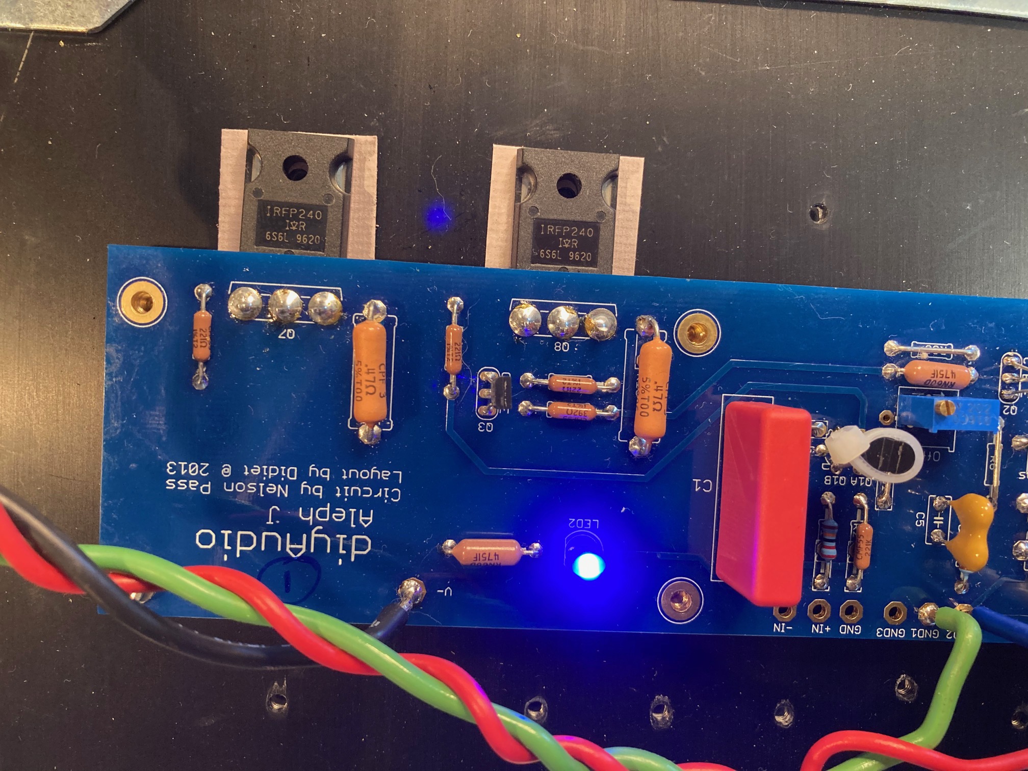

I'd replace Q1A, Q1B and Q2 first, WHILST at the same time, making sure the Q7 and Q8 are okay AND they are electrically isolated from the heatsink.
The new JFETs arrived yesterday, so I replaced Q1A and Q1B and the bad channel is now a good channel - working properly, heating up nicely and measuring almost perfectly - bias at 401mV and offset at 0.
Thanks again to you and everyone who chimed in with some ideas on what to check and what to fix. I really appreciate your wisdom and instruction.
I will hook up speakers tonight and spend some time with some music and some whiskey.

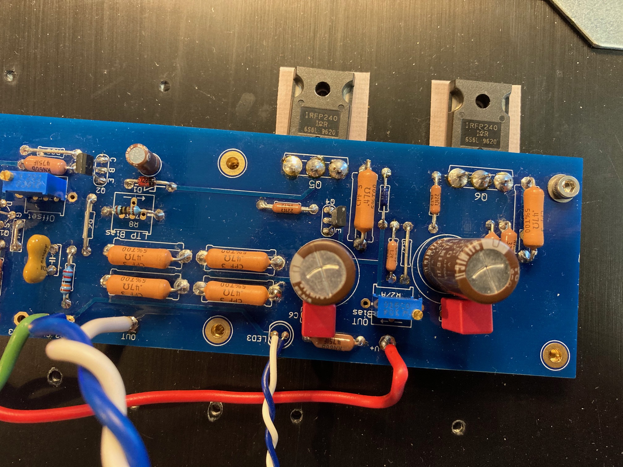

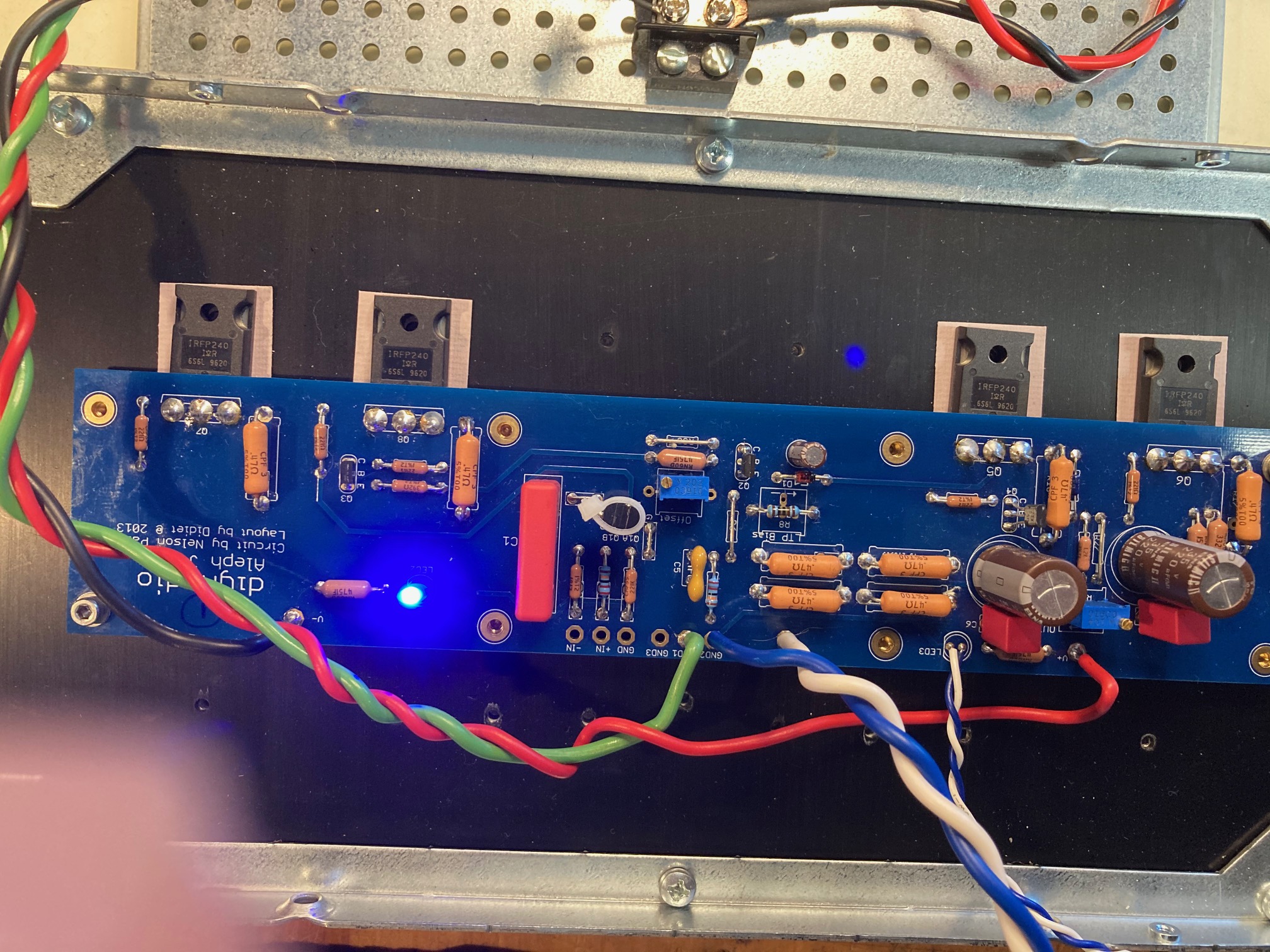

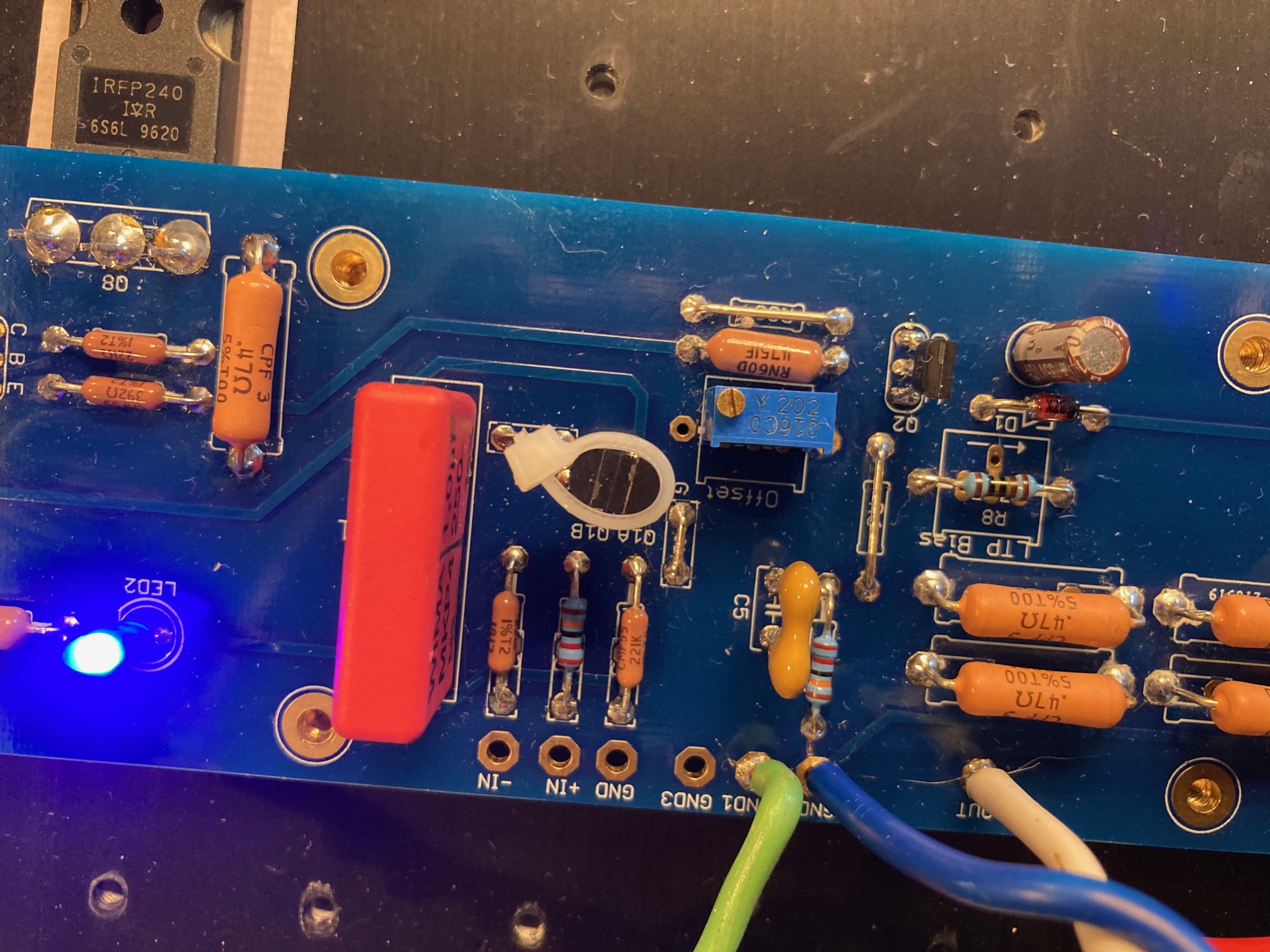

Aleph J assistance needed
I've been fighting with a faulty board for a while now and could really use some assistance. The power supply and one amp board are up and running as they should, but the second amp board is not working correctly. It powers up (without smoke) and the LEDs light up. However, there is no apparent response from adjusting either trim pot.
In assembling diagnostics I've followed the list provided by Extreme_Boky at post #5753, and as applied by Awajoy at # 5766. Also attached (I hope) are some photos of the faulty PCB.
Any suggestions or observations you may have will be very much appreciated!
