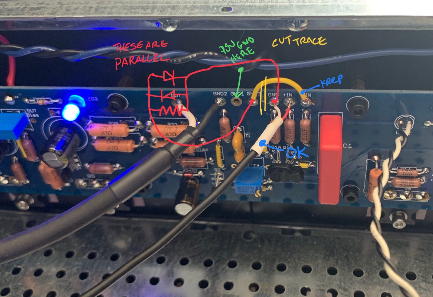

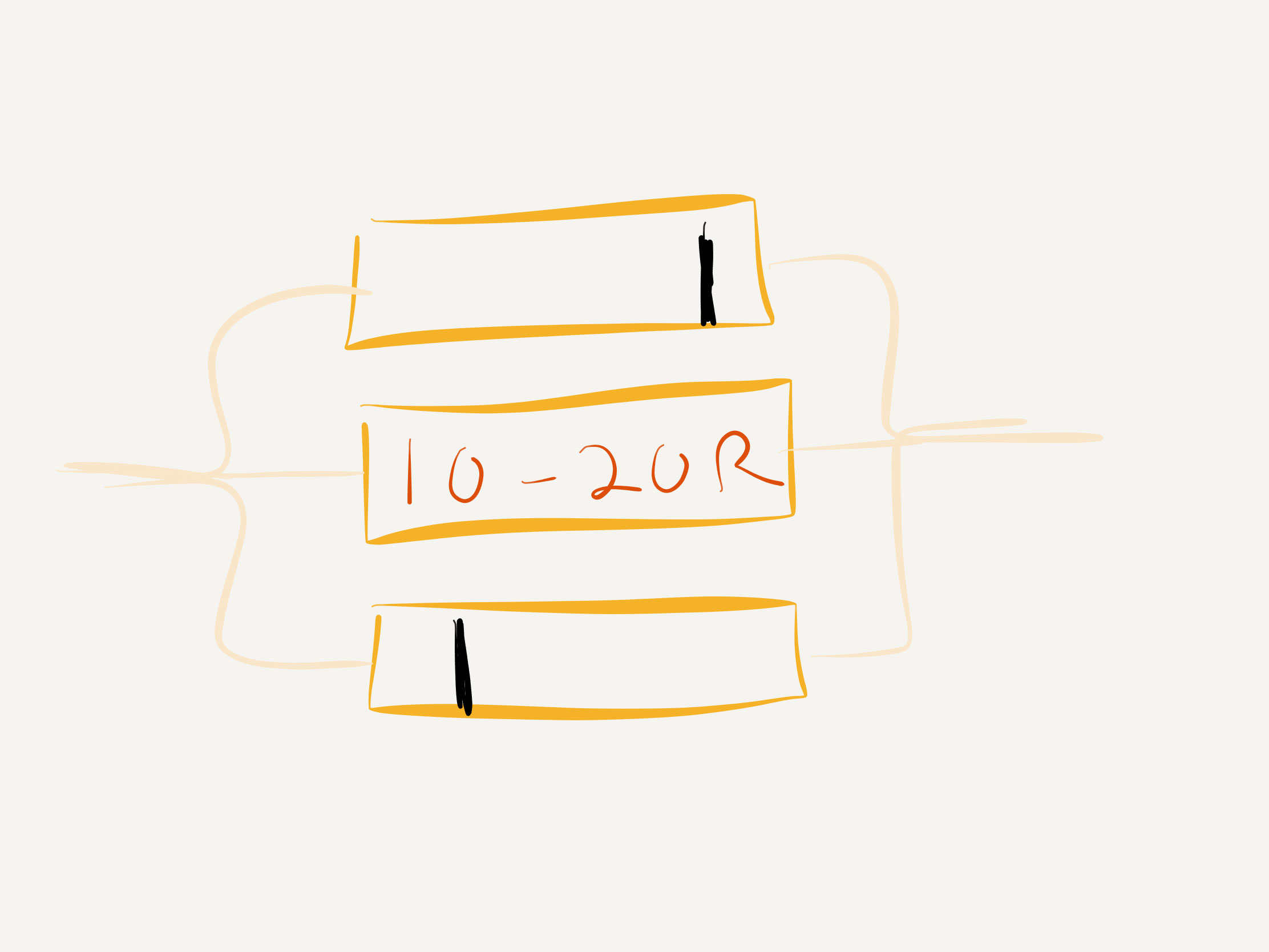

I love AJ. Here's some artwork by one of our venerable leaders (I hope he doesn't mind if I post it)—it is detailed in the hifisonix/bonsai "quiet amp" docs—though not specific to AJ.
I wasn't ever able to get my AJ quiet. Not truly anyway—Not like M2X monoblocks currently in play. It's on my list to mono-block the AJs to see what's what—or swap out the transformer etc.. Rotating the transformer while listening to the speaks is definitely worthwhile.
Hum breaking resistors also worthwhile—didn't cure my build though.

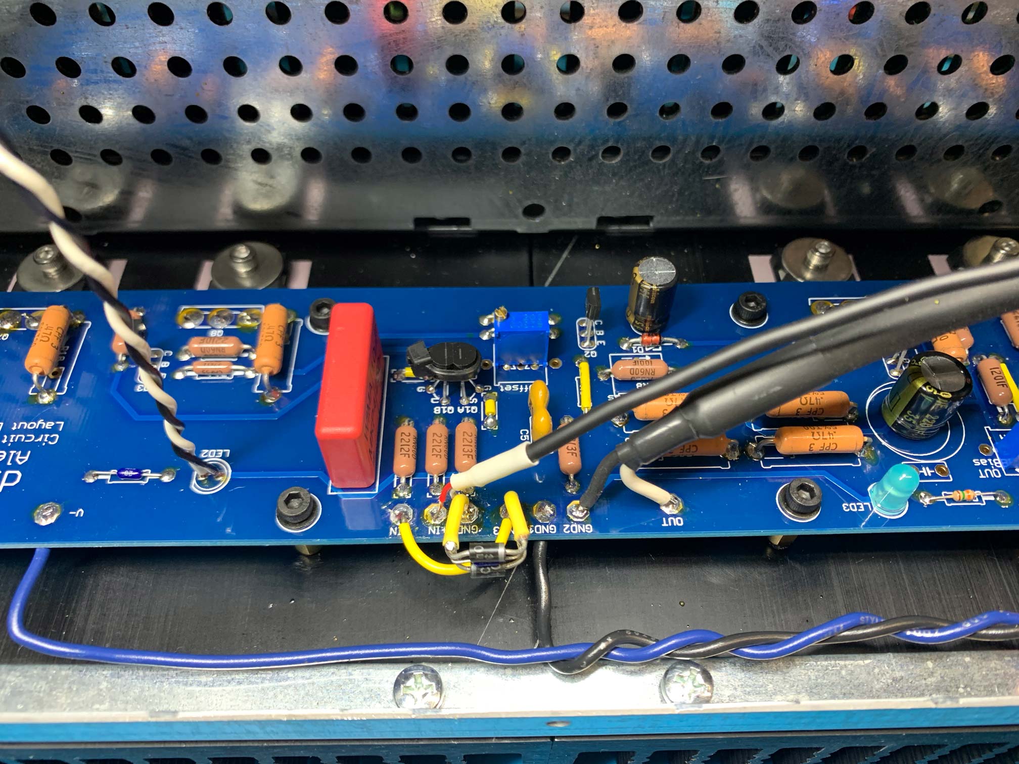

It seems to me that maybe there is a grounding anomaly that these two devices together aren't happy with.
Could you try modding an RCA cable so the grounds don't connect and only the center conductors do?
For testing purposes only of course.....
R6 and R30 - I'd suggest 0 ohms for the time being because this is likely a ground issue, because the amplifier works properly with other preamps...
