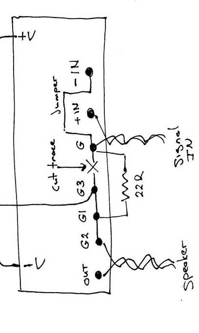

I get faint 100Hz buzz from my Aleph J, pretty sure it is due to "insufficient" filtering.

I had a bit of time to play with this faint buzz this Australia Day long weekend... so I tried few things. I moved the speaker return from the amp PCB to the power supply PCB. No change. Pretty much anything I did made no change whatsoever...
And then I decided to use my 600-ohm headphones connected straight to the speaker binding posts to be able to hear this faint buzz better while playing with grounding. Well, the headphones made this buzz really audible, so I knew right there and at that very moment what the problem was.... and reached for a Stanley knife and a 9-ohm resistor, in it went between speaker ground and signal ground on amp PCB. Buzz gone, me very happy... amp absolutely dead quiet... like it's not ON.
I also tried feeding the input signal to -IN... and didn't like it.
Stanley knife? Did you have to cut a trace?
My take on Ajeph J grounding:
The ground potential on the Aleph J AMP PCB is used solely for one purpose - to provide a return for the analog input signal, which must be referenced to the "global" ground potential somehow. The input signal return current is extremely small due to the nature of how the JFET's work / very high input impedance. There's also a current going to the ground potential as the result of negative feedback (all ÄC audible frequency range currents, very close to DC, but excluding the DC)
Hence, there's no need to bring the large speaker return currents to the AMP PCB; especially not so close to the input ground. We are also dealing with a very high impedance and bandwidth (read: very sensitive) amplifier. These facts could cause a faint buzz, which can be completely eliminated by cutting the track and inserting the 10-ohm resistor. There's no need for any other change.
In general, the speaker return should not really be going to the AMP PCB at all; instead, it should go to the power supply PCB -> the secondary windings' common point. However, Alep J does not have this point, so.... the closest point that will do a remarkable job as a speaker return (negative), is marked with an "X".

This is what helped me eliminate the buzz completely. I could not tell if the amplifier was ON. I could not even hear the hiss (broad-spectrum high-frequency noise) neither. Very impressive.
It's a bit hard to understand how you modified the circuit of your amp. Can you show the Aleph J schematic with your modification? Can you explain the idea of why you did the modification in this way?

both ways ( LS GND taken from cap bank pcb or from main pcb) are completely OK
condition for later is that GND on main pcb is routed accordingly
no problem when you're doing it as Papa - pads in closest proximity and no current pumping through traces
OK , matter of approach , I know Papa's reasons why he's doing it like that in most amps, irrelevant is there NFB or not ..... but - with amps having NFB , that's the way to have tighter NFB loop , taking in game that part of speaker return
go figure ..... and make your own

Hmm, I don't quite see the purpose of splitting GND into speaker-GND and input-GND. Are you maybe fighting a ground loop via chassis/protective earth? Is the hum still there if you leave the amp input unconnected to the source?Jim made this suggestion to me while I was trying to track down some hum a short while ago. Here is the diagram that I used - it works very well. It decouples signal ground from PSU ground.

I did have some hum that I was trying to solve and didn't know the source of the hum. Cutting this trace and inserting a resistor did indeed reduce the amount of hum I had by a considerable and audible amount. As it turns out, the problem was nothing more than a dumb mistake I made while wiring my PSU caps - I soldered to a mounting leg, not the pole for the cap... Discussion starts here.

On that note.... Aleph J is not a fully balanced amplifier; the amp PCB still requires a ground potential (referenced to the power supply ground) to work properly, even if a fully balanced input signal is used. In other words, feeding the balanced audio signal will not make any difference with regard to the mains' 100 (120) Hz buzz. If Alep J has a faint buzz, the balanced signal at its input will not make much of a difference.
