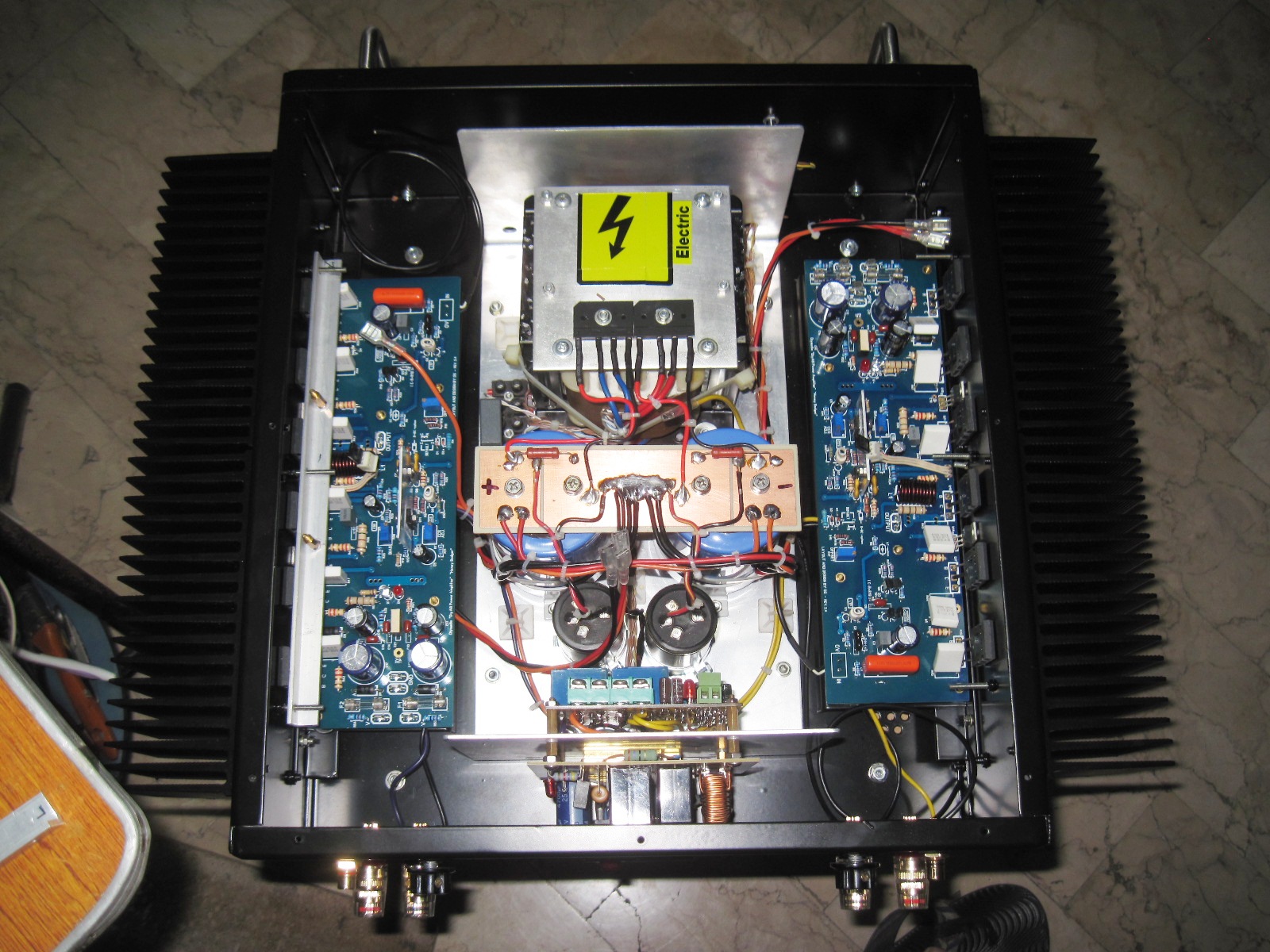

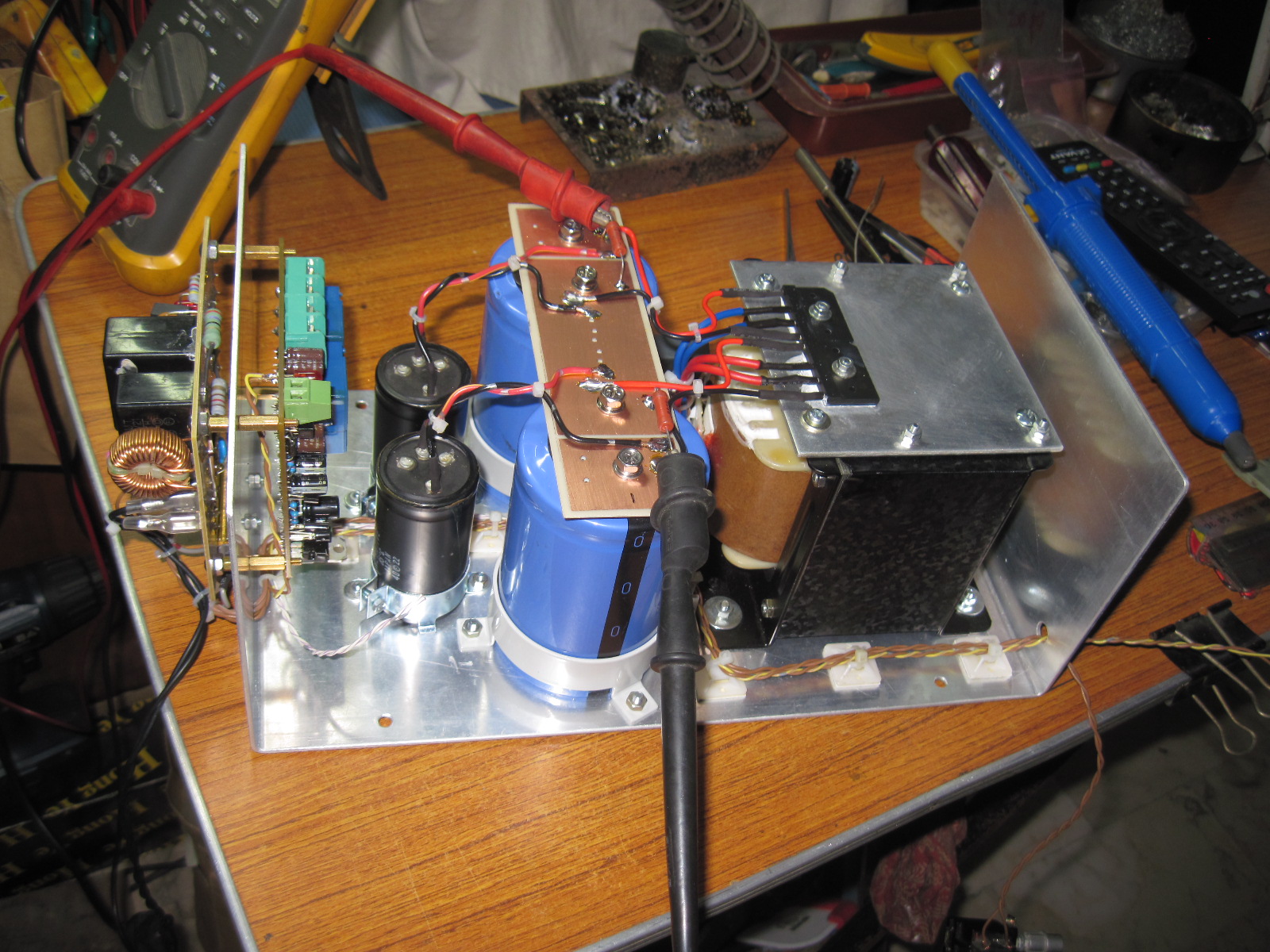

re grounding:
this worked for me....
1. each power supply lead have its own ground return wire that goes to psu 0 volt point..
2. these form a twisted pair..
3. all 0 volt return wires are soldered to a single psu 0 volt point..
4. the PSU 0 volt point is connected to the chassis at only one spot... and sometimes you can not like when using plastic casings like i do..
5. i will not let the signal ground return wire ride on any psu ground return wire, i use a separate wire for that..
so to get to the bottom of this grounding issue is to start from the PSU ground..

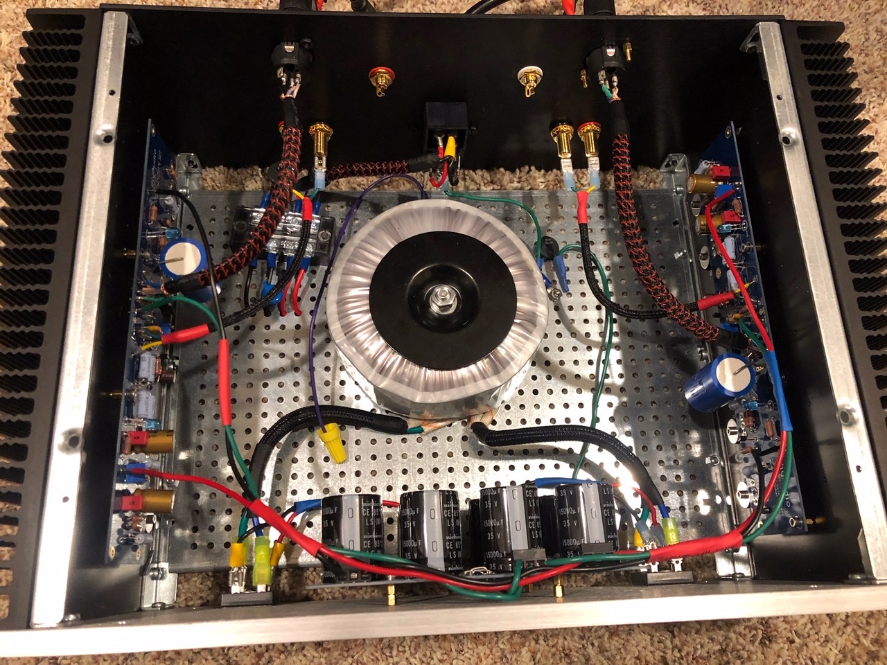

Just finish my Aleph J. I was able to do it from beginning to end without asking a single stupid question so that’s an accomplishment :lickface:
It was really easy to bias and do the offset..... compared to the F5 and also seems to run much hotter.
The transformer buzzes slightly but you can’t hear it with the lid on.
There is a very fain buzz coming from both speakers, but I have to really stick my ear into my speakers to hear it. I’m sure my OCD will get me tinkering around with fixing it but for now I’d rather just listen to some music.
Here are some pics - Aleph J Clone - Google Photos

Well done Mrshazbot.
Nice build.
Check the post# 4565; it explains how to get rid-off the buzz.
The left channel input wiring runs in parallel with mains wiring/terminal block. It may help if you position the input wiring close to the heatsink.
Is the purple cable with the yellow termination the electrostatic shield from the transformer? I can't tell if it's connected. Shouldn't this be connected to your star ground?

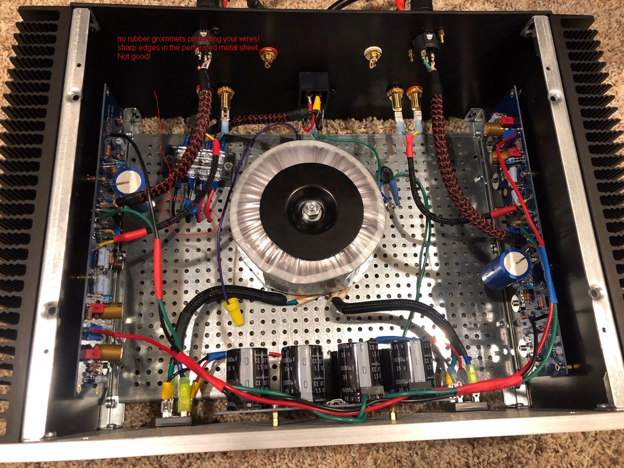

to Mrshazbot #4612
Hello Mrshazbot,
a very nice amp! Congrats.
Only one annotation:
your cables/wires run unprotected through the perforated metal sheet.
I think there are some sharp edges. Rubber grommets between the cables and metal would be great. 🙄
Only a thought!
Greets
Dirk 😉

Great Build Mrshazbot🙂
What size transformer did you use? I am trying to figure out if a 500va is "enough" or 600va would be better.
How did you wire your termistors? I am assuming this is to prevent having a Soft start module?
Have you used Clarity MKP as your input couplings caps?
/Mikkel
Agreed on the grommets... or at least drilling some bigger holes. That was my intention then I never did it and I need to go back and fix that. I also need to connect the SE inputs.
The purple wire got connected to the ground point also. I left it loose for curiosity, so I could connect and unconnected it to ground and see if it did something noticeable, which it didn’t.
