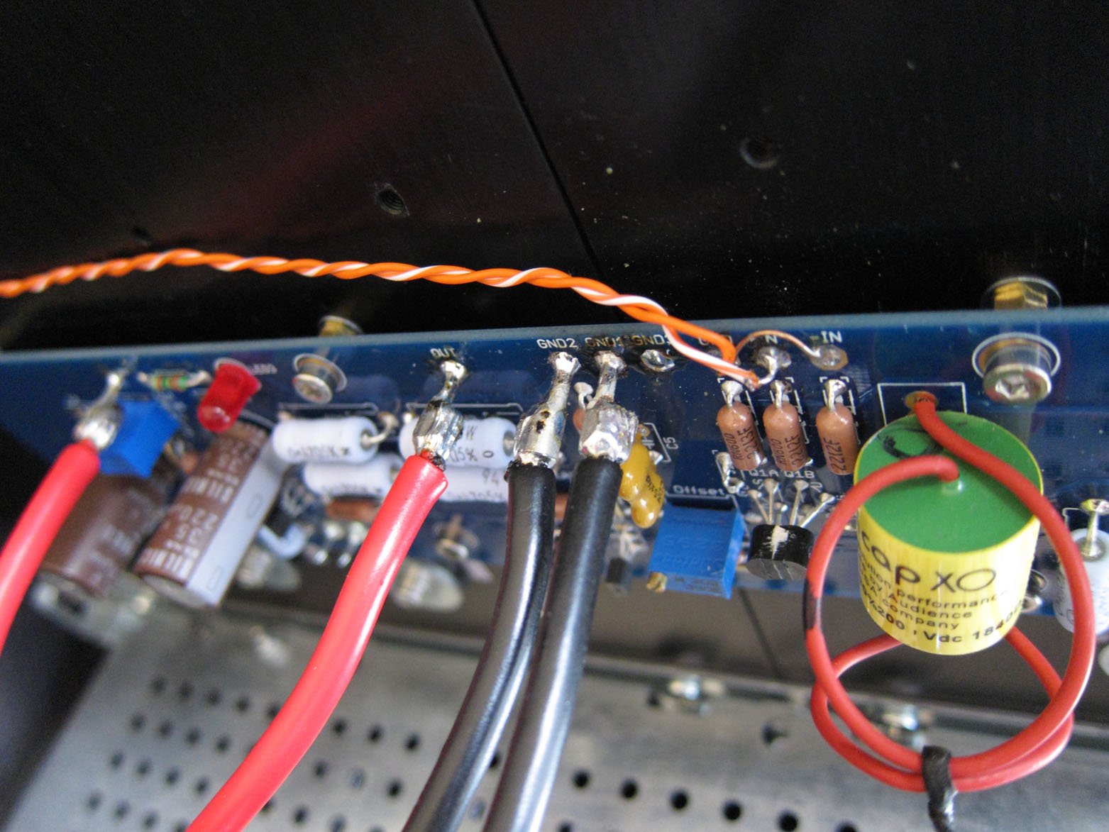

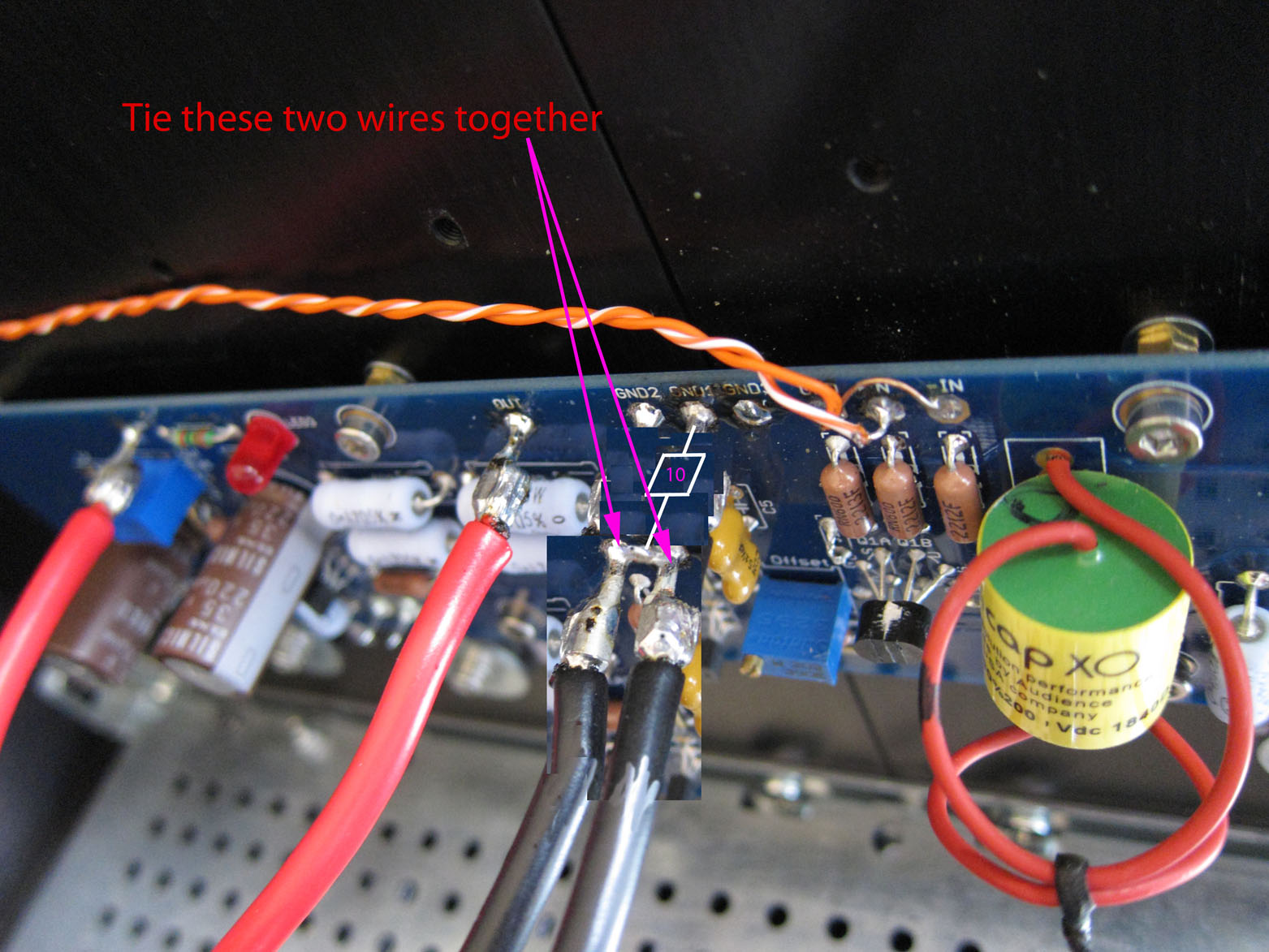

I know it's not easy to remove the PCB's from an amp, cut the trace, insert the 10-20ohm resistor, mount everything back... so, I remembered what I did to TEST if my suggestion is going to work first, before doing all the hard work. So, here it is:
Check the attached photos. Quickly scroll between "Before" and "After"... and you'll get what I mean...
1. Unsolder both GND wires (one coming from the PS, the other coming from the speaker's negative binding post)
2. Tie them (solder them) together.
3. Leave them "floating in the air"
4. Solder the 10-ohm resistor to the end of these two wires.
5. Solder the other end of the resistor to GND on the PCB
Turn the amp on. The buzz will be gone (hopefully).
If it is not gone, look elsewhere for the root cause... remove the resistor, unsolder the wires, and then solder them back to the PCB.

Of course, if the buzz is gone.... you can then choose between these two options:
Leave everything as-is and enjoy life.
or
Do it properly (remove amp PCB's, cut trace, place the resistor on the underside, put everything back...)
The side NOTE: Looking at the "After" photo.... isn't it obvious that the speaker return should NOT go to amp PCB??
Just sayin'...

I still don't understand the idea of splitting GND into speaker-GND and input-GND (see my earlier post).
I totally agree with your suggestion of looking for the root cause of the hum. However, blindly inserting resistors without understanding what's going on does not seem right.
So, I ask again: what is the background idea of splitting GND into two different GNDs with a resistor???
Ouch.
There are better ways of avoiding ground loops via mains / chassis / protective earth that do not mess with the audio signal connections.

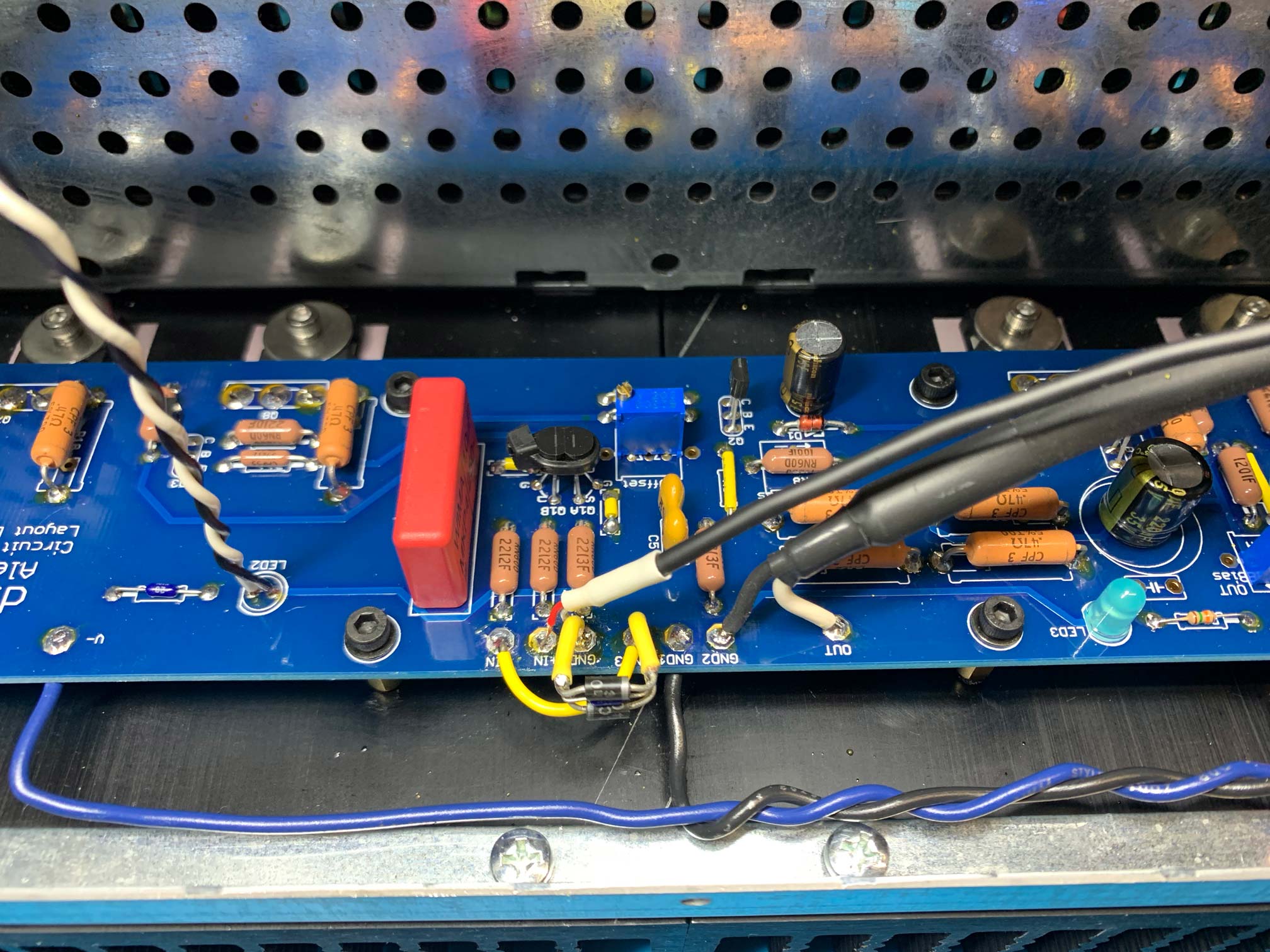

Didn't solve my hum issue...
Because you did not wire it correctly... you are feeding the dirty ground potential straight into -IN
The link between -IN and GND goes "too far", it should go to the GND eyelet CLOSEST to the -IN eyelet. This GND is a clean ground.
- Aleph J illustrated build guide
