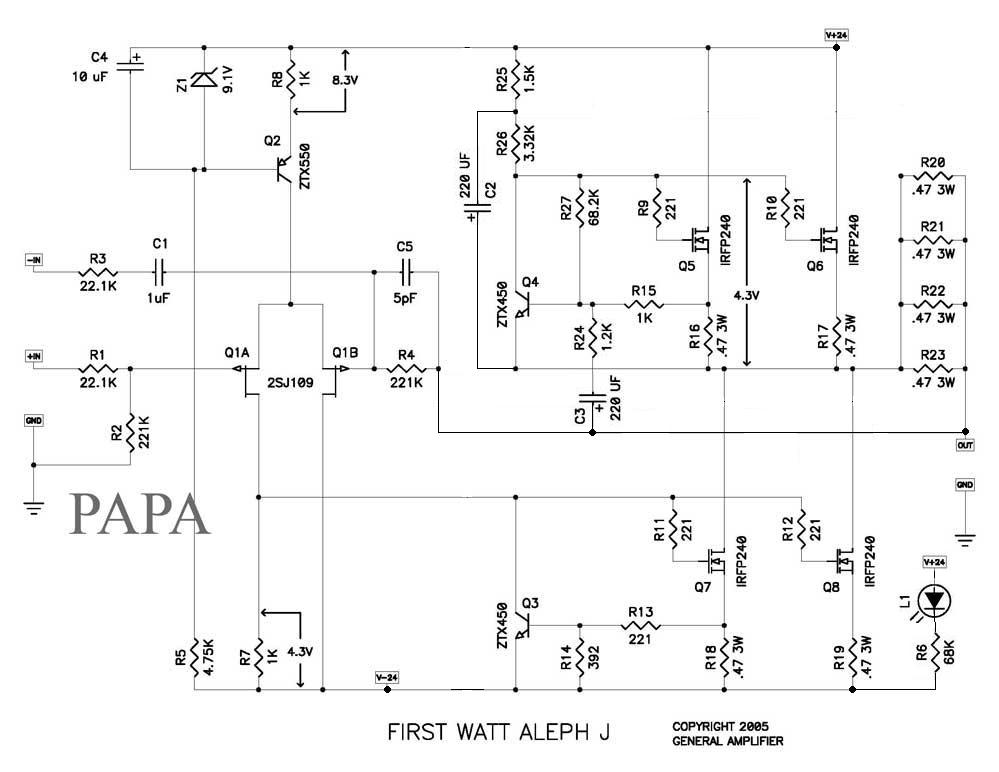

I found myself trying to put together AJ on A30 board just for fun. I took many hours examining and cross referencing official A30 schematic with AJ schematic and think I have taken the necessary modifications so here is where the fun begins.
Because this is an experiment, I took old ZTX450/550 and J74 that I had removed from old projects and tested in $10 tester. Everything seems ok. IRFP240 are used as well.
I fired it up and see a nice 8.3V across R8 but only 3.43V across R7 and across the CCS according to this schematic:
No warm glow from the source resistors and mosfets yet. I have 2K pot in R7 and 100K pot in R27. With R27 at full resistance, I see a few millivolts across source resistors and since I have R27 installed with socket pin headers, once I left the pot out and turned it on and it started to warm up but I wasn't reading voltages and turned it off before I let out any magic smoke. Does it sound like everything is still working and anything I should check/adjust? Right now I have 1K resistor in R8. 2K pot in R7 initially set at 1K and I can adjust down any offset to 0.00mV easily.
Suggestions? Worst case I'll put small mosfets in place of jfets and call it A30.

I have not installed C4 (10uF across 9.1V zener) yet if it makes a difference. It doesn't make any difference temporarily but I will install it if this thing works. What is the purpose of C4?
Zeners are noisy... C4 is there to couple the noise from the B2 base, to its "virtual ground return", which in this case, for Q2 -> is the V+ rail.
JFET's are sensitive to static discharge. You HAVE to use an antistatic wrist band correctly connected to a ground potential whilst handling the little buggers. My bet is that you damaged the JFET's... the output MOSFET's will not start conducting properly unless the voltage drop across R7 is at least 4.3V... so, the current through the Q1A is not sufficient at the moment to generate a required voltage drop; hence my diagnostics re: damaged JFET's.

Swapped out the J74 pair, soldered in pin headers and tried fresh jfets but the result is still the same - 3.6V across R7 and across the CCS.
Are the JFET's from the appropriate grade (BL)?
The current through that R7 is not large enough... this should help you fault-find...
