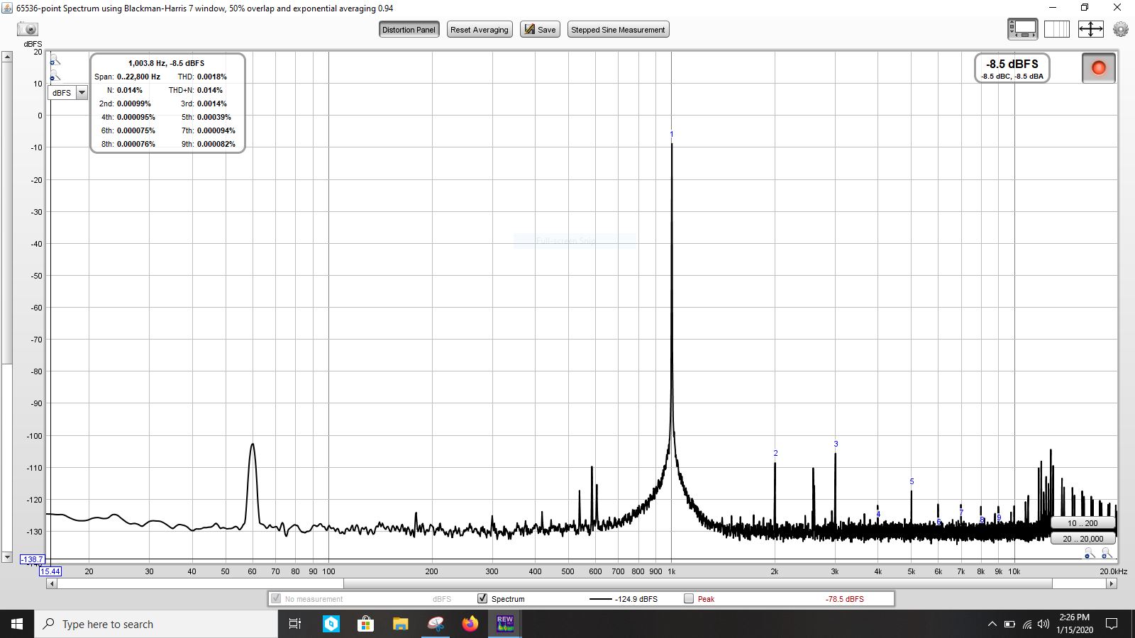

Here is a loop back test with the Akitika 1kHZ sine wave generator into a Behringer UM2 sound card feeding my laptop, everything is operating on batteries, yet that 60Hz noise is still there.

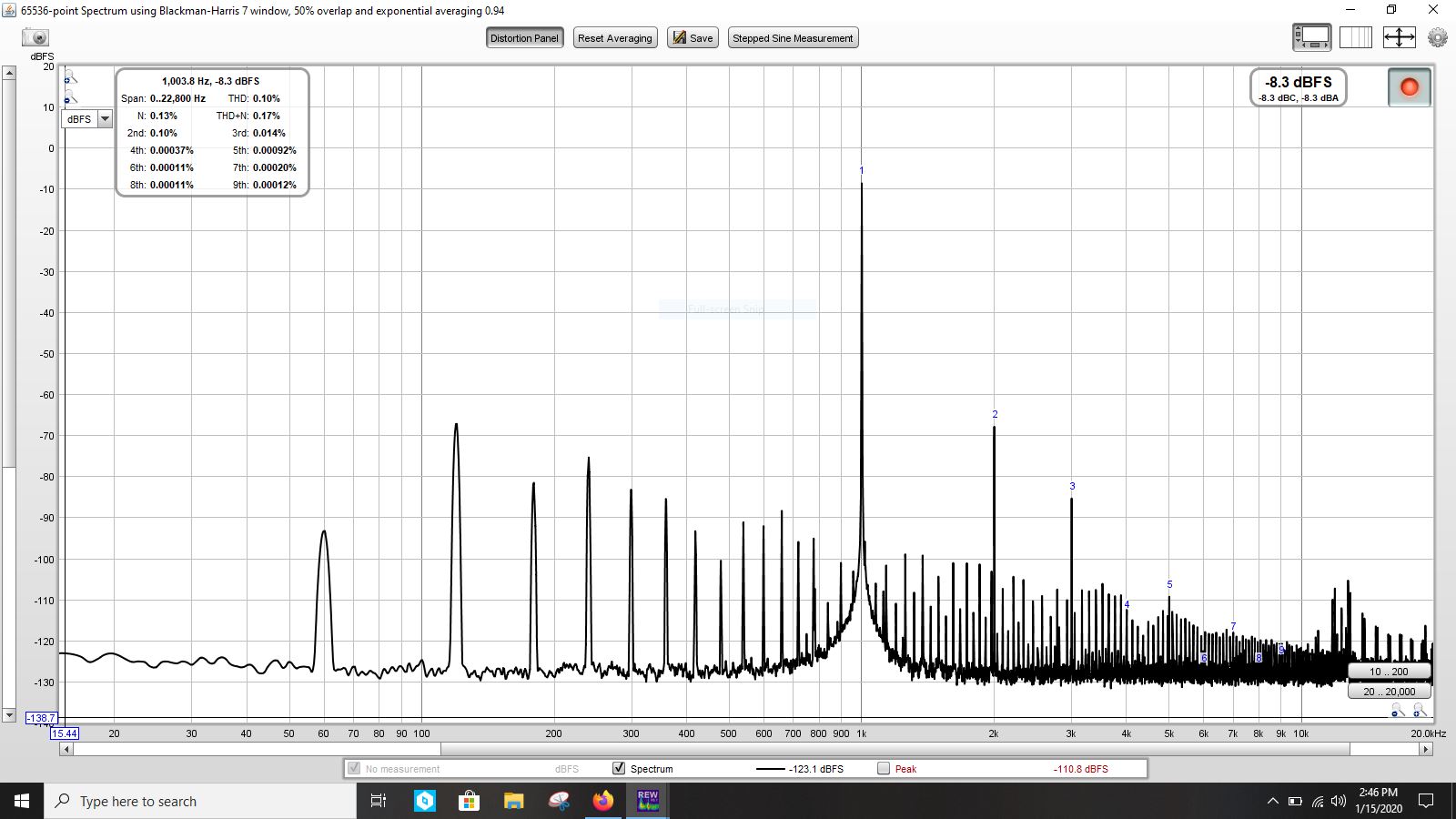

I measured the A/C from the power supply out and have 35mV. I raised the bias to 410mV and reset offset to 0 VDC, here is the results, 2 V output into 4 ohm load. I increased the output of the sound card to just below clipping. The 60Hz, 120Hz, 180Hz etc noise is from the Akitika 1kHz sine wave generator.

Playing music now! Full volume and my head in the speaker box, no hum or noise for that matter, using balanced inputs from my BZLS. Curious to see if B1Korg or H2 preamps would be "to much of a good thing."
Great sounding amp, and this is just the first hour.
