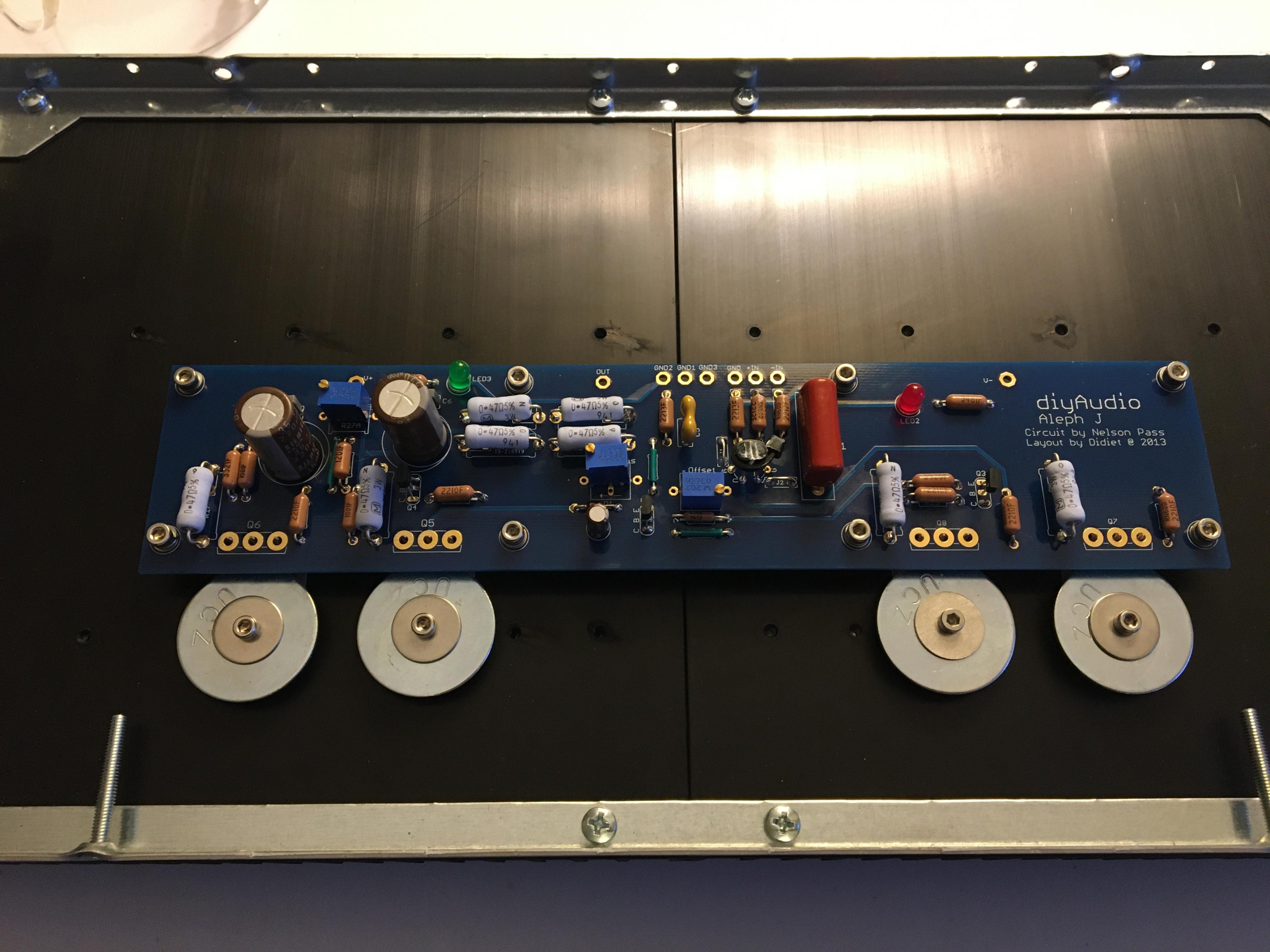

Elwood625's suggestion a few pages back of securing the mosfets with small heat sinks made sense to me - particularly in terms applying even pressure across the entire mosfet for better contact with the main heatsink. I didn't want to wait for heatsinks to be delivered though, so thought I'd just try large washers. Before I solder them, just want to check with the brain trust here: would there be any disadvantage or problem using the bigger washers that I'm not considering?
All you need are the "gold" colored washers, I'm concerned the silver colored ones may be to big in diameter and to close to the pins of the MOSFET. I've had power transistors arc to heat sinks/washers to close to pins.
Thanks for the caution, elwood625. I guess for now I'll stick with the standard washers. I'm too eager to keep moving on the build! I suppose it would be pretty easy to add heatsinks or a slightly larger gold washer down the road without have to reflow the solder. Thanks!
The bigger washers are an advantage. The big washer applies even pressure over a large area of the mosfet against the heat sink. There is good for even flow of heat to the heat sink as you have mentioned.
The heat sink material may not be as thick as the washer so it may not be as good in distributing the clamping pressure.
A small or thin washer concentrates the clamping force of the screw over a smaller area of the mosfet, so the flow of heat is not as efficient.
Furthermore, the concentration of clamping force over a smaller area physically stresses the mosfet in flexure.
PS: As long as the washers are not so big that they are a problem as mentioned by Elwood625.

I'd put my money in Belleville washers. If not properly torqued it's possible that neither the little nor the big washer will be doing anything after a bunch of heat cycles.
I haven't heard "Belleville washer" in decades, nice to hear the real name, here in the US, wavy washer. Every bolt should have a lock washer and then a flat washer for the lock washer to grip.
Don't forget anti-sieze compound on steel bolts threaded into alloy. Protects the threads from pulling and prevents corrosion between the different metals.
