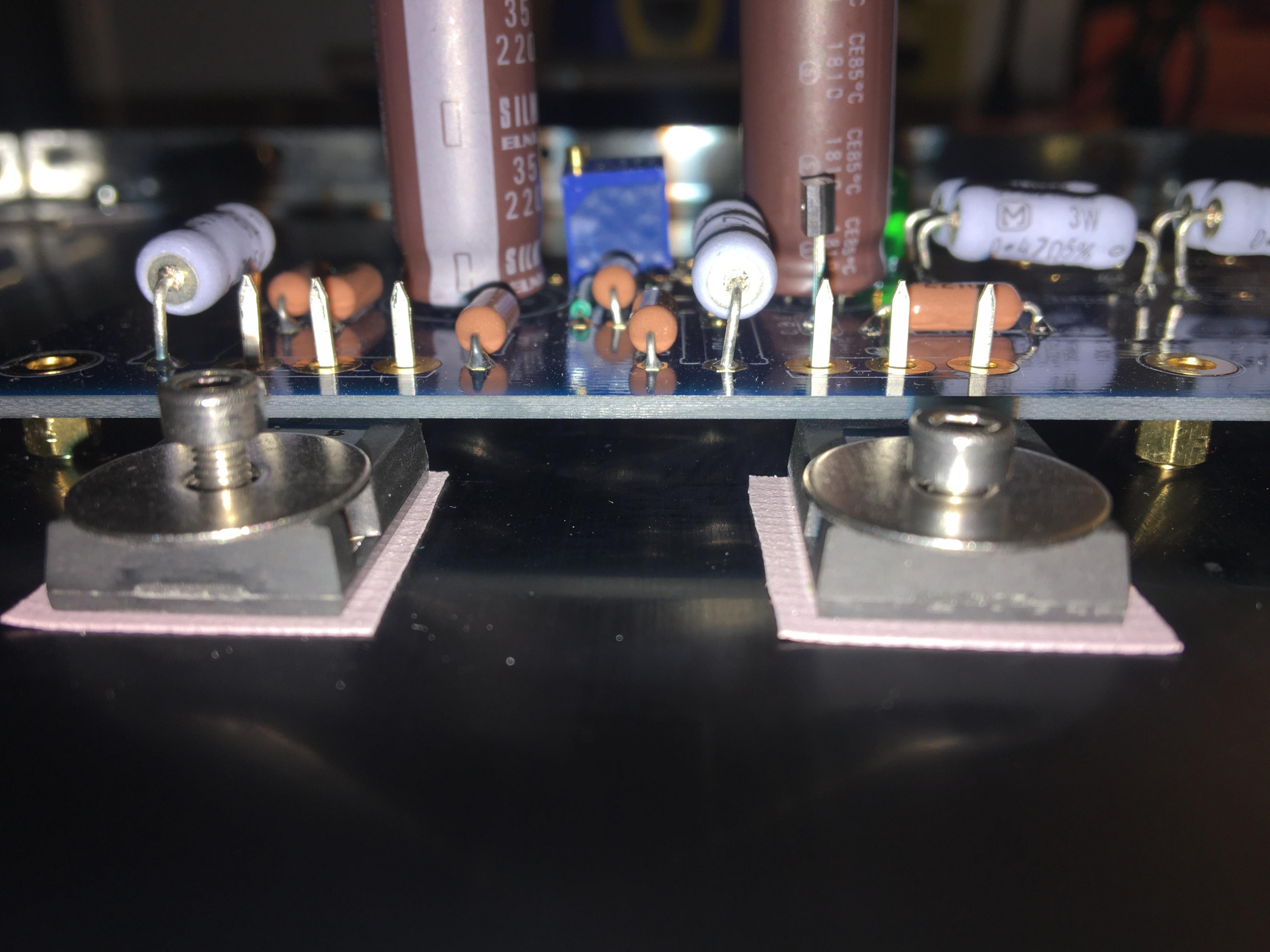

Quick question about mounting the mosfets: should there be some airspace between the top of the mosfet and the bottom of the PCB? I don't think they are currently touching, but they're mighty close. Wondering if I should add a spacer to raise up the PCB a bit...

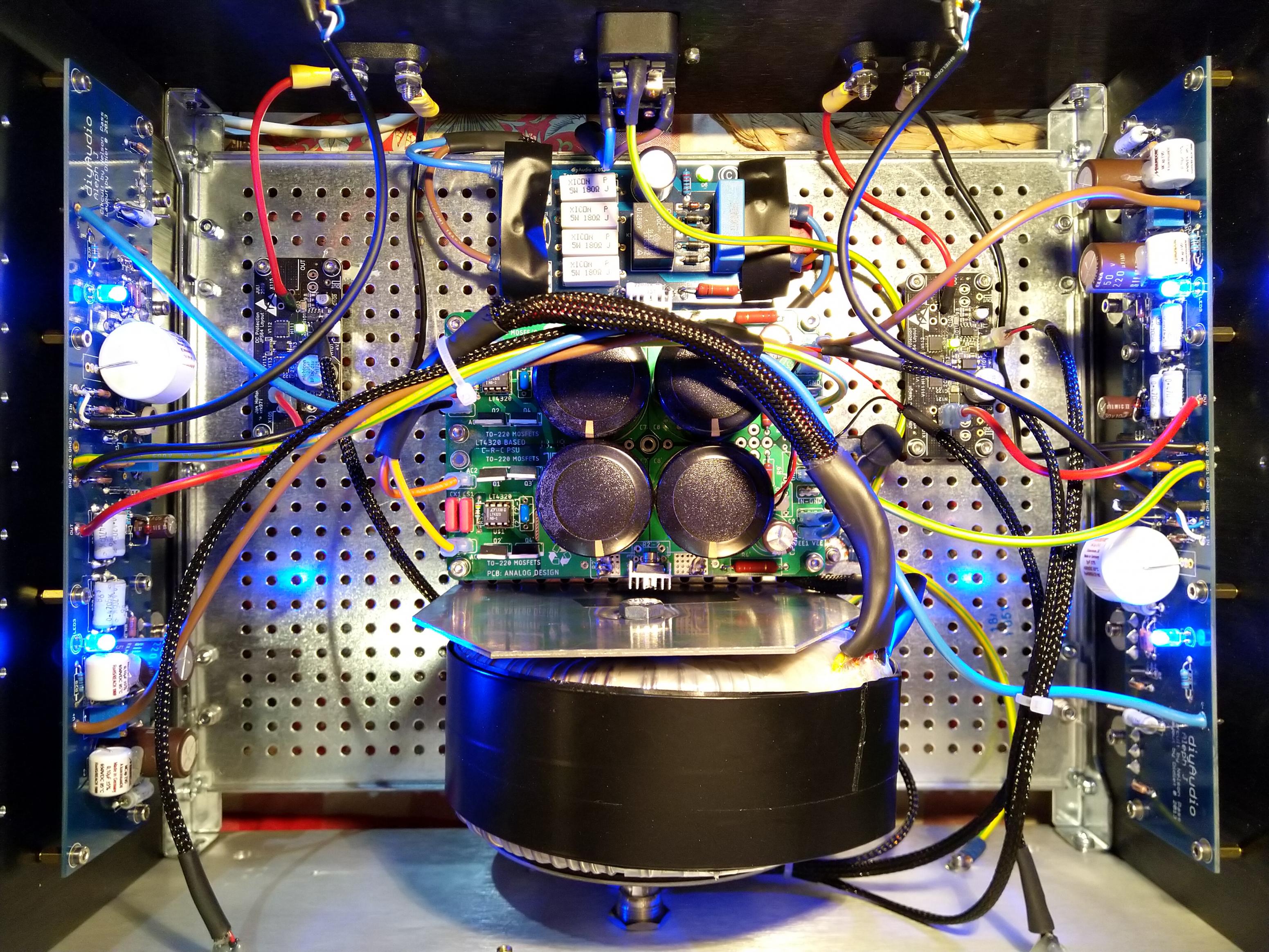

Here are the photos... I tried playing with ground topology; this did not affect anything, the amp is quiet from that point of view.
As per codyt reply (thanks!!), I think the buzz might be as the result of a very little voltage drop caused by dual diodes I used. Once again, It is very faint and I think Nelson mentioned that FW Aleph J also had it... but was noticeable only when his customers were placing their heads inside the speaker cabinets 🙂

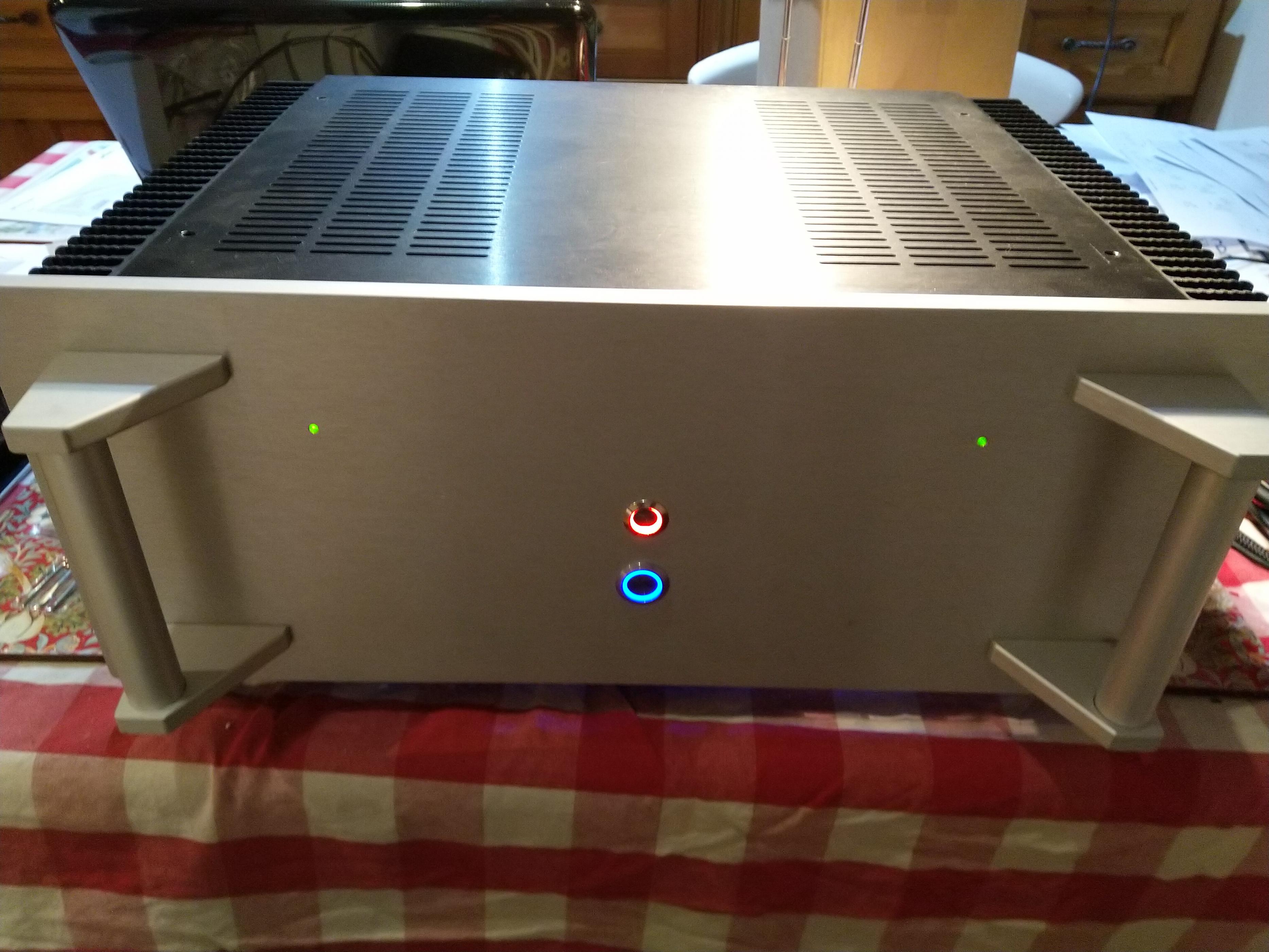

Good news! After a month of waiting for some more LSJ74's to arrive in the UK Aleph J no2 is alive 😀
It is currently cooking slowly waiting for another check of bias and offset.
I think I damaged the JFETs with the zip tie when I pulled them together as the leg broke off one of them when I desoldered it..
Finally I will be able to listen to them!

Congratulations, nice build! Which speaker protection boards did you use?
