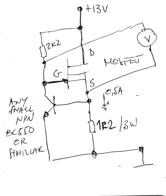

I have a really stupid question.
I am trying to match my IRFP240s. I have calculated that with a 24V supply that I will need a 25 Ohm resistor for the correct current.
So, while I wait for the 24V PSU that I ordered, I used a normal 12V PC PSU to check things out. I am seeing a Vgs of around 7.8V. I was not expecting it to be so high, and I am dropping 4V over the 25 Ohm resistor which gives my about 160mA.
What is going on here?
BTW, I have mounted the MOSFET on a heatsink, but it is not even getting slightly hot.
Can you show how you are hooking things up/schematics used for your measurement?
Maybe someone will spot something.
I am using the diagram as pictured on the last page of this document: PassDiy
I will check out your way, ZM.
Yes, I am using 22 AWG wire to connect the lot up, as in the attached pic. The resistor is a Caddock MP820.
for what Iq you intend to match?
Around 800mA ZM.
(24V - 4V)/0.8A = 25 Ohm.
This was just test run with 12V PSU to see if there were issues, and there was. Monday I get the 24V PSU to do real Iq test. Electronics is funny business sometimes, makes me scratch my head.
