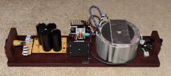

I'm having a problem with hum in my completed Aleph-J and hoping someone can provide some insight for me.
I am using a modular power supply that I've used with my F4 and M2 with no problems, so I'm assuming that the problem lies with my Aleph-J, but I could be wrong. The power supply uses a single transformer with dual secondaries. Each secondary goes to a Tea-Bag rectifier board with diodes mounted on a small sink. From there, each rail goes through two caps (four in total) then through a bank of 6x0R47 3w resistors, then to the power umbilical. Once inside the amp, each channel has its own cap on the pos and neg rail (total of 4 caps inside the amp).
So here is the hum behavior. I am using a single test speaker and a Y-cable that plugs into my iPad for input.
-When both RCA inputs are open (no connection at all), I get a low level hum out of the speaker (only have a single test speaker)
-Single RCA input shorted, that channel is dead quiet
-With one RCA input connected, 1/8" jack disconnected, very low level hum
-One RCA input connected, 1/8" jack plugged into iPad, dead quiet
-With both RCA inputs connected, 1/8" jack disconnected: very low level hum
-With both RCA inputs connected, 1/8" jack plugged into iPad: more pronounced hum

Through your photos I have the question of your input signal wires on top of your power wires ? Have you tried routing your power or your signal wire differently so they’re nowhere close to your power feed ?.
ThermalAlchemy: In order to trouble shoot the amp, I have disassembled the chassis and all of the wires now have plenty of clearance. The hum issues remain. I am thinking it is something related to a ground loop because the hum is worst when the second RCA input jack is connected. This forms a loop because the ground from each channel meet before exiting the chassis at the power umbilical. Odd that this power supply does not cause any problems for my F4. This makes me think it is something in my Aleph-J. The sinks of the Aleph-J are grounded to each channel's PCB.

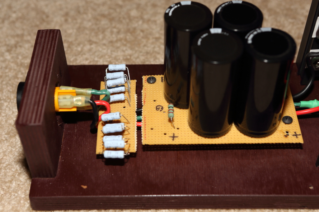

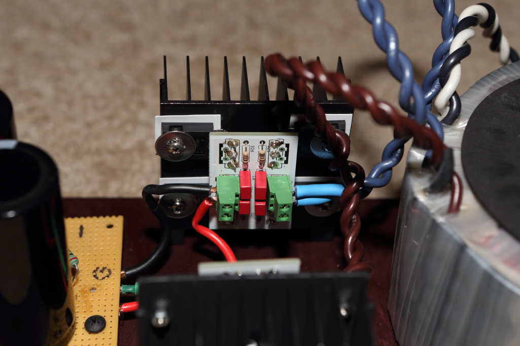

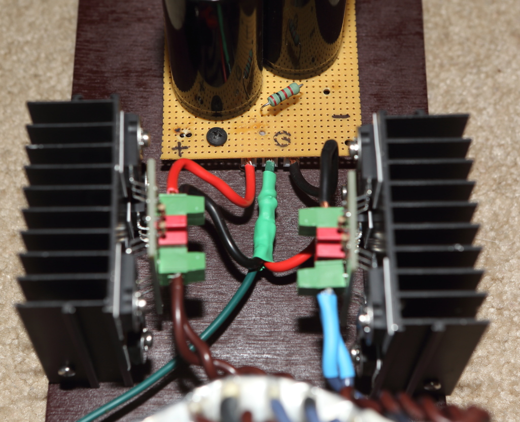

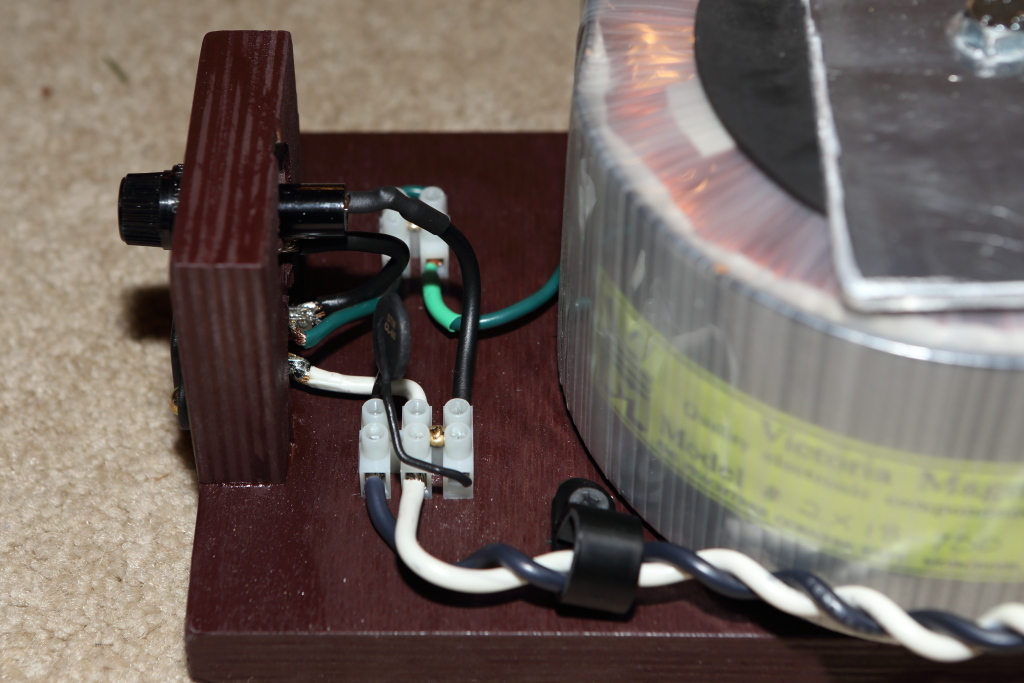

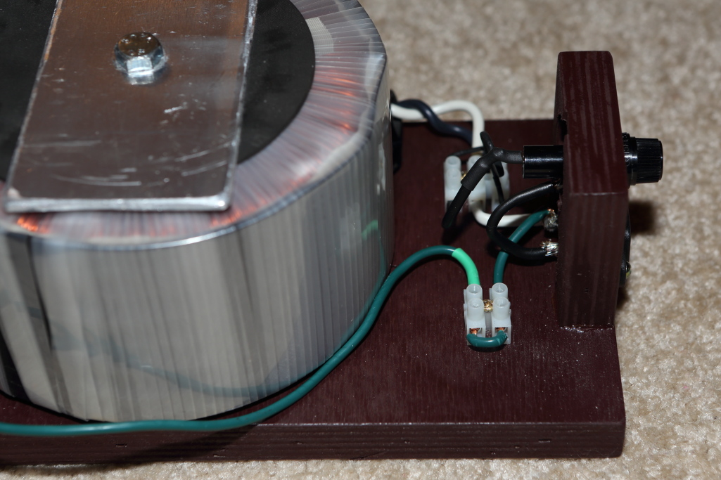

Here are some images and details for the external power supply.
AC in --> fuse --> CL-60 --> Rectifier boards --> Caps --> 2k Bleeder Resistors --> CRC Resistors (6x0R47) --> Power Umbilical
I made a jumper for the AC mains ground so I can lift it, direct connect it, put in a CL-60, or a diode bridge. No variation here makes a difference in the hum.

I think you'd be better off with a 4th wire in your umbilical for PE (protective earth). When you put the ground lift in your new jumper, you really want the heat-sinks grounded to the power cord side of the ground lift.
I also note that your input caps are large and inside a power loop (between -V and GND). You might be getting some inductive coupling there.
Jeff: I was wondering if the hum was a function of my extra large Russian PIO input caps. The cases are metal and have a large surface area. The next thing I was going to try was replacing these with more traditional (and smaller) film caps. I hadn't considered the impacts of "where" the sinks were grounded in this case... Might be better to keep them isolated from signal ground. This is easy enough to experiment with using jumper wires.
Dennis: I'll try two shorting plugs and see what happens then.

...you really want the heat-sinks grounded to the power cord side of the ground lift. I also note that your input caps are large and inside a power loop (between -V and GND). You might be getting some inductive coupling there.
I moved the heatsink ground from the PCB to the AC side of the PSU and changed my grounding jumper to a CL-60 so there would be some isolation of signal ground and AC mains ground. No difference in hum: dead silent with a single RCA input, but hum with both plugged in. I grounded both of the small rectifier sinks - no difference here either.
I also changed out the big Russian PIOs for some smaller caps. No difference in hum behavior.
When I use two RCA shorting plugs as Dennis suggested, the amp stays dead silent. This is identical to the behavior with only a single shorting plug connected. The hum still shows up when both RCA jacks are used and the other end is connected to my iPad.
Doing some other poking around, I found a strange behavior with my CRC power filter when I measured for AC ripple. The caps in my outboard PSU are 39,000uF caps followed by 27,000uF caps then the resistor array.
Before resistor bank in outboard CRC: 127mV negative rail, 9mV on positive rail
After resistor in outboard CRC: 31mV negative rail, 9mV on positive rail
On amp board inside of amp: 18mV negative rail, 9mV on positive rail
The negative rail is behaving as I would expect with decreasing ripple, but something strange seems to be going on with the positive rail because AC ripple is very low after the first cap and never changes... Not sure what this means, but I'll swap out the cap bank and see if I get anything different.
Going back to this, I'd say you have two different problems. The 1/8" jack only has a single ground, right? So the ground loop is formed when both RCA inputs are connected, whether the iPad is or not. Ergo the "very low level hum" is your ground loop.
The delta between "very low level hum" and "more pronounced hum" must be noise injected by the iPad (either on the signal lines or on the ground).
Try it with a different source and see what you get.
