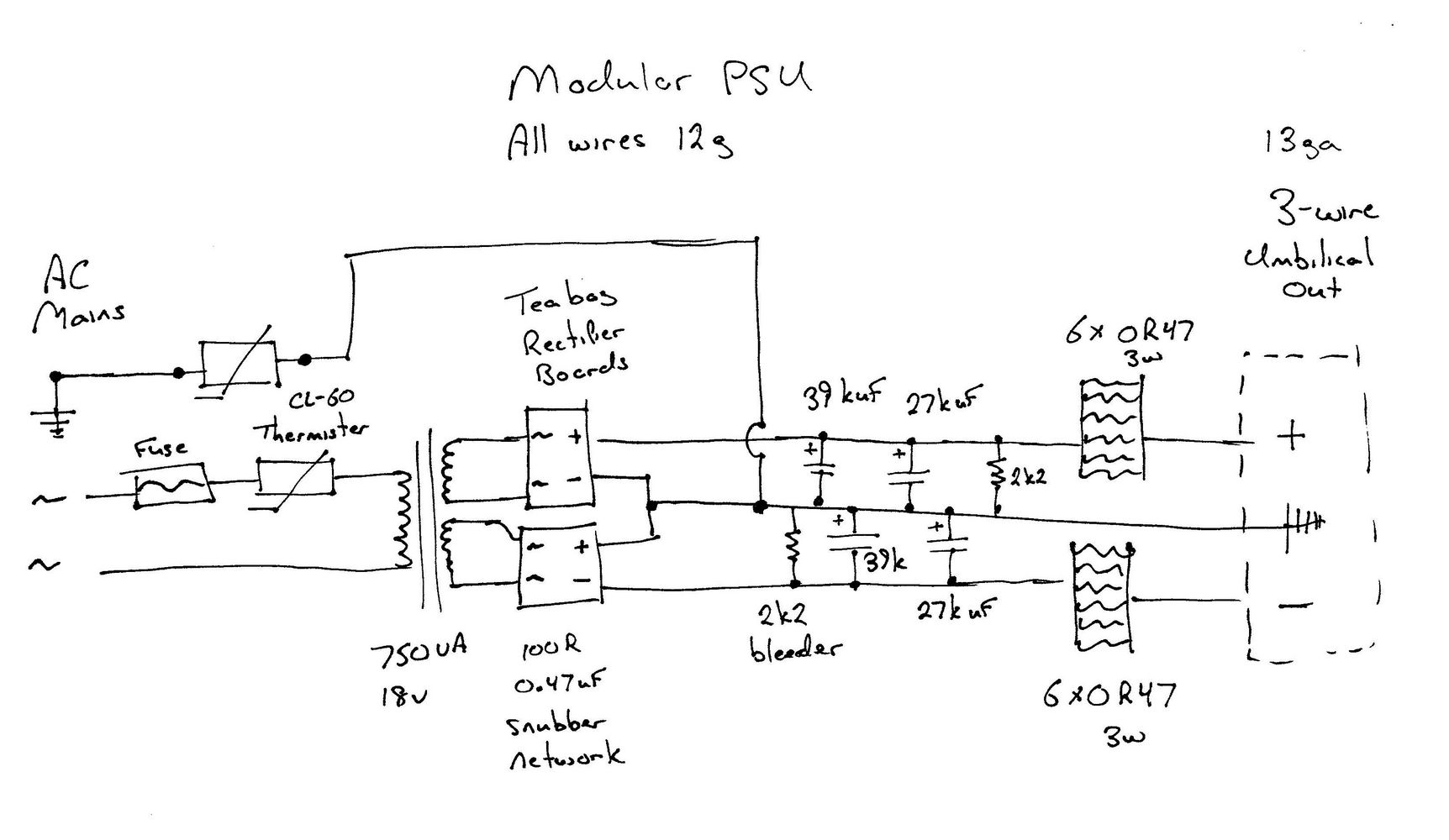

The next thing to try is star grounding, but I'm not sure that's possible given your PSU configuration... ? I'd need to see a few more photos of the rig wired up.
Here are two schematics of my present wiring: one for the modular PSU and the other for the Aleph-J chassis. It does not seem to make a difference if I add additional wires to ground the output sinks and/or the rectifier sinks to the AC Earth side of the grounding thermistor.
I am not yet convinced that my hum is an artifact of using a Y-cable or an iPad - this is how I have used my other amps: a40, ACA, F4, M2...

CL-60 on AC Hot leg = 11R cold, CL-60 on AC Ground = 13R cold. I measured with multiple meters, same reading all around. I also removed both CL-60s, straight connection to AC mains and straight connection to AC Earth. Same hum performance as before.
It also makes no difference if the main sinks are grounded to AC Earth or not. Same for rectifier sinks. It was interesting to connect my scope to the main sinks when they were not grounded: the sinks exhibit a ~1.0vAC sine wave with the music signal superimposed on the sine wave. The rectifier sinks also exhibit ~ 0.3vDC voltage rise when not grounded.
The hum is not very much, but clearly present with an ear up against the driver. It's practically gone with a distance over 1-2 feet. When one RCA is unplugged, the speaker is dead silent.
I'm getting tired of trying things here... maybe time to leave it alone for a while.
