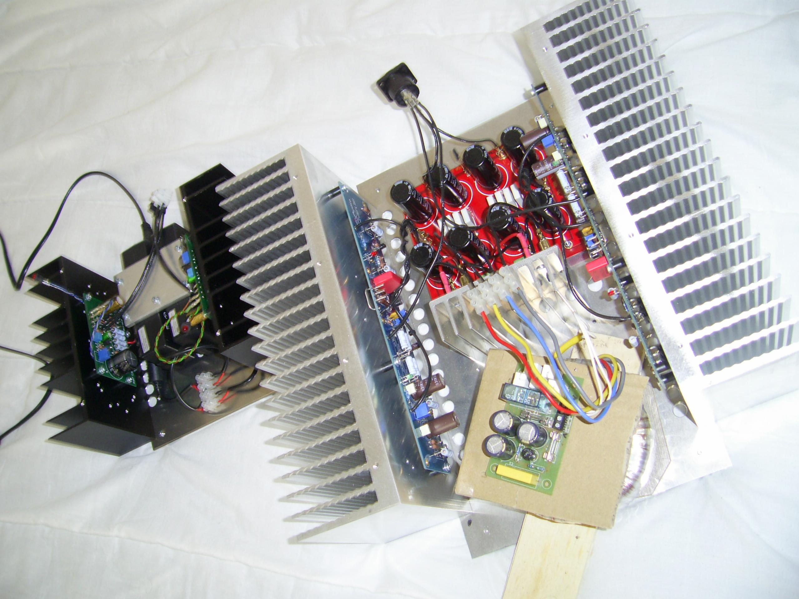

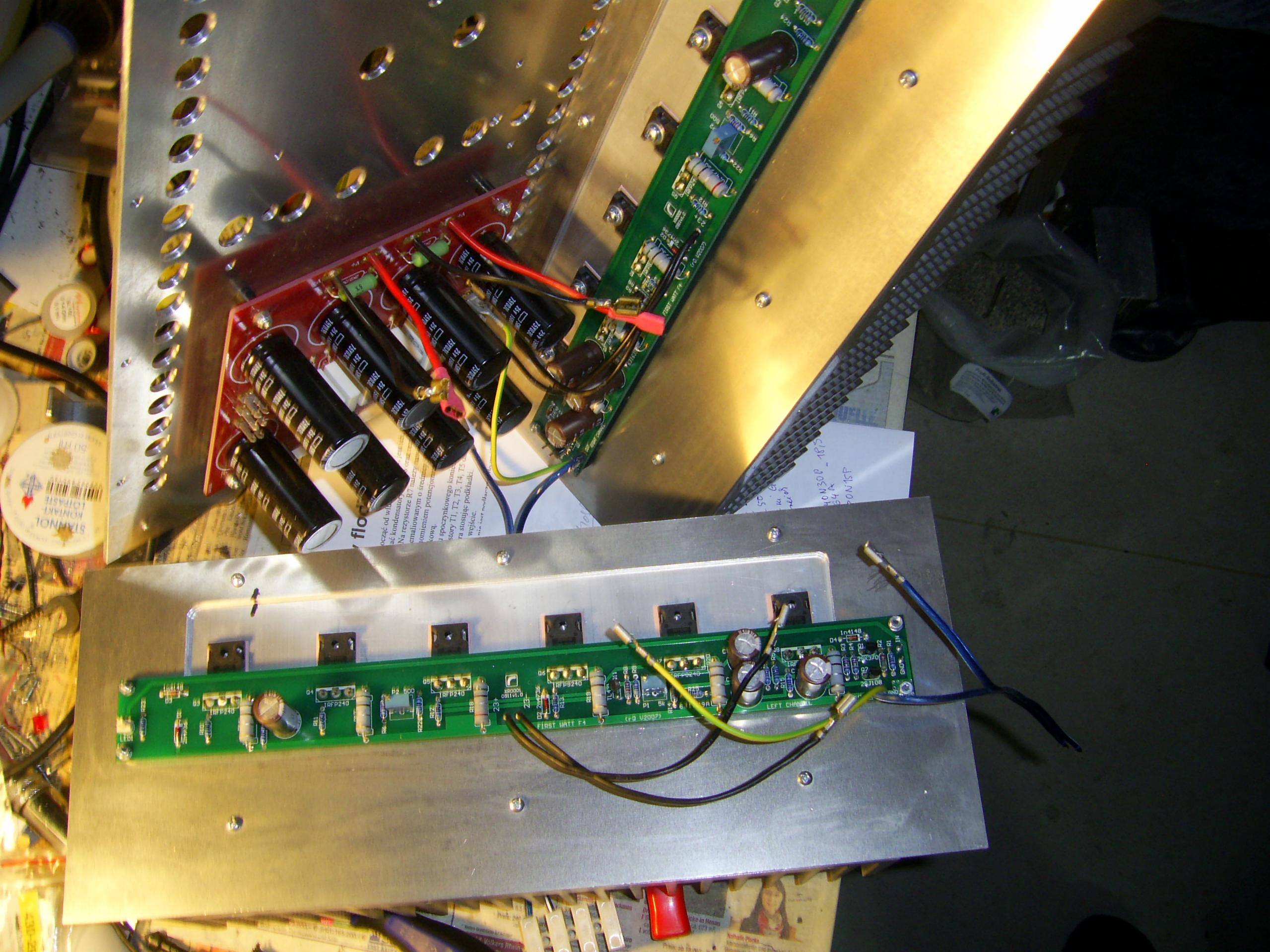

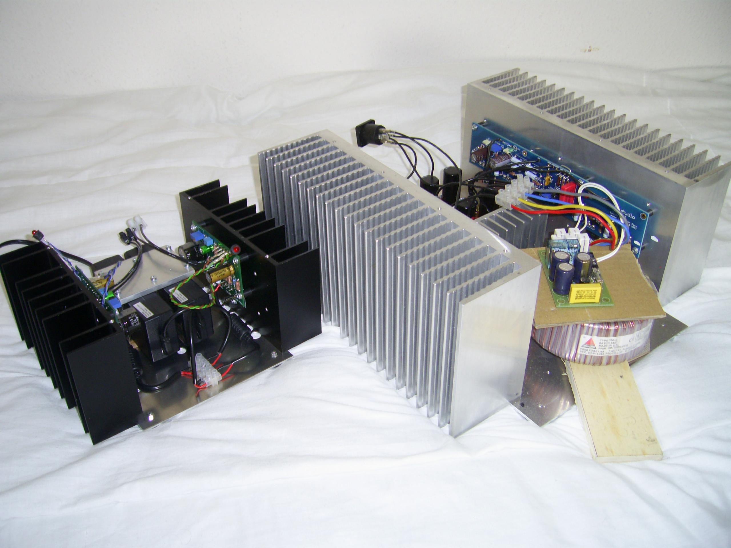

Aleph J with IRFP250 M
Hallo Friends.
First Thank is going to Mr. Pass and second to 6L6 for all great illustration build.
I now also can enjoy the Aleph J and understand the different Aleph a bit more
better.
First i have pull out the F4 for refitting with better cooling.
The Fischer Heat Sink allows the J to work with 340mV not to hot day long.
JFet Input are in 10mA range. The IRFP250 M is the modern 5. generation
HexFet with a bit lower Cob- i don't know if it can better anything in sound,
but they work fine and are stronger 30A.
I use a 10k Pot to input also in ACA, Aleph M.
From first start after setup carefully bias point i was impressed by the fullbodied
tonality- somehow a bit like pentode with more Raffinesse.
The clearness and transparency is non fatigue your ears you can follow light the
fluide music presentation- don't know better to tell it.
I have only done two shoots from my build comparing to ACA with R15 mod.
The Amp is closed in Heart- i like, but must wait to colder winter evening now.
Thank you here to ALL have proportion that we can enjoy this Amp.
Now i am waiting for TeaBag M2 GB Boards- another Genius Stroke! :D
:cheers: Bangla.
