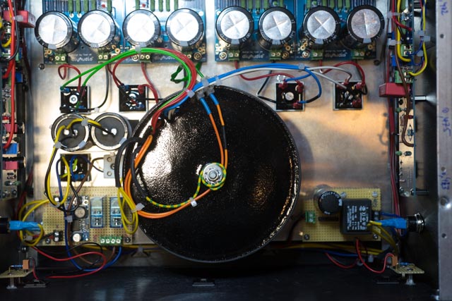

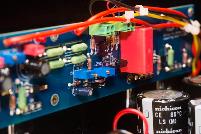

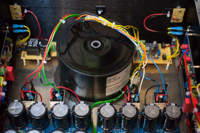

Pictures of Aleph J just finished

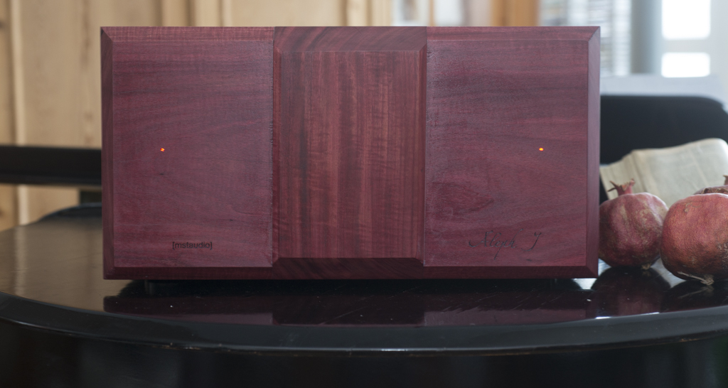

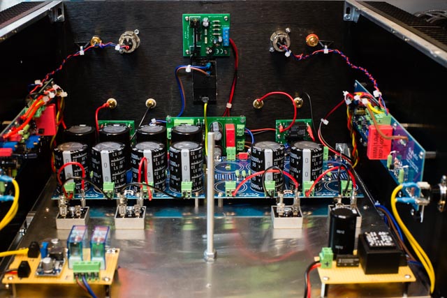

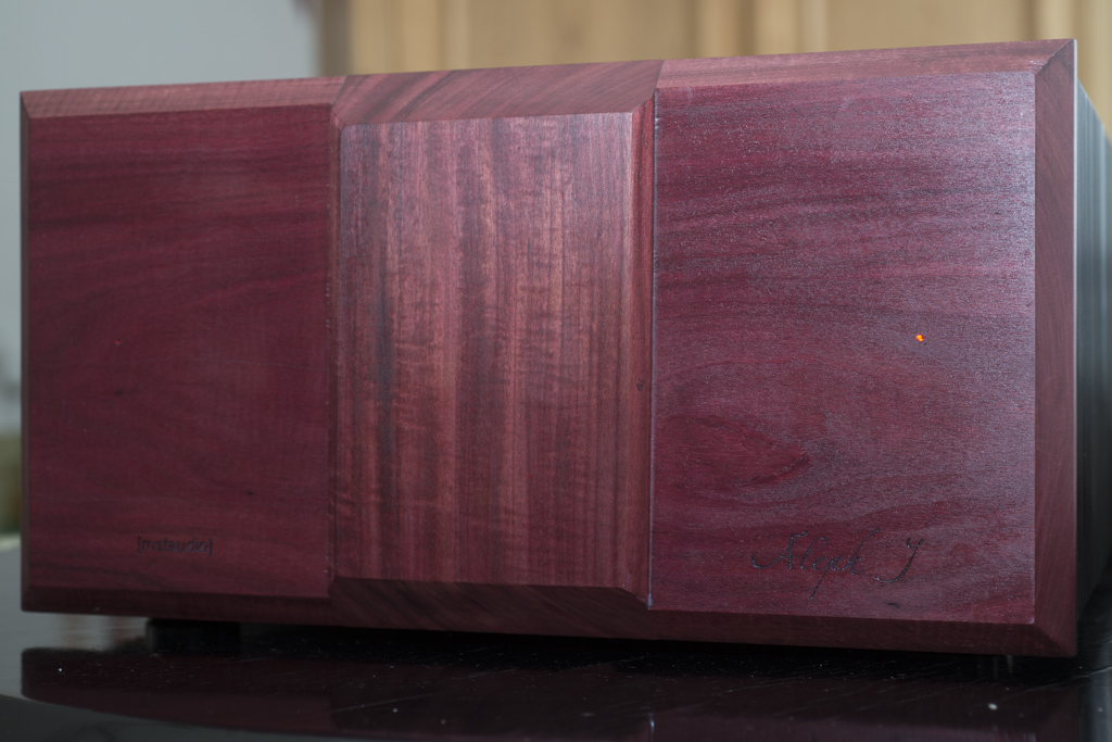

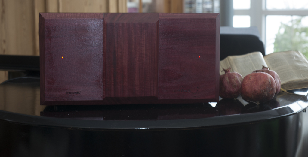

...as pronounced some pictures of my finished Aleph J.
I like the sound!!!!, the layout!, and the design....

Thanks for congratulations 6L6!

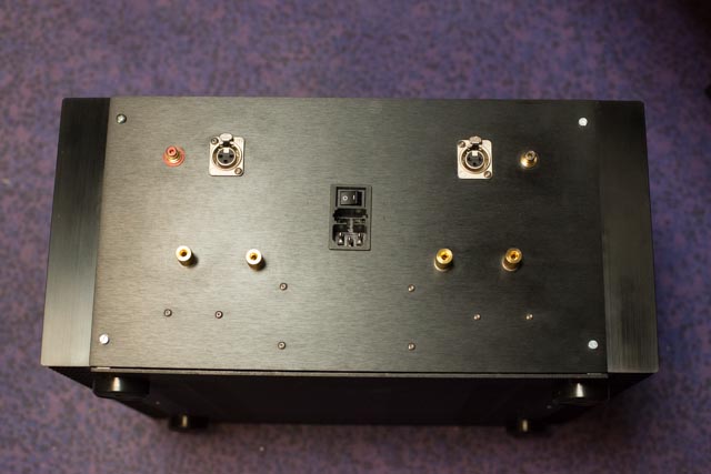

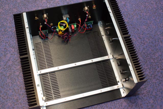

I had a lot of fun planning and constructing the mechanical part and complete electrical components.
A big "thank you" to 6L6 for YOUR illustrating building up Aleph J!!!🙂🙂 Often I used your pictures and comments!
And you are right:
the sound is great and much better I ever listened to commercial (expensive) amps.
The loudspeakers are Quad ESL 57.
