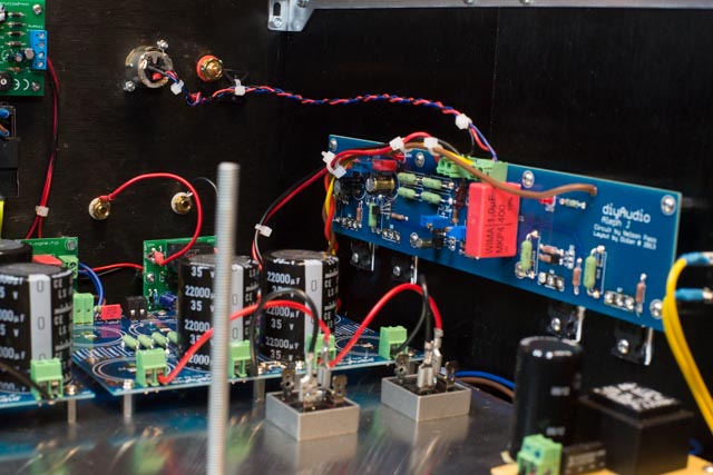

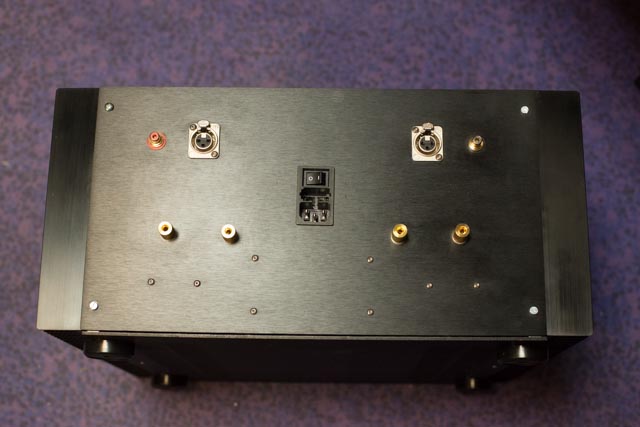

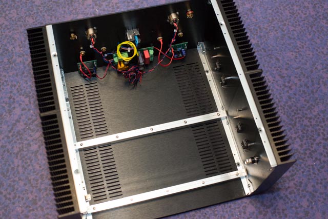

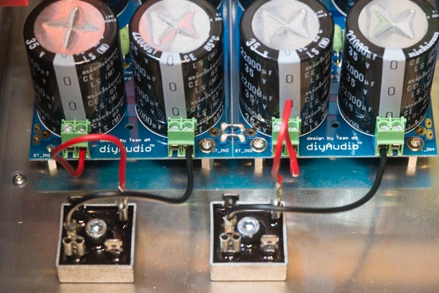

....well I try it, althoug the project is not completly finished. The definitive tyroideal transformer will reach next monday, the front will be wood, .....
But pictures show a lot of details (heating switch, loudspeaker protection and startup on back, power supply 32V for loudspeaker protect and relais construction in front,).
The transformer is a special one (4 x 19,5V - 6,5A / 24V 0,5A) from Rondo Müller Germany.
If heatsink would be higher than 70 degree, the power supply of transformer is switched off, unless temperature is lower 65 degree. Thats the reason I used 2 relais in front - they shorten or cut off powersupply. And the heating switch only switches 12V - not complete 230V.
Finishing next week I will post a few pictures more.
