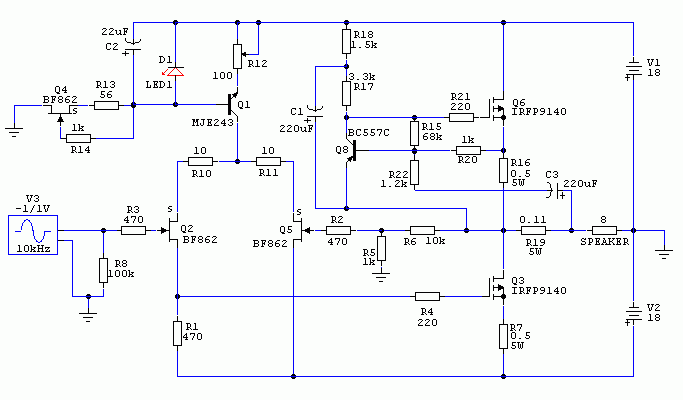

Hi Nic,
Found this in my hard drive, it might be what you have found..
It is a mini-aleph using N-jfet and P-mos output.
Have fun!!
Firstly, it's going to get hotter. Watts is V x A, so increasing V will make more watts, an in the example of this amp, that's all going to be more heat in the heatsinks that needs to be dissipated.
Also you'll need bigger V rated capacitors, and at a certain point you'll burn up the Jfets.

I have a 4U 400mm Dissipante chassis with stout dual mono +18v/-18v rails, and want to try it with a low voltage Aleph J build.
I have very efficient speakers and am not worried about maximum power output, but rather, how to get potentially the best sound out of the lower rail voltage.
Is it best to use all 4 output mosfets, or drop to one pair of outputs, ala Mini Aleph-J?
