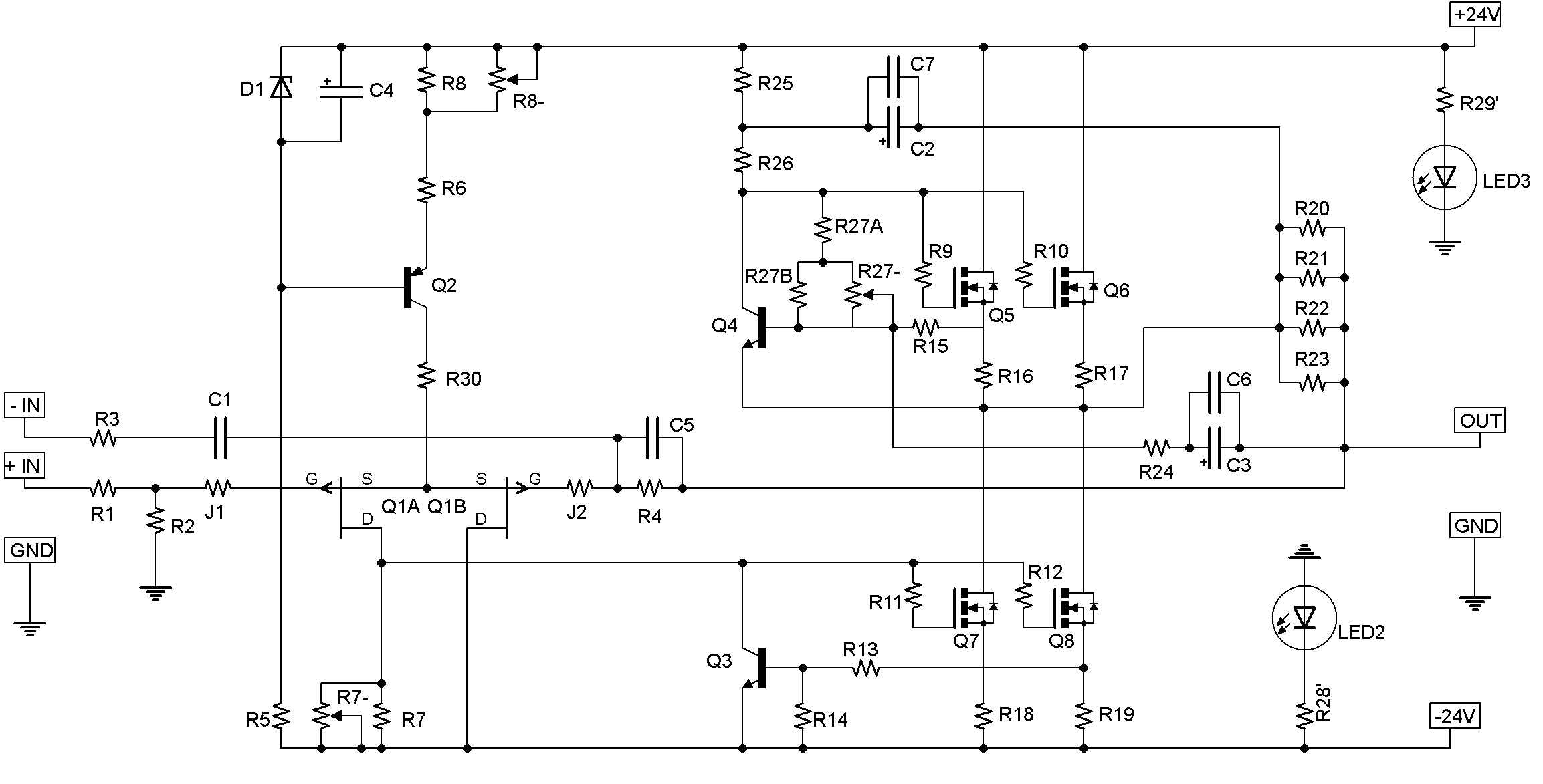

Sorry for my stupidity, when reading your Babelfish J thread, I see likely two .27R 3w resistors as output resistors if a single vertical pair of IRF120 with .27R source resistors are used.
Here is the schematic I will be following, it is the one from the most recent DIYstore Aleph J boards.
whatever you do , R16,7,18,19,20,21,22,23 ...... are all of same value
of course that last group (sense group on output ) can be made of different number of resistors with different value (say , to have just 2pcs , not zillion ) , but group value must stay the same
practically - as many source resistors you have in output (counting up and down) , same number is in sense group

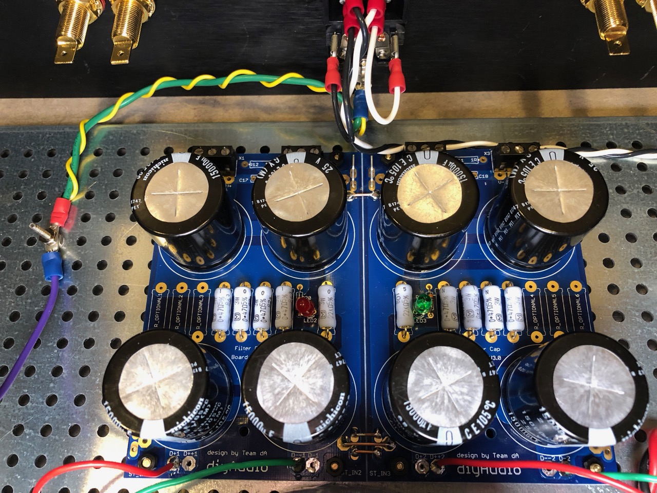

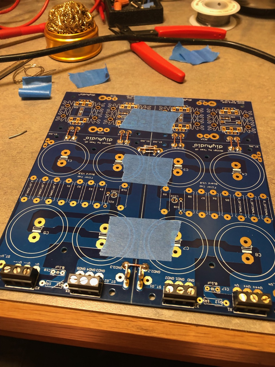

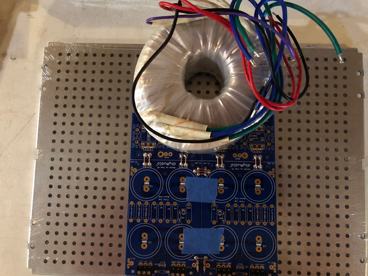

My PSU boards (from 6L6) were split, so I started by completing the attachment points for these and to the diode boards (more on this later).
Realized, via 6L6 again, that PSU will probably need to have diode boards split off to fit the Deluxe 4U chassis.
Parts for the PSU sorted and each tested.

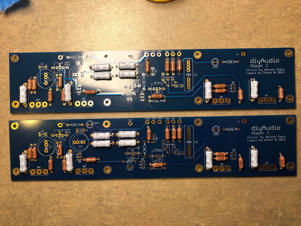

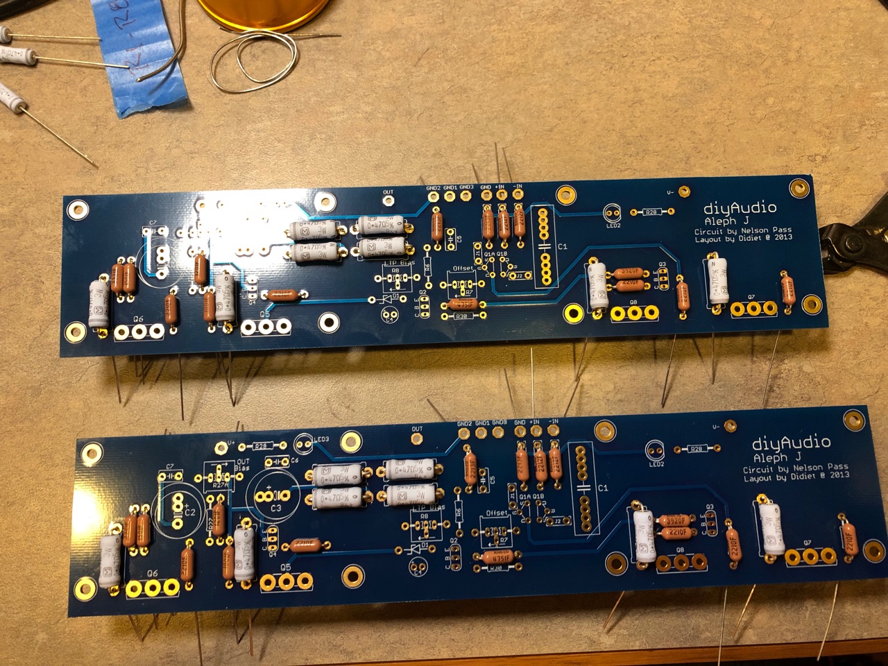

AJ board stuffed with resistors.
Capacitors

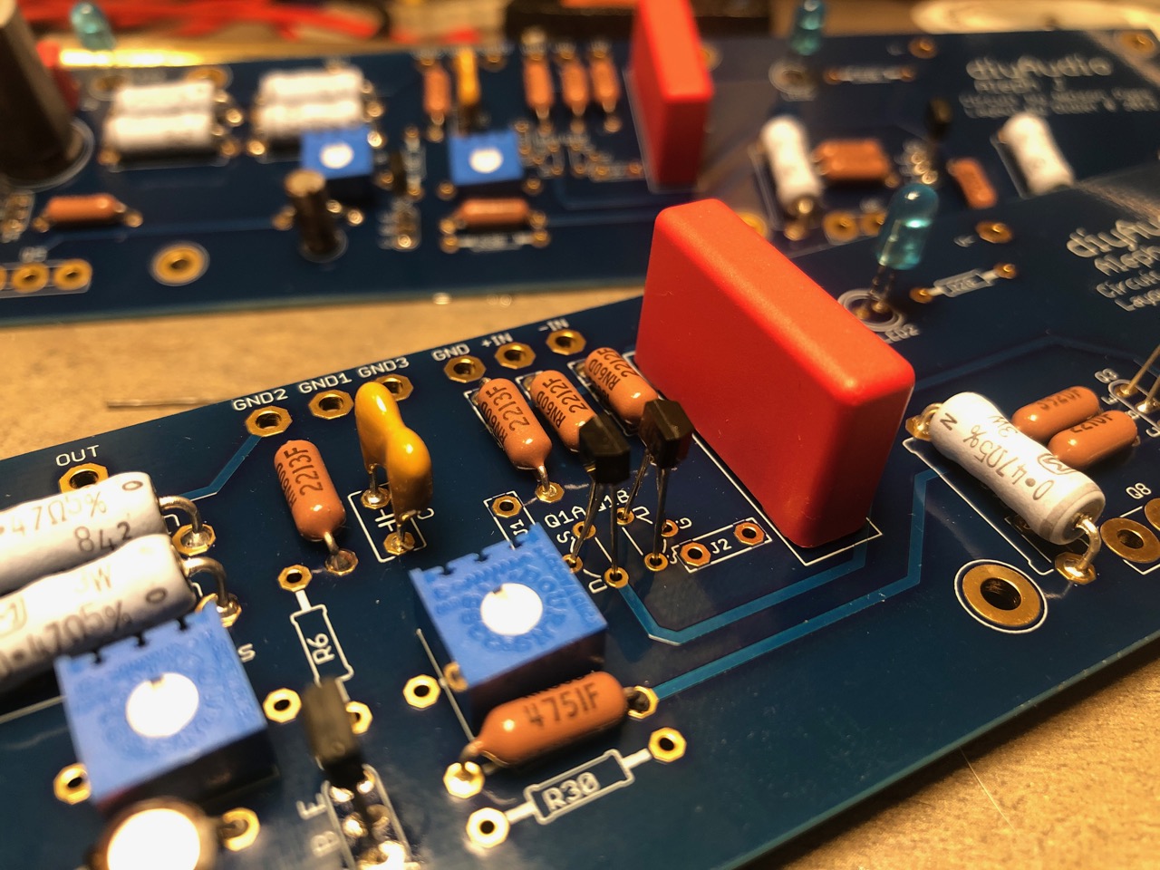

JFET's in (I have one board's Q2 reversed, still have to fix that!)
Completed AJ boards (minus the MOSFET's and still with one reversed Q2)

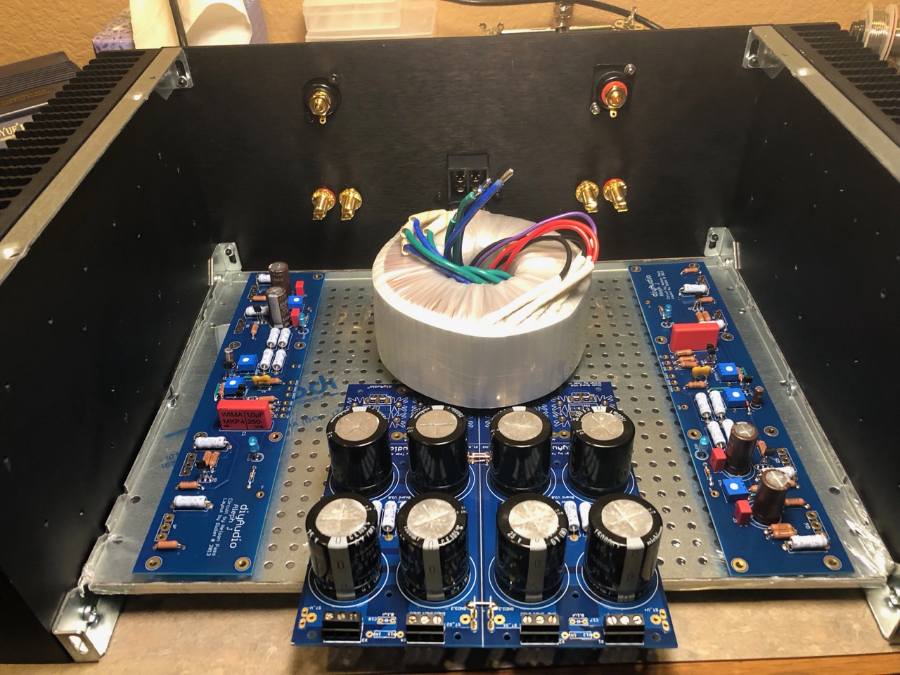

About ready to start some assembly.
I know I still have a long way to go, but want to post progress.
Thanks to all the contributors to this thread (yes, I read the whole thing over the last month), to the diyaudio store crew, to NP for sharing this design and details, and especially to 6L6 who continues to guide me in this build and lead me into Class A enlightenment.

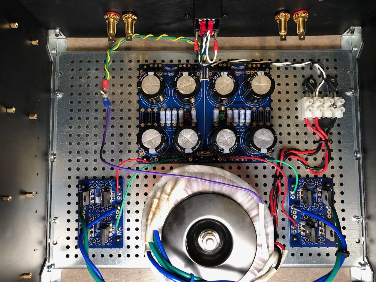

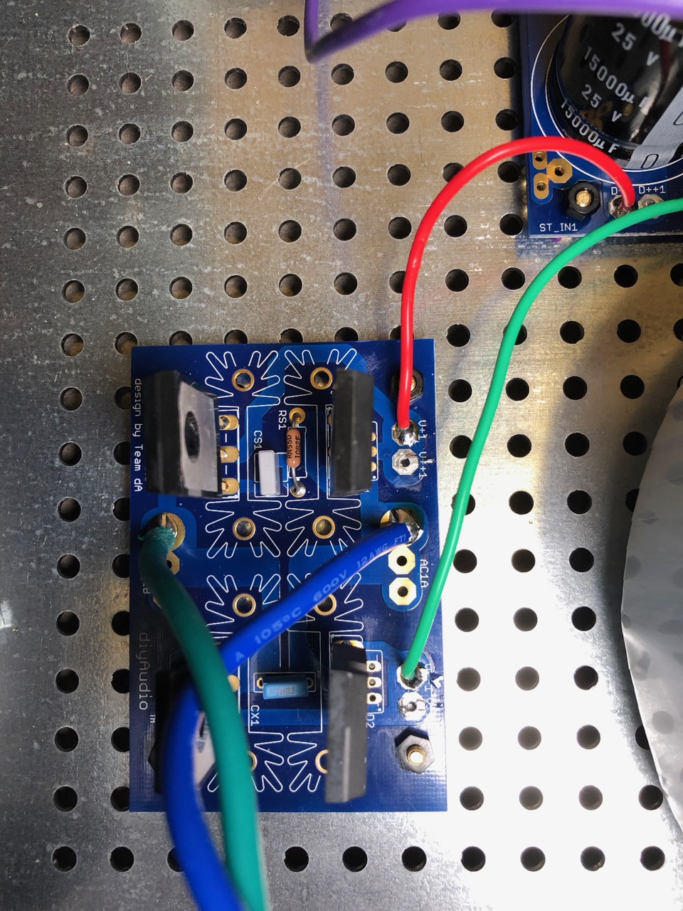

Following up on progress to post #757 above...

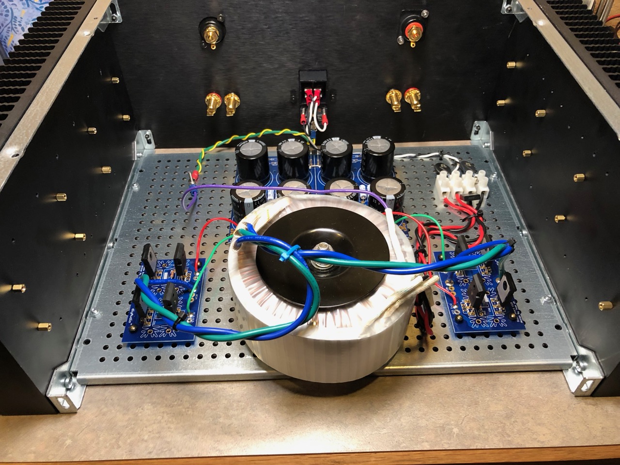

Spent 6 hrs at Jim's house today working at his bench with expert guidance. He is SO patient!

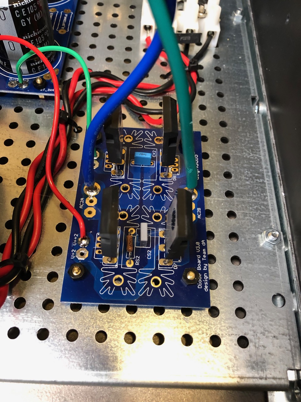

He showed me how to use his desoldering gun and split off the diode boards.

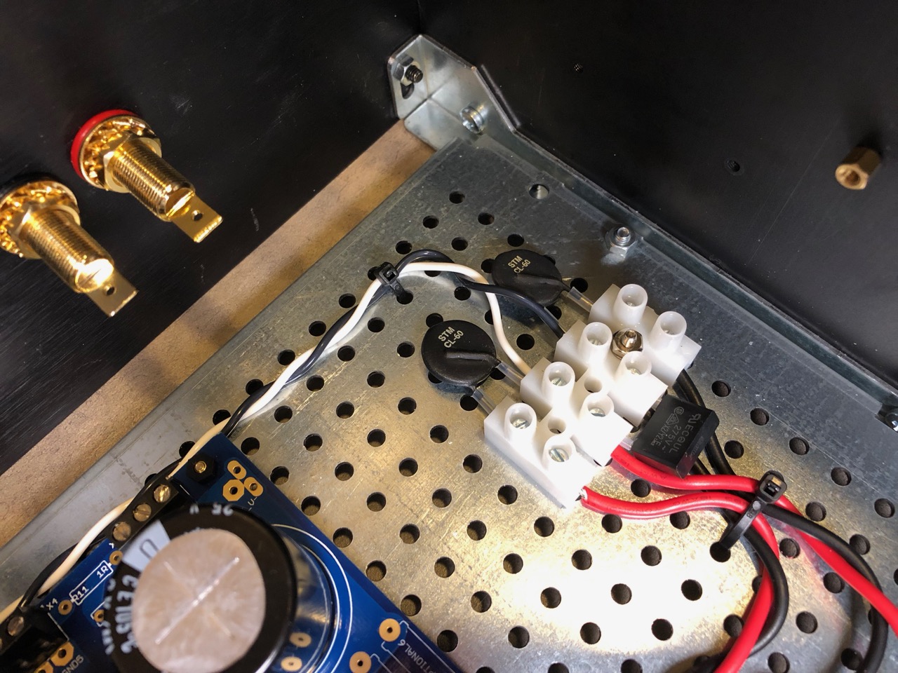

Once split, we then used this excellent and amazing test jig called Quasimodo to measure for the transformer snubber components (RS1, CS2, and CX2 on the diyAudio UPS v3 PCB). All I know is that replaces some advanced mathematics that I did not understand in the least. Jim also made a quick call to Mark Johnson, designer of the above test-jig, to confirm a few details about our testing.
Jim pointed out a few soldering touch ups on the AJ boards which we fixed. I finished up some soldering on the PSU's and then got to work on layout and mounting.
Wiring up the PSU followed. Once all internal connections were made, a light bulb tester connected it to mains voltage. With a cardboard box protecting us from possible fireworks, I flipped the power switch. The bulb, as desired, lit briefly and then dimmed. No blue smoke or burning odors were detected. Rails measured -25/+25 V DC as hoped. Success with the power supply!!
It was a great day with great company and some nice jazz quartet standards streaming through paired ACA's. Here are some build photos for now because it will be a couple of weeks before I get more time with this project.
